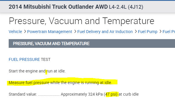

My car failed inspection for error code P2096. I had the exhaust repaired, muffler changed, no vacuum leaks, O2 sensors replaced (with Mitsubishi parts), and threw Cataclean in there. Check engine light turns off when I fill up on gas, back on at half tank. Code is always stored in the permanent memory. Acceleration has been sluggish, but the car runs well. 3 mechanics told me catalytic converter looks fine and exhaust reading in range. What else could be causing this? I'm about ready to trade my car in it's so frustrating.

I'm not sure which engine you have. So, I'm looking at information related to a 2.4L.
As far as the code is concerned, it indicates a lean fuel mixture. Have you checked fuel pressure when the fuel level is below 1/2 tank? Also, how did you check for a vacuum leak? Here is a link that explains how it's done. Let me know if this is what was performed.
Also, if you haven't checked fuel pressure, I recommend doing it. Here is a link that explains how it's done:

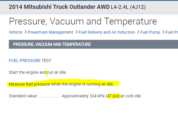

Note: A lean fuel mixture code isn't indicative of a failing oxygen sensor. Usually, it is a vacuum leak or low fuel pressure. I attached the manufacturer's fuel pressure specifications below for you.
One other thought. If you have access to a live data scan tool, let me know what the short-term fuel trims are. Also, confirm the engine size for me.
See pic below .

I'm following up. Thank you for replying! I intended to change the fuel pressure regulator. Got the air filter done + a missing clip on the filter box, serpentine belt, battery replaced. Check engine light went away after that, so one of them must have been causing the issue. Thanks again!
