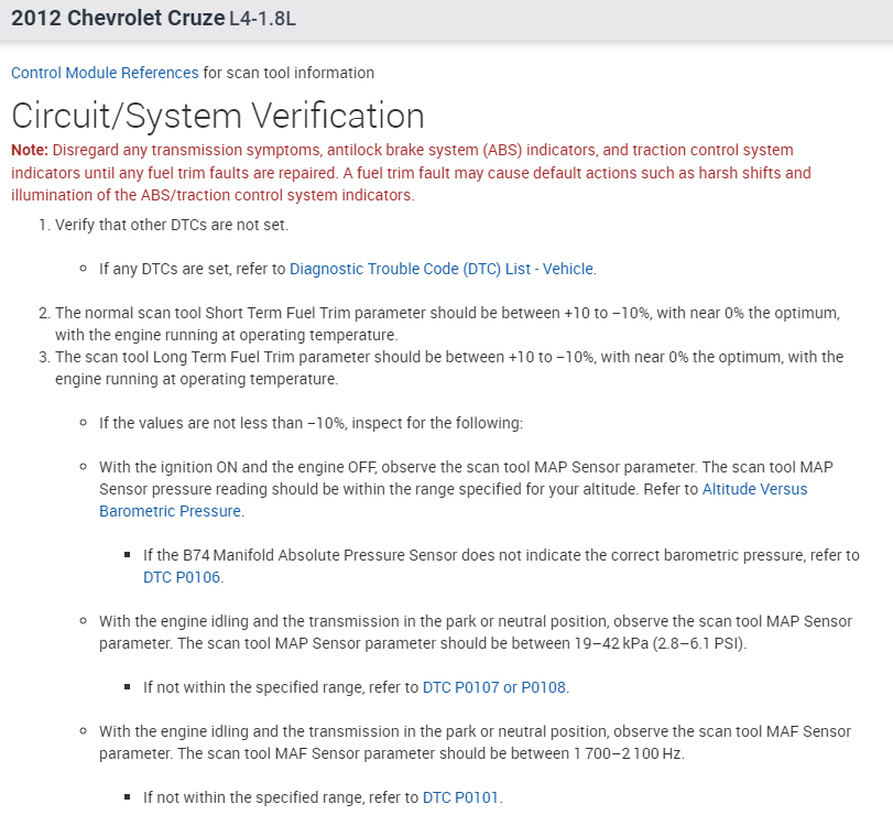

P2096 error code.
Dec 5, 2021 at 6:57 PM
SQM
  • 6,383 POSTS

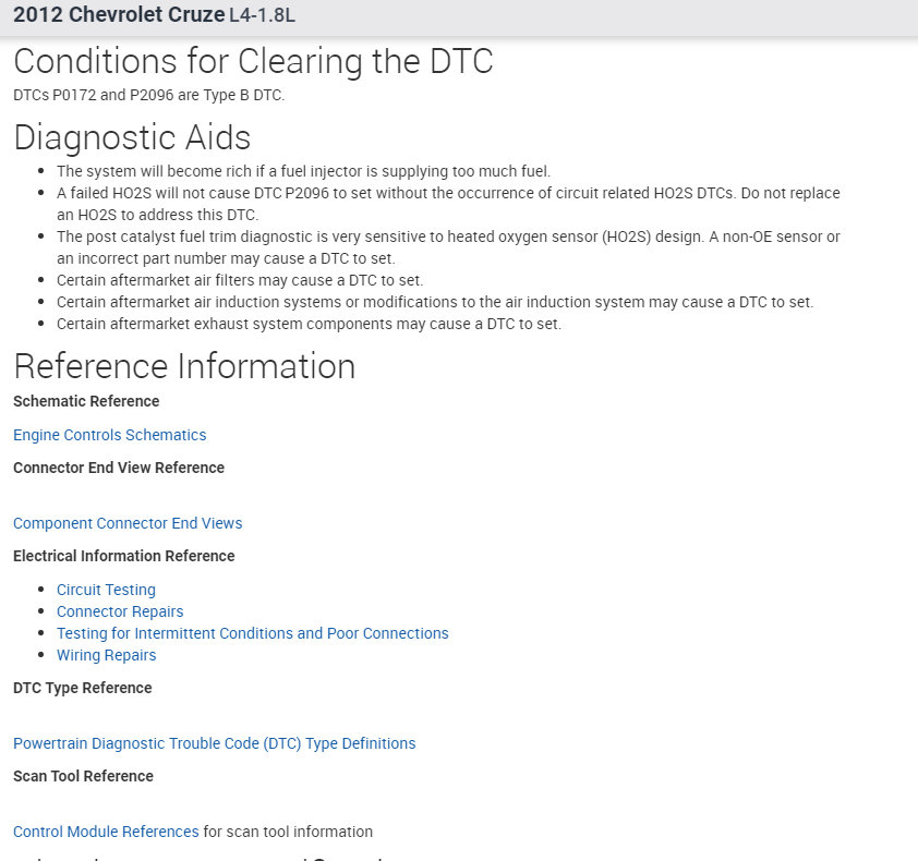

You have listed the vehicle with a 1.6L however on that year the Cruze (in the US) had 1.4L or 1.8L engine.

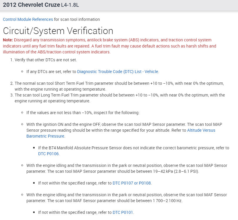

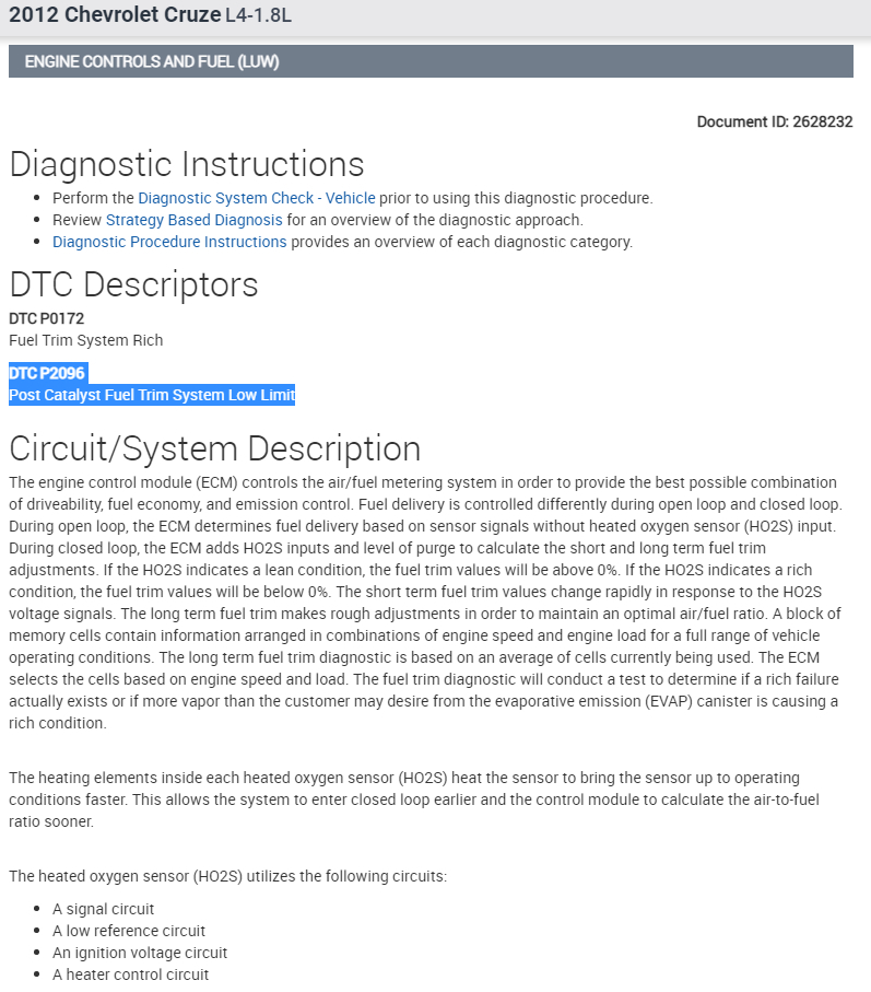

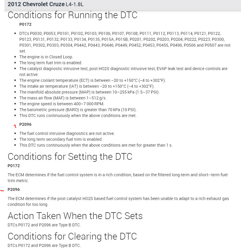

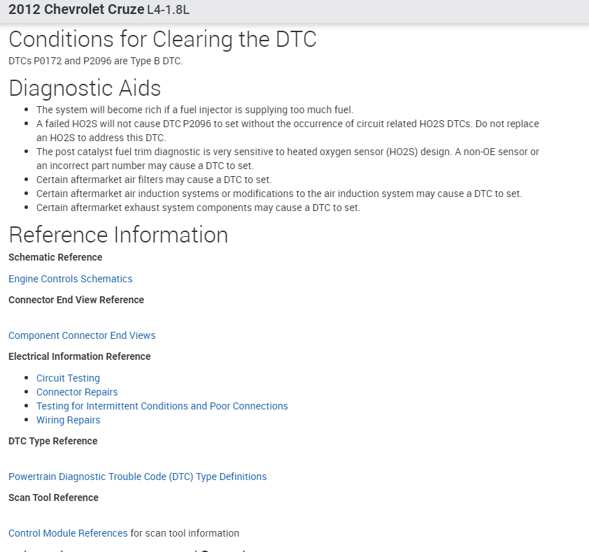

The code P2096: Post Catalyst Fuel Trim System Low Limit

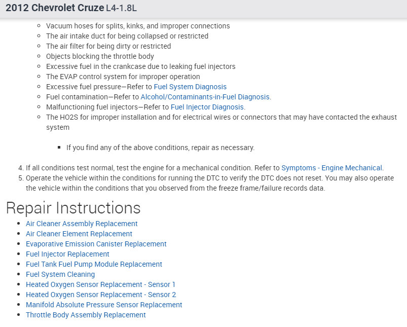

This can be triggered due to a number of reasons. Could be simple a restricted air intake duct, dirty throttle body. It can also be due to excessive fuel pressure.

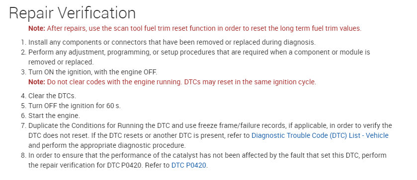

I have attached the trouble shooting steps for the code below.
Follow those steps as it can help you determine the issue.
