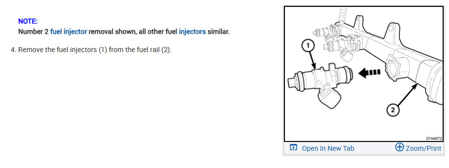

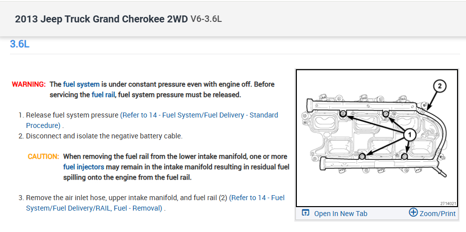

Codes P206 and p306?
2013 JEEP GRAND CHEROKEE
189,000 MILES • V6 • 2WD • AUTOMATIC
BHAMDOC1973
  • 2,007 POSTS
Does that usually indicate an injector issue?
Nov 23, 2024 at 11:17 AM
  • 110,194 POSTS
Since the two are specific to cylinder 6, yes, there is a good chance it is a faulty injector. However, it could be a wiring or connector issue as well.
Do you have a constant misfire? If it is intermittent, try using a quality fuel injector cleaner in the fuel to see if that helps.
If that doesn't resolve the issue, then the injector itself needs to be checked. Here is a link that explains how to test an injector:
https://www.2carpros.com/articles/how-to-test-a-fuel-injector

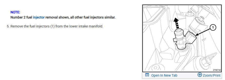

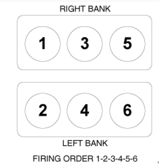

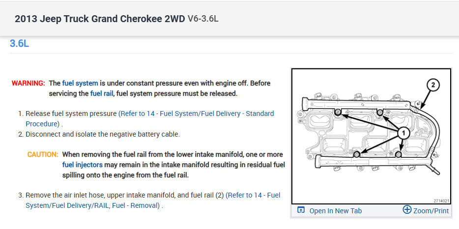

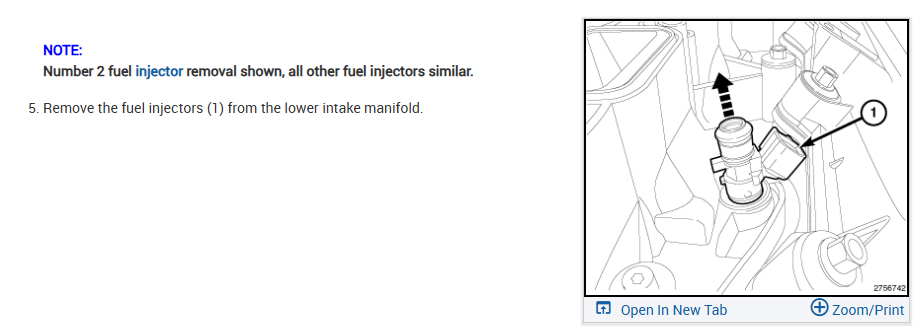

If you look below, pic 1 shows the cylinder orientation on this engine. The remaining pics are for removing fuel injectors.
In this case, the upper intake manifold needs removed to access the number 6 injector.
Let me know if this helps.

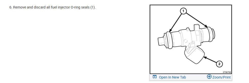

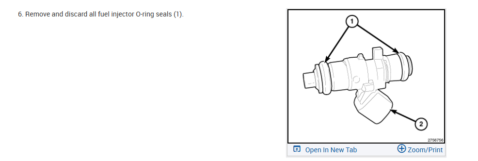

See pics below. Note: Make sure to replace the o-rings on each injector and lubricate them with something like Vaseline before reinstalling them.
Nov 23, 2024 at 9:25 PM
