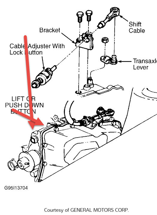

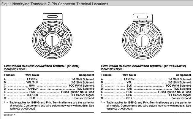

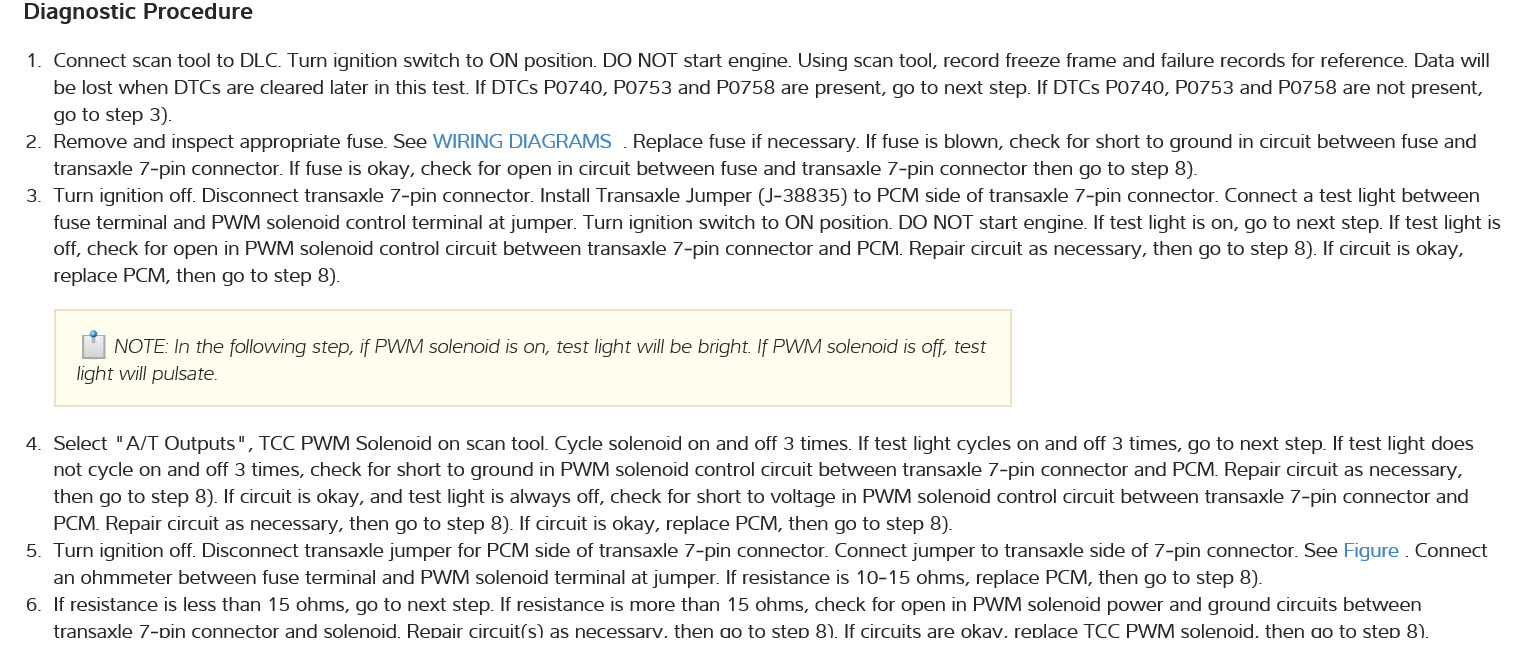

majority of people willnot attempt this. see pics.
Jan 25, 2016 at 12:10 AM
XJSHEN
  • 251 POSTS
Great and thanks!
Dwhere is the 7-pin con-terminal located on the car? I'll check them following the manual.
Jan 25, 2016 at 1:09 AM
HMAC300
  • 48,601 POSTS
at the transmission
Jan 25, 2016 at 1:25 AM
XJSHEN
  • 251 POSTS
Do I need open the transmission box?
Jan 25, 2016 at 5:30 AM
HMAC300
  • 48,601 POSTS
wiring plug will be in area where arrows are showing. I have no further comments or suggestions

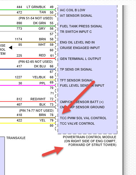

Where is PCM C2 connector location location on the car? Where is p1860 code related circuits included: circuit no. 418, pin 78 (BRN), TCC PWM Solenoid Control; circuit no. 657, pin 63 (YEL ) TCC Release Switch Signal.
May you share DTC P1860 TCC PWM Solenoid Circuit Electrical 3.1L diagram?
Thanks!
Jan 25, 2016 at 11:55 PM
HMAC300
  • 48,601 POSTS
the pcm has two connectors just look for the the numbers as they are on the connector. it'son the front right strut tower I have nothing more to give you.
