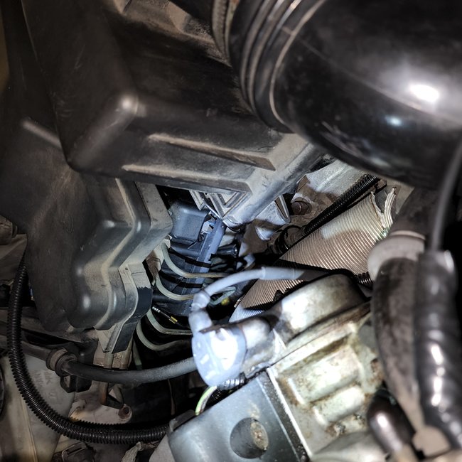

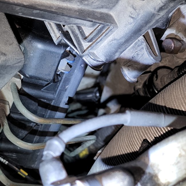

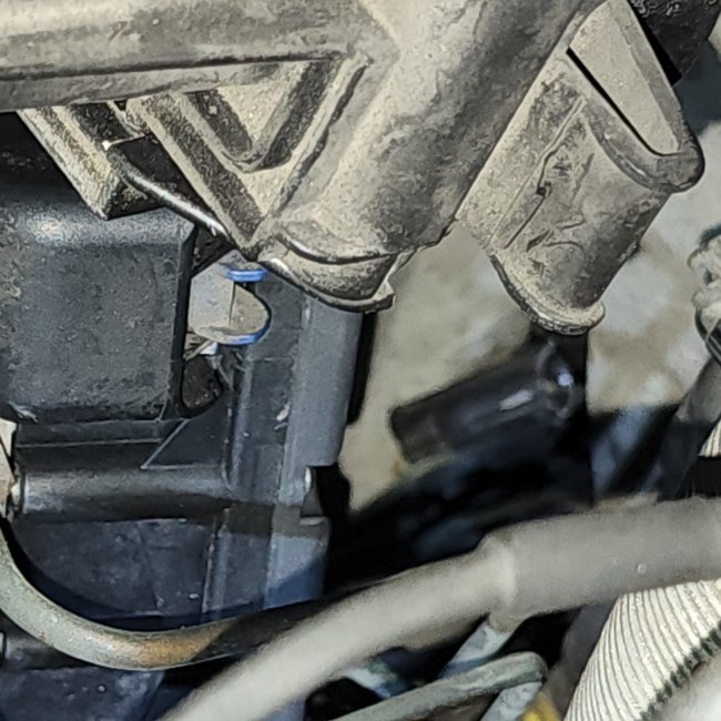

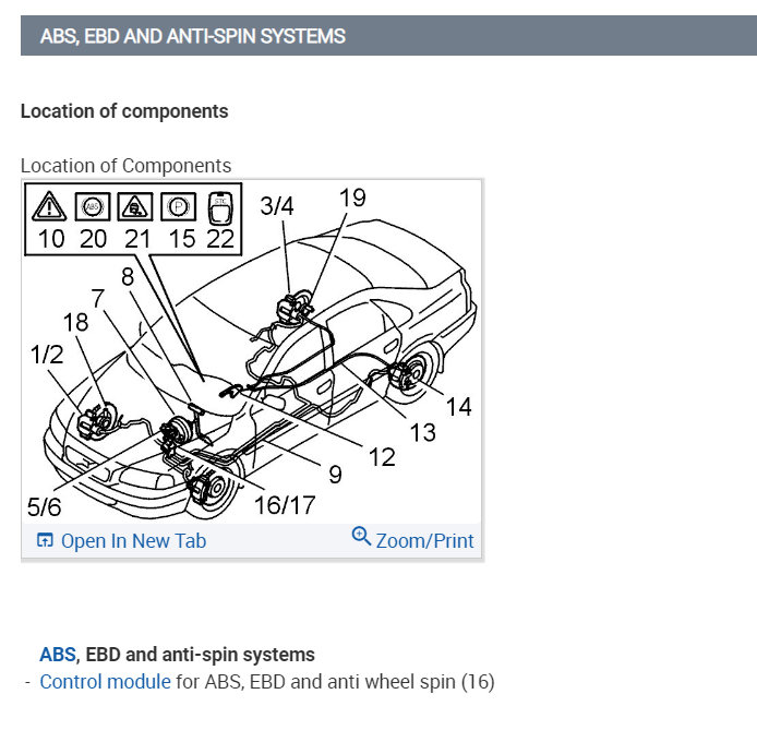

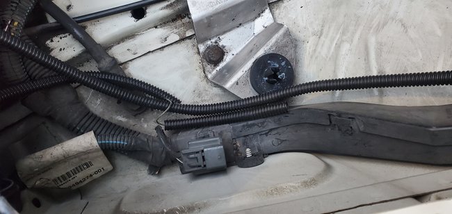

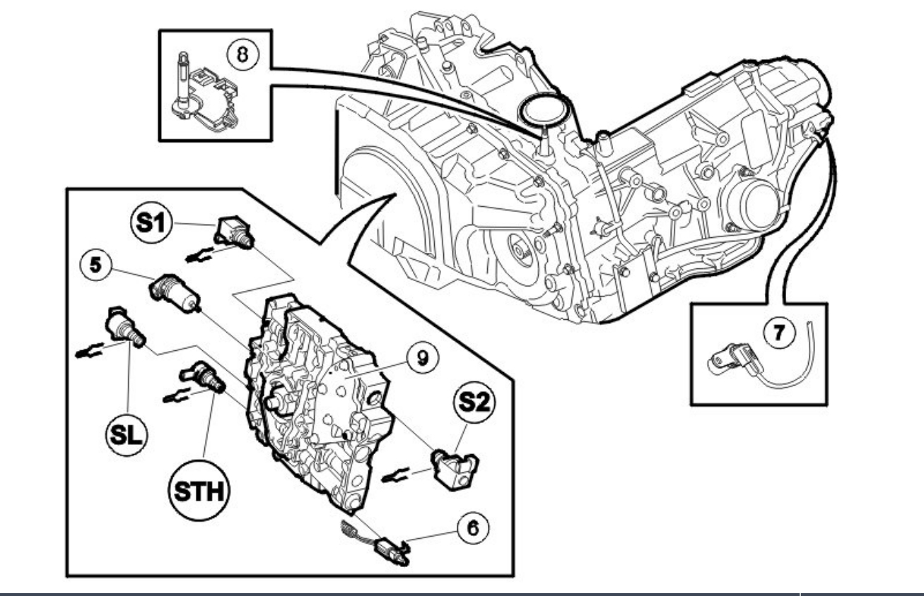

I have had this same problem for 3 years now, I'm trying to get the car to pass the Smog test but this one code won't allow me to. I've replaced the voltage regulator, replaced ally ABS wheel speed sensors and replaced the ABS control module twice but it won't go away, but something I've noticed is this loose connection hanging out, does this have something to do with it?
Jul 26, 2022 at 2:01 PM
  • 55,433 POSTS

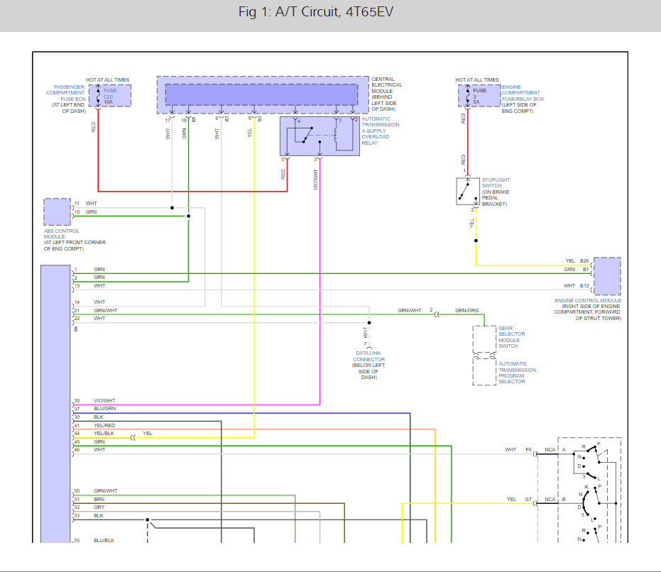

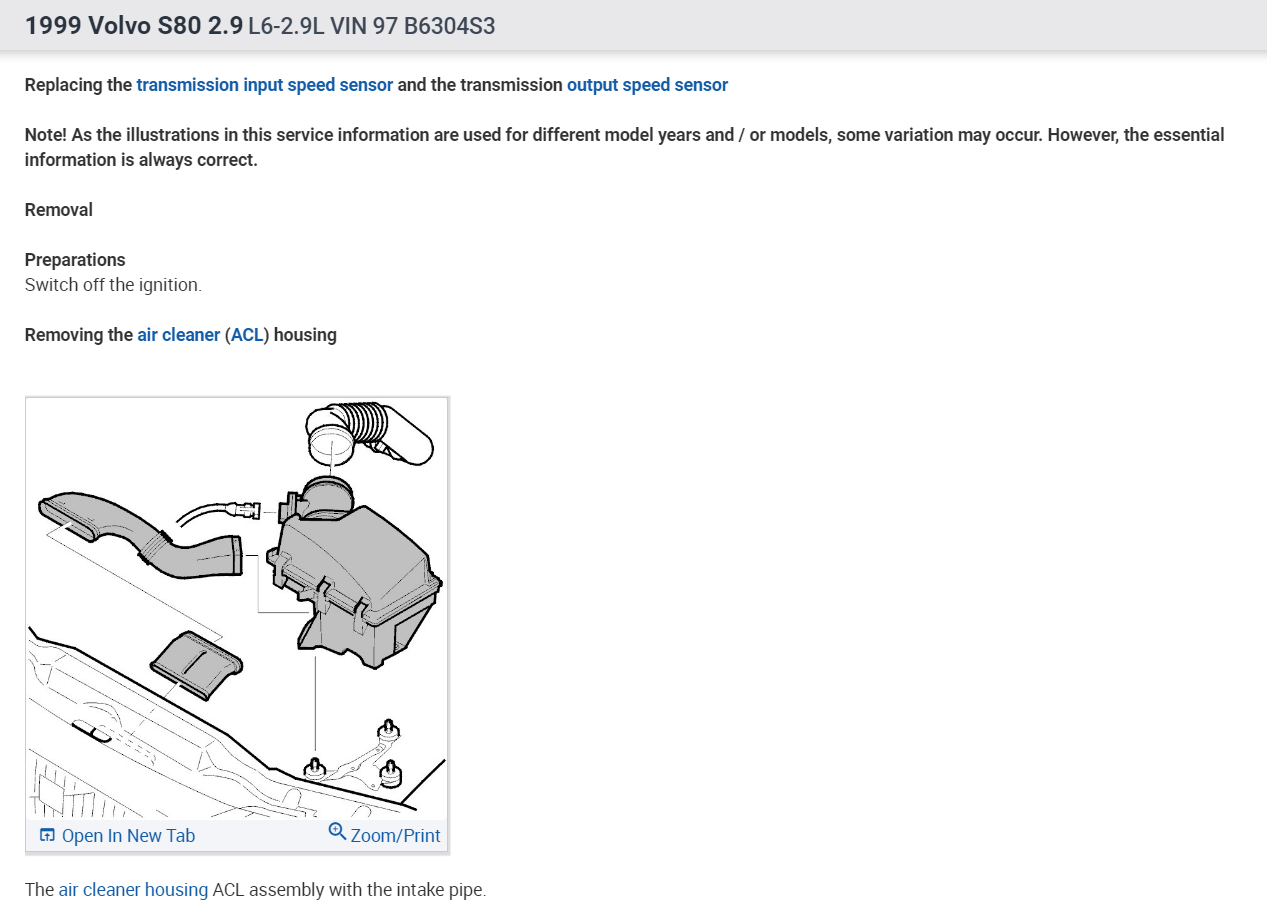

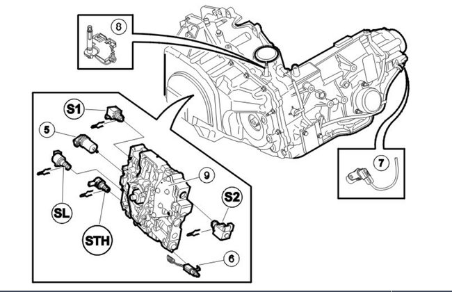

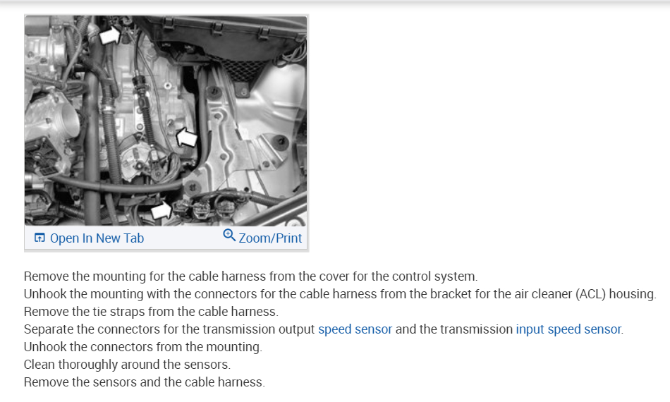

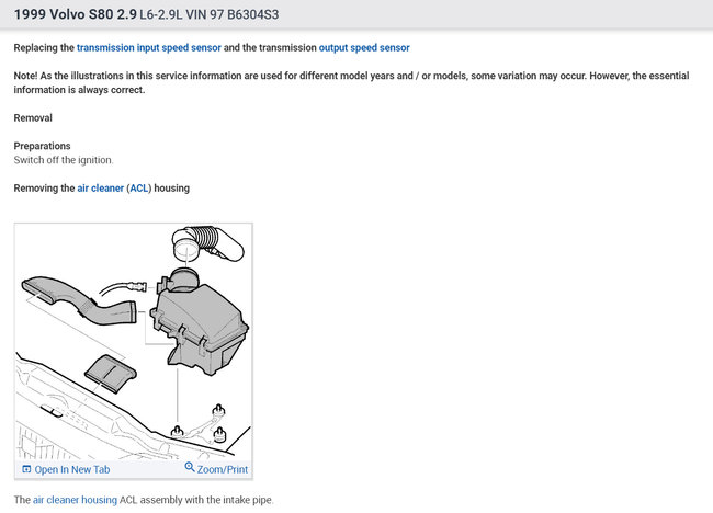

The images look normal. Thanks for uploading, P1633 code is a fault in the vehicle speed signal from the VSS, I would see if the sensor is plugged in. Also, does the speedometer work? Here is the sensor location so you can check it out and see what's going on #7. Check out the diagrams (below). Please let us know what happens.
Jul 27, 2022 at 3:45 AM
KAVIN THOMPSON
  • 19 POSTS
No, the Speedometer is frozen and thank you I had a hard time finding this location. nobody would tell me where it's located, Ken, I'm going to open it tomorrow and tell you how it goes.

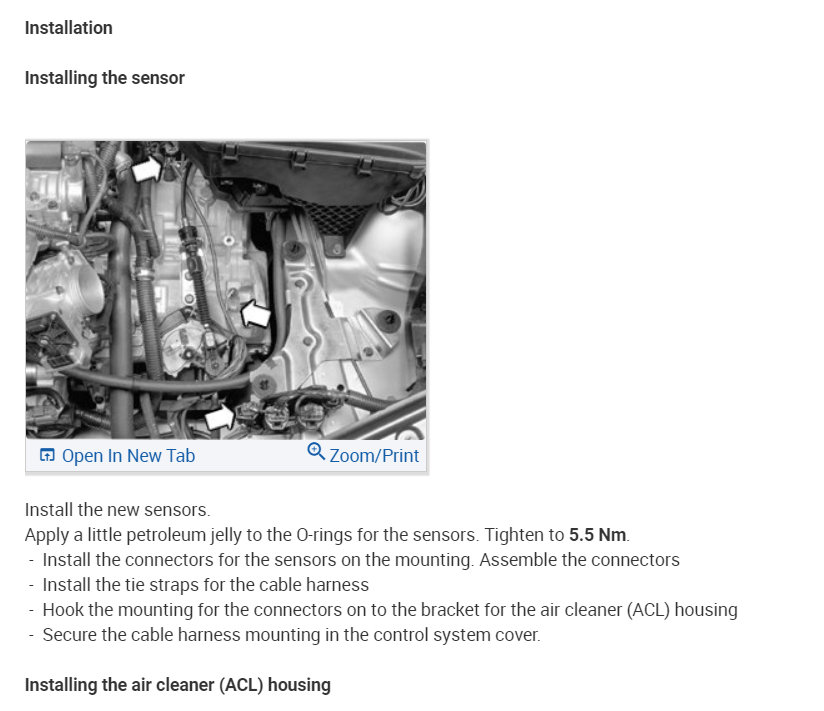

Hey Ken, do you know where I can order the VSS output sensor for my 1999 Volvo S80 2.9L? And the part number? It is very hard finding it.
Jul 29, 2022 at 11:01 AM
  • 55,433 POSTS
Hi Kavin,
That part maybe hard to find, call around and try Ebay. here is the part number:
Speed Sensor - 9445688
Let me know what happens.

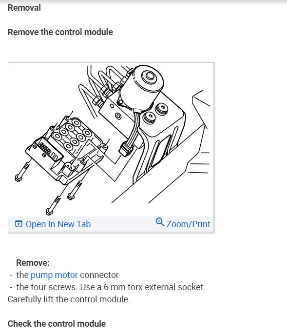

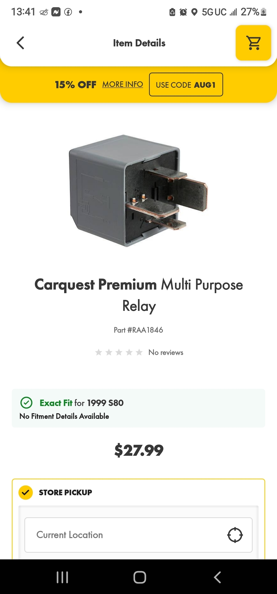

I didn't see the part on eBay at all but by chance do you know where the ABS relay is located on my 1999 Volvo s80 2.9L?
Aug 1, 2022 at 1:26 PM
  • 55,433 POSTS

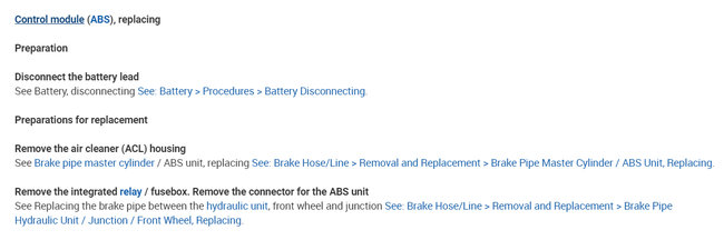

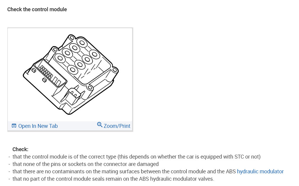

the control relay is inside the ABS module. here are the instructions and location:
Aug 3, 2022 at 3:45 AM
KAVIN THOMPSON
  • 19 POSTS
Oh no, not the ABS control module the relay for it or the VSS relay if it has one.

The locations because Volvo only tells you the fuses but not the relays as well.

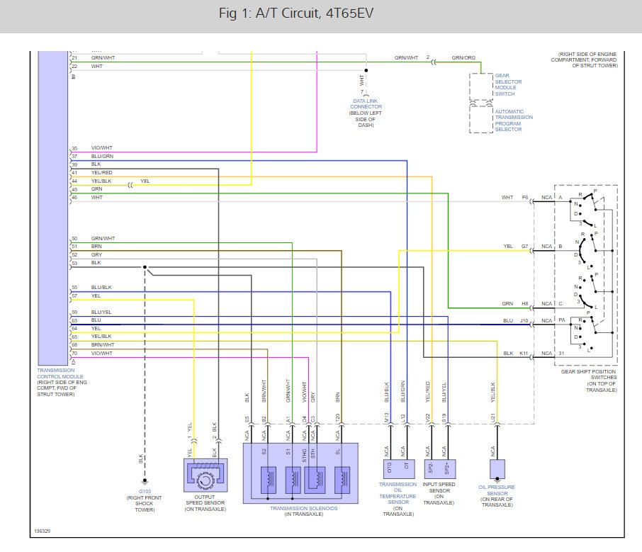

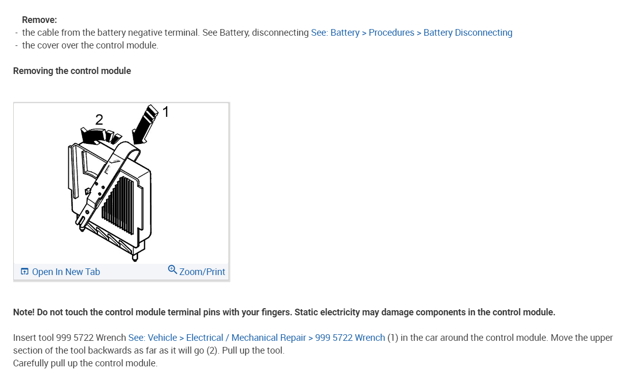

Hmm, I don't see the relay. Here are wiring diagrams for the transmissions and they don't show a relay for the VSS (output speed sensor). Check out the diagrams (below).

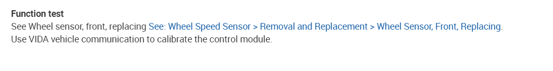

Hey Ken, it's me again. Do you think faulty rear wheel speed sensors can be the problem?
Sep 28, 2022 at 3:06 PM
  • 55,433 POSTS
I don't think so because the car has a VSS sensor. Did you check the wiring between the sensor and TCM?
Sep 29, 2022 at 6:27 AM
KAVIN THOMPSON
  • 19 POSTS

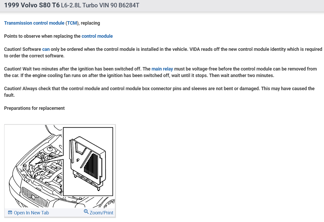

I replaced the VSS, I found the part online finally but the code persists.
Sep 30, 2022 at 12:11 AM
  • 55,433 POSTS

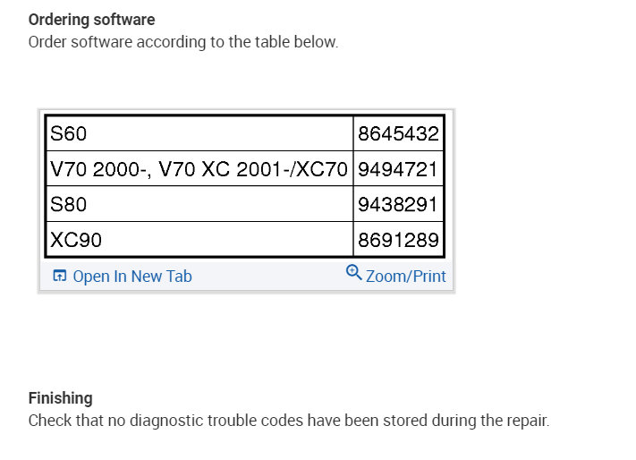

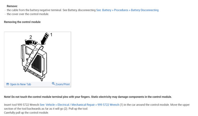

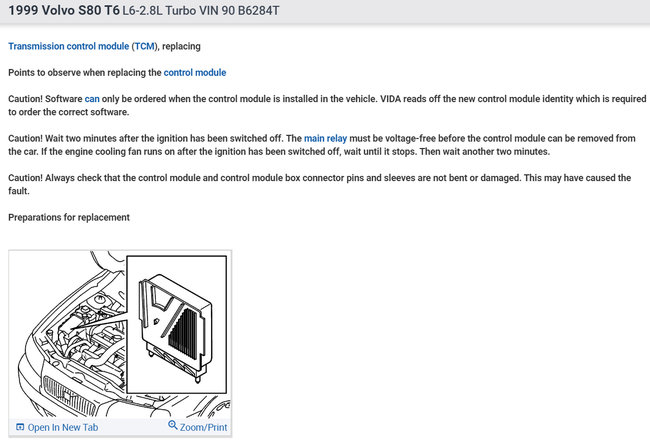

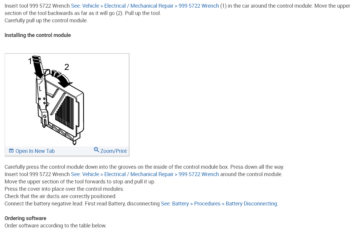

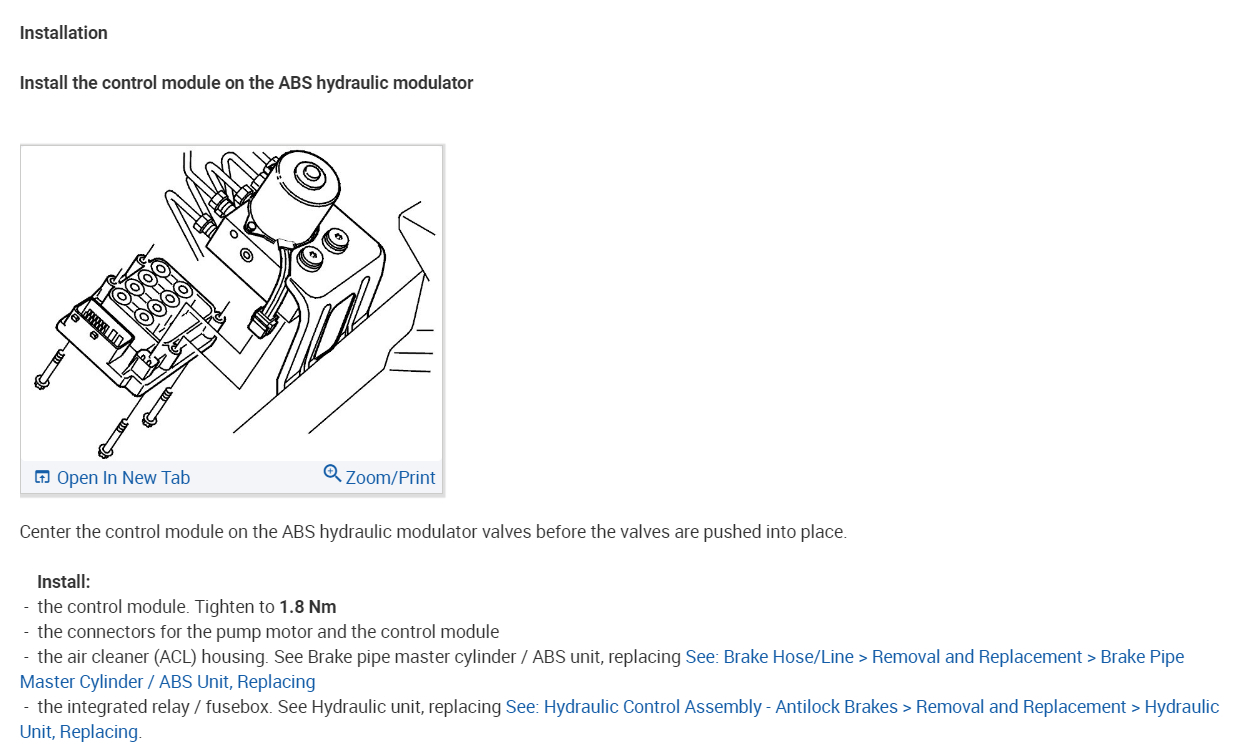

I would check the connection between the sensor and the TCM and if okay replace the TCM. You can get a rebuilt unit by searching Google or eBay. Here is the location of the TCM and how to replace it in the images below. Check out the images (below). Please let us know if you need anything else to get the problem fixed.
