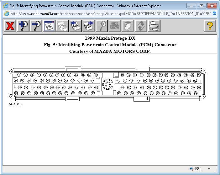

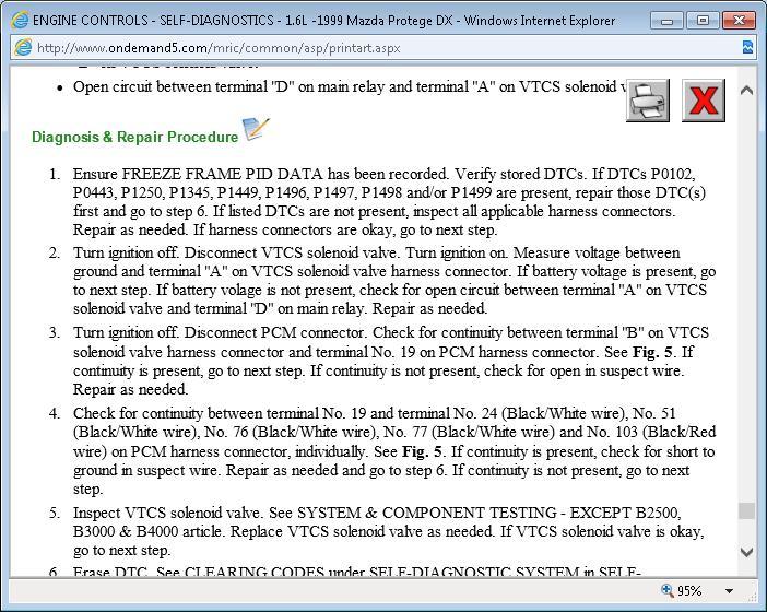

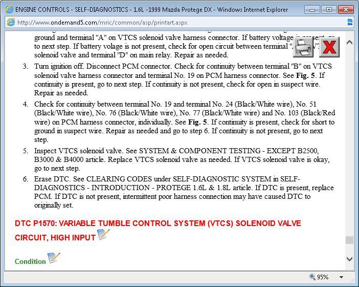

SATURNTECH9
  • 30,869 POSTS
Sounds like its a issue with circuit/wires connections or ecm.I need to know which engine you have to get you the correct trouble?Also do you have a multimeter to do some testing?
Jan 6, 2020 at 10:05 AM (Merged)
HSMITH7063
!.6 engine (Protege LX) with auto. CA emissions. Yes, I have a multimeter.
SATURNTECH9
  • 30,869 POSTS
I got you the trouble tree for that code the pcm is behind the right side of the dash.Let know what you find.

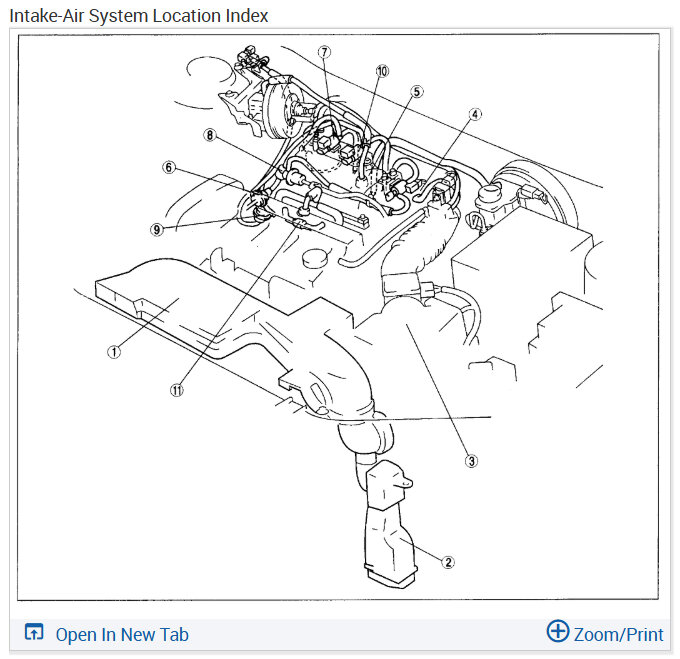

JOSEMUSTANG
Does anyone know where is the VTCS & PCM located in the engine bay and what do they stand for? I want to see if I can replace, or troubleshoot without taking it to a shop since it seems pretty straight forward. I got the P1569 code from Autozone.
Thanks,
Jose.

PCM= Powertrain Control Module, or the main computer
VTCS=Variable Tumble control system P1569=low voltage. The best way to check it is to use a vacuum tester and see if it holds vacuum for 5 seconds, if not replace it, it's on the intake manifold.

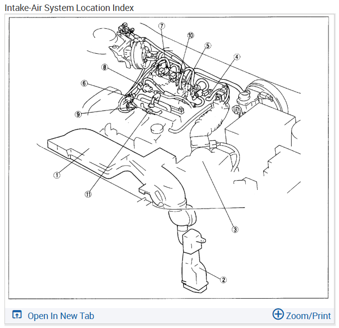

Hey Ken! Thank you for your answer, my car (01 protege ES 2.0) is giving me same P1569 “vtcs solenoid valve circuit low input” and even when does not affect the car drivability the CEL in the dash makes me stare at it”.
Apr 21, 2025 at 9:51 PM
  • 55,204 POSTS
Okay, this is because the flow valve system inside the intake manifold is not working. I would disconnect the solenoid and work the valve by hand to see if it is moving fully, you might need to remove the intake and clean it or see why the VTCS valve is not moving. Also, check the vacuum lines going the solenoid as well. Check out the images (below). Let us know how it goes
