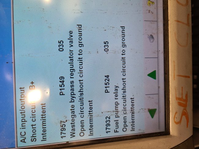

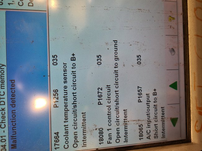

Hi guys, I have a mk4 golf tdi ASZ engine and i went through a sizable puddle. Instantly the car went into limp mode. It will reset for a bit but come back. I've plugged it in and I am getting the same faults every time which are
P1549
N75 wastegate bypass regularly valve open circuit/short circuit to ground intermittent.
P1524
Fuel pump relay open/short
P1256 coolant temperature sender open/short
P1672
Fan 1 control open circuit
P1657
AC input/output short circuit to b+
When I erase them these faults come back after a day or so. I've had the n75 valve replaced (genuine) and the ECU pins checked, cleaned the earth under scuttle panel and had the main loom multimeter checked by a VW tech and they are stumped. I'm hoping someone has had a similar issue that could point me in the right direction. Many thanks,

When he checked the ECU, what was he checking for? For example, was he checking the wiring condition and the connection or operation of the ECU? Was it checked when the vehicle was in limp mode or after it was cleared? Also, how much water did you hit and how is the vehicle running? I realize it goes into limp mode, but before that happens, how is it running?
Oct 24, 2020 at 4:38 PM
DAN07
Hi, thanks so much for the response. So he was looking for possible broken wires or signs of water using a multimeter on the 120 pin plug connector. It was checked with faults in the memory but not while it was actively in limp. then they were cleared after he couldn't find any signs of wire damage.
It wasn't deep water as it was on a flat bit of motorway but enough to go into limp almost immediately. It runs great when not faulting then randomly ill hear the tone of the engine change to a more louder deeper noise and that's when the turbo won't work. If I erase the fault it buys me a few days but then it gets progressively worse. It seems to happen more when I'm slowing down then trying to accelerate. If there's anything else you need just let me know.
His next idea was to run a wire straight from n75 to ECU to see if that made a difference but this seems to have stumped some people.

I suspect that either there is an open circuit or the bypass regulator is bad. The idea that he checked the connections for water and breaks should have shown an open, but he could have missed it. Since it works for some time and then fails, I have a feeling the bypass regulator is bad, but testing will prove that.

DAN07
I had ruined the ECU in the end. Bought a E20 one from eBay and a master tech in work swapped the info over. All was well from then on
