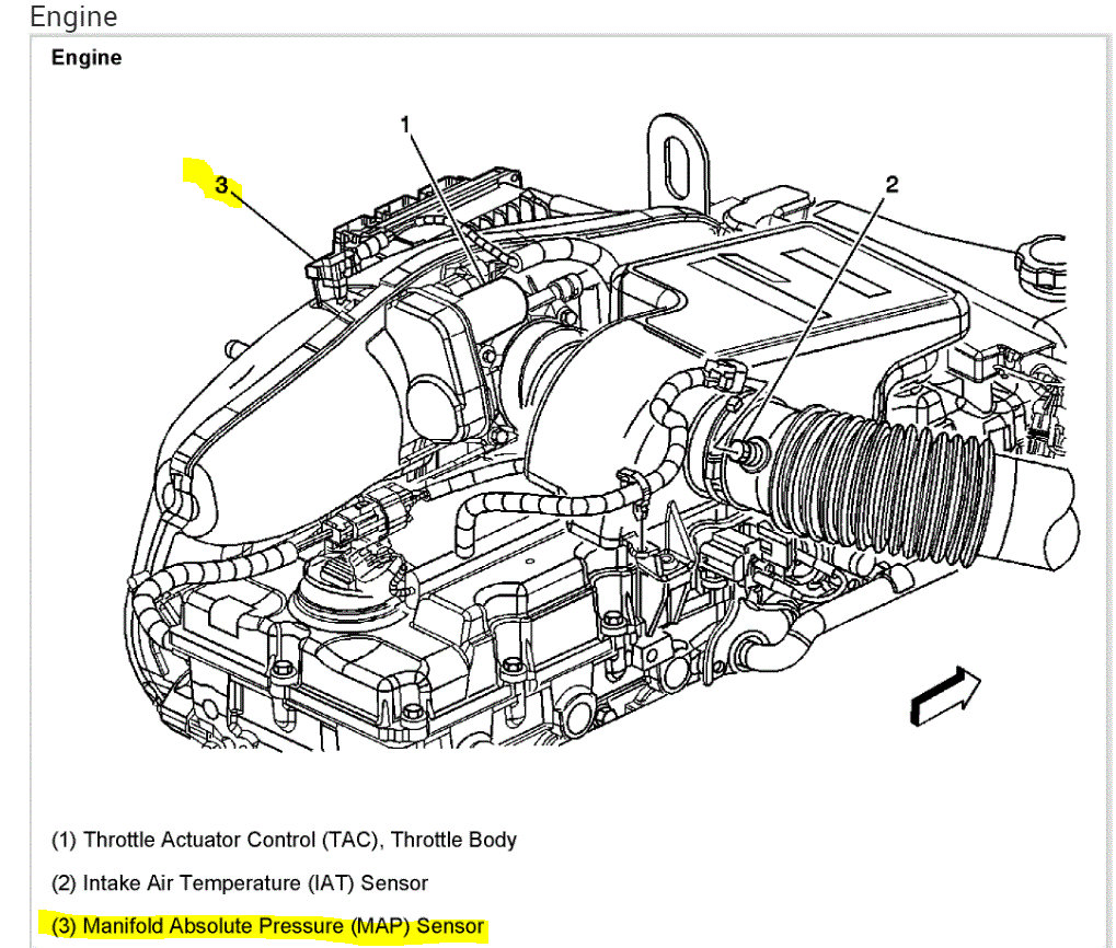

The code, P1514 is related to the map sensor (manifold absolute sensor). It is indicating that more airflow through the intake is occurring than expected. Have you checked for vacuum leaks? Also, do you have a live data scan tool?
If you have a live data scan tool, allow the engine to reach operating temperature. Check the voltage signal from the MAP. It should operate between 0.8v and 4v.
If you don't have a live data scanner, check for vacuum leaks. Here is a link you may find helpful:
Also, check the connector at the MAP sensor for damage. Make sure the connector is in good condition and not corroded. I attached a pic below showing the MAP location.
Let me know what you find.
See pic below.
