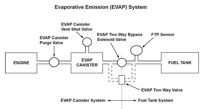

Since you have noticed there is no pressure, then you must simply have a leak. Here is the definition of the code:
DTC P1457: Evaporative Emission (EVAP) Control System Leakage (EVAP Canister System)
Because there are several areas which can leak, what I suggest is to have the system fogged. Basically, fog or smoke is injected into the EVAP system at a very low pressure. Where the leak is located, smoke will come out.
As far as the FTPS, I don't think that is the issue here. However, if you want to try diagnosing the issue (and based on what you have already done you seem more than capable) here are the directions. The attached pictures correlate with the directions.

DTC P1457: Leak Detected in EVAP Control System (EVAP control canister system)
NOTE: The fuel system is designed to allow specified maximum vacuum and pressure conditions. Do not deviate from the vacuum and pressure tests as indicated in these procedures. Excessive pressure/vacuum would damage the EVAP components or cause eventual fuel tank failure.

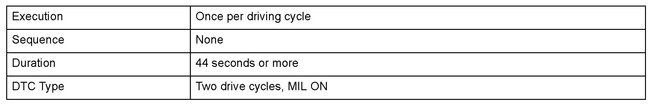

Please note that these are two-trip codes, once cleared, they cannot be reproduced in one trip. Also certain specific driving and ambient conditions must occur before the ECM/PCM will complete the system checks. Additional test drives may still not meet the specific conditions needed to reproduce the codes.
Therefore, follow these troubleshooting procedures carefully to ensure the integrity of the system and to confirm the cause of the problem or code.

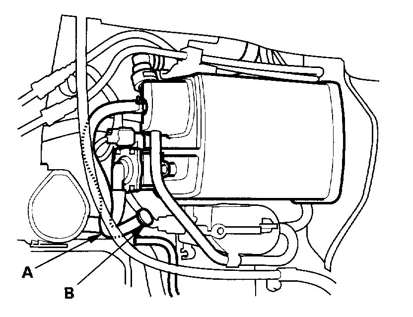

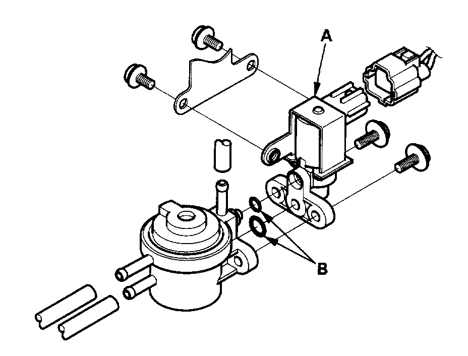

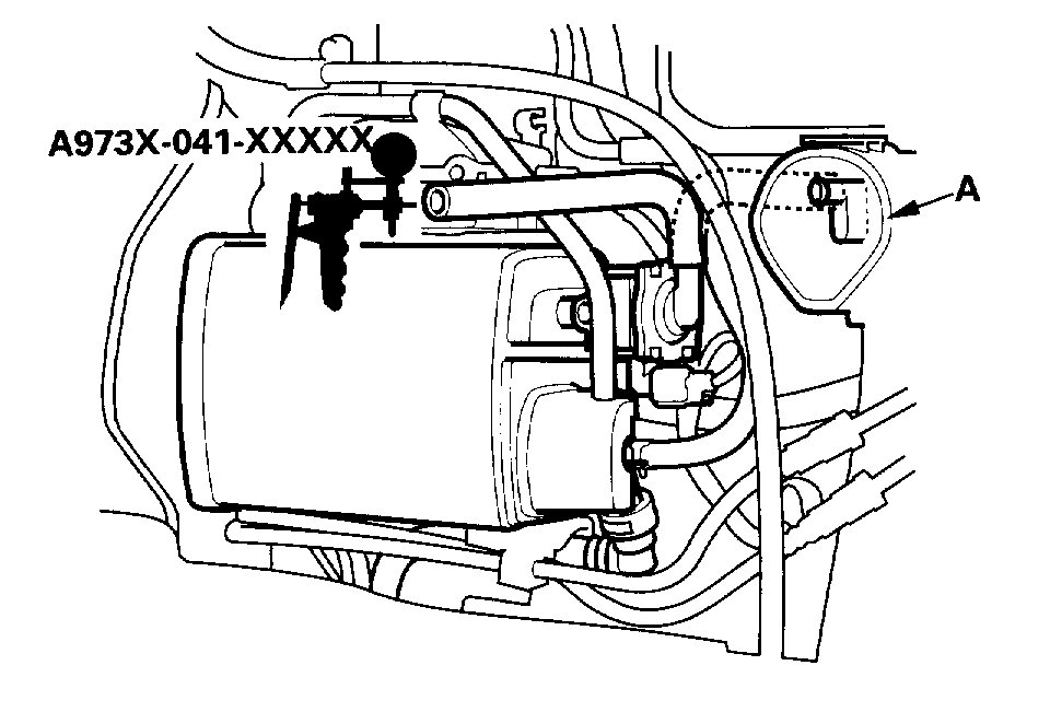

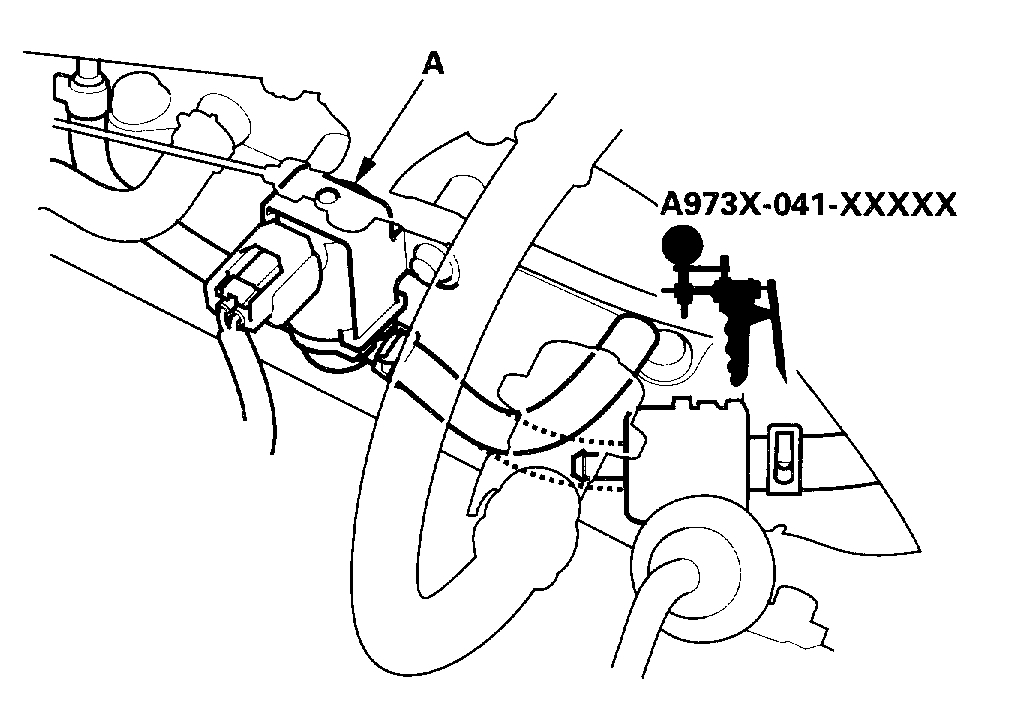

EVAP Purge Control Solenoid Valve Test
pic 1
1. Disconnect the vacuum hose from the EVAP purge control solenoid valve (A), and connect the vacuum pump to the hose.

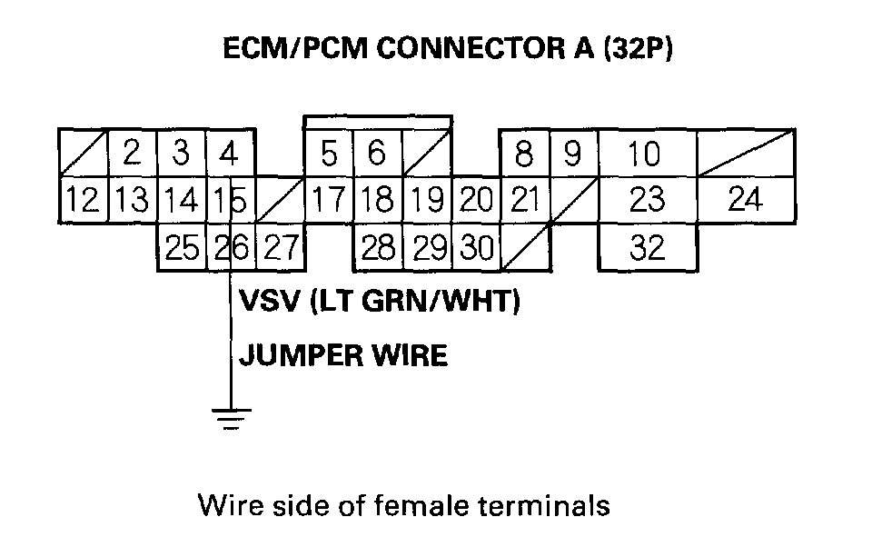

pic 2
2. Connect the ECM/PCM connector terminal A6 to body ground with a jumper wire.
3. Turn the ignition switch ON (II).
4. Apply vacuum to the hose.
Does the valve hold vacuum?
YES-Go to step 5.
NO-The EVAP purge control solenoid valve is OK. Go to step 10.

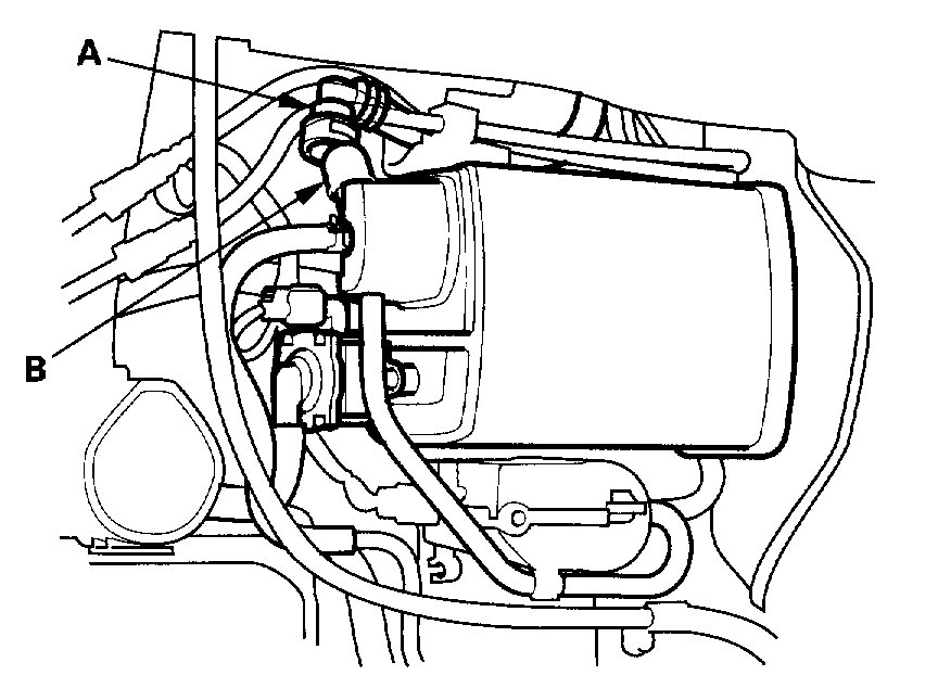

pic 3
7. Check for continuity between the EVAP purge control solenoid valve 2P connector terminal No.2 and body ground.

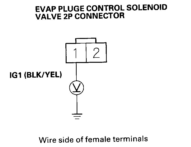

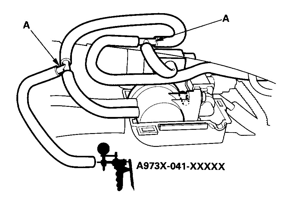

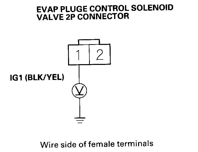

8. Turn the ignition switch ON (II).
pic 4
9. Measure voltage between the EVAP purge control solenoid valve 2P connector terminal No.1 and body ground.
Is there battery voltage?
YES-Replace the EVAP purge control solenoid valve.
NO-Repair open in the wire between the EVAP purge control solenoid valve and No.6 ECU (ECM/PCM) CRUISE CONTROL (15 A) fuse.

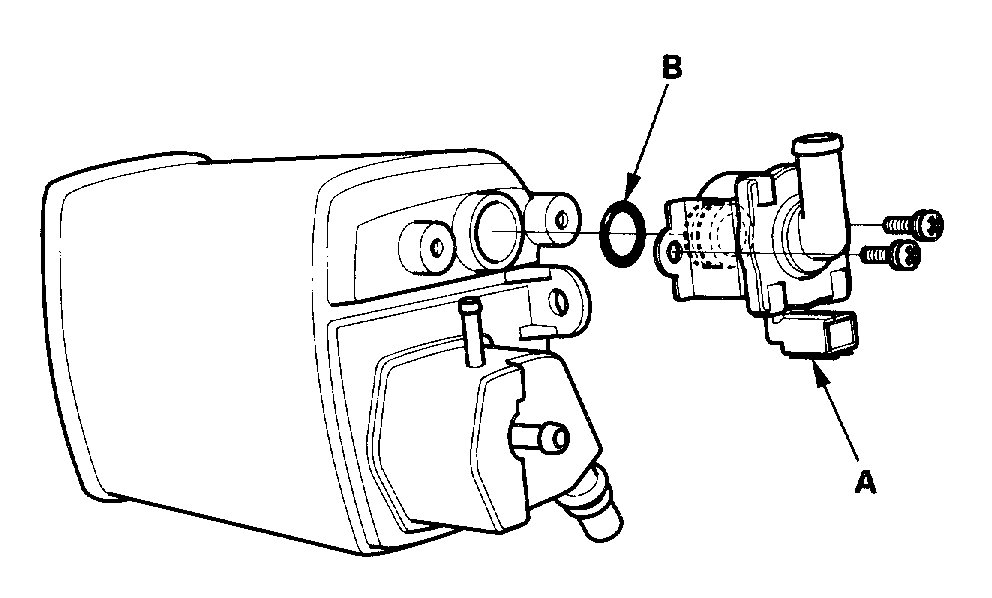

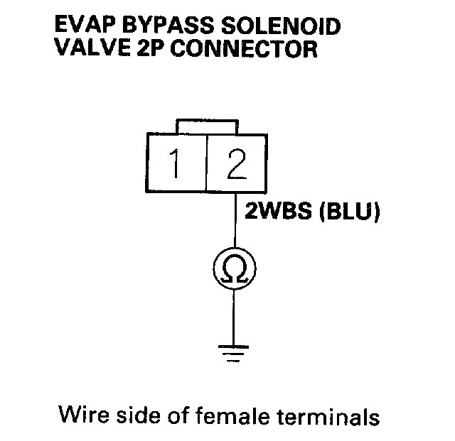

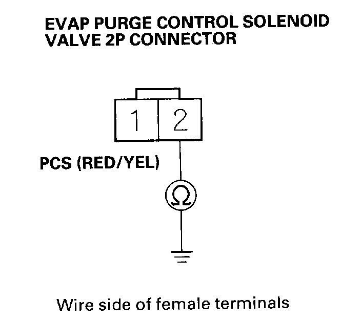

EVAP Bypass Solenoid Valve Test
pic 5

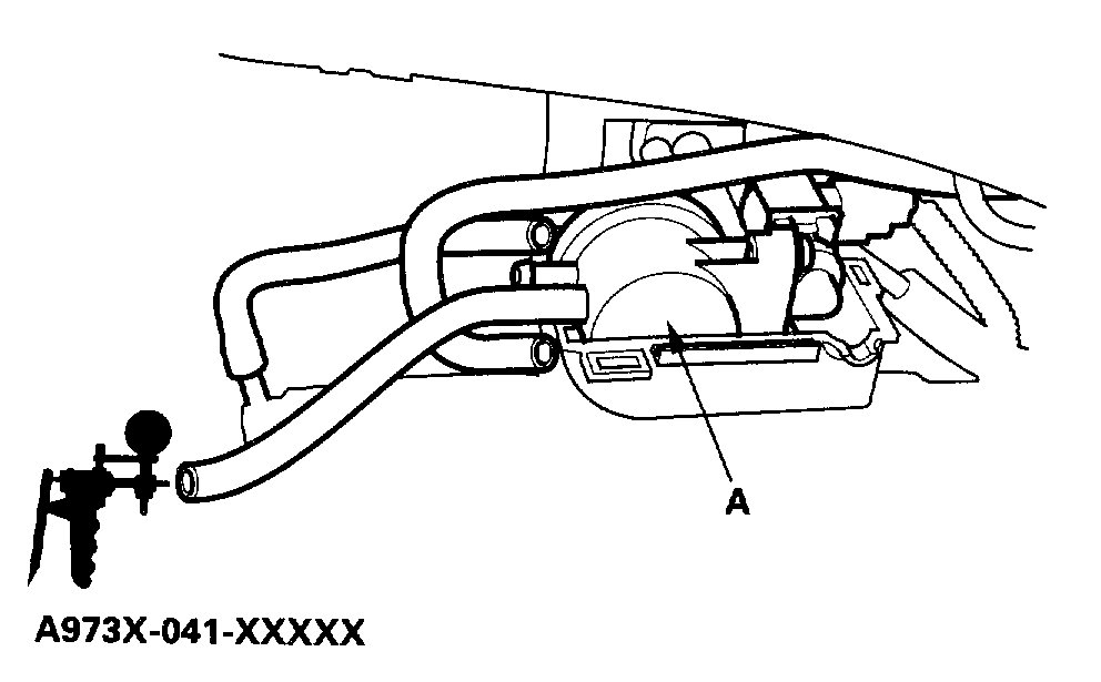

10. Disconnect the vacuum hose from the EVAP two way valve (A), and connect a vacuum pump to the hose.
11. Turn the ignition switch ON (II).
12. Apply vacuum to the hose.
YES-EVAP bypass solenoid valve/EVAP two-way valve is OK. Go to step 18.
NO-Go to step 13.

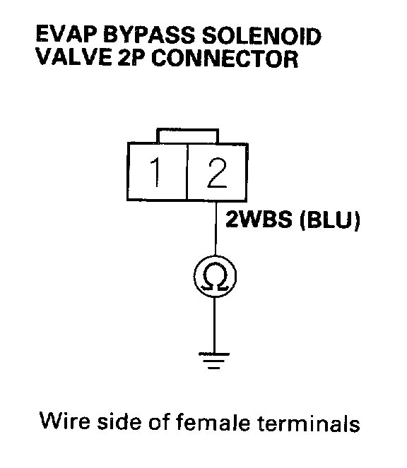

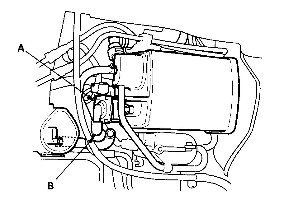

13. Turn the ignition switch OFF.
14. Disconnect the EVAP bypass solenoid valve 2P connector.
pic 6
pic 7
15. Check for continuity between the EVAP bypass solenoid valve 2P connector terminal No.2 and body ground.
Is there continuity?
YES-Go to step 16.
NO-Replace the EVAP bypass solenoid valve (A) and O-rings (B).

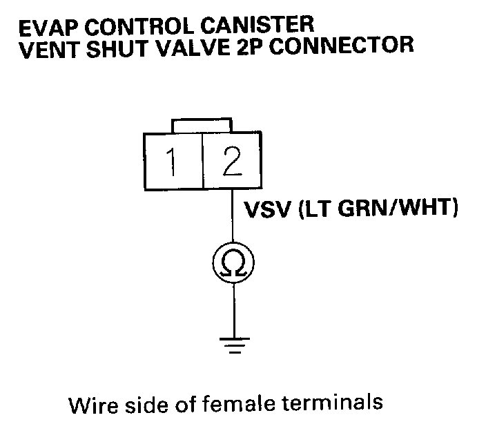

EVAP Control Canister Vent Shut Valve Test
pic 9
18. Disconnect the vacuum hose from the EVAP control canister filter (A), and connect a vacuum pump to the hose.
pic 10
19. Connect the ECM/PCM connector terminal A4 to body ground with a jumper wire.
20. Turn the ignition switch ON (II)
21. Apply vacuum to the hose. Does the valve hold vacuum?
YES-EVAP control canister vent shut valve is OK.
Go to step 27.
NO-Go to step 22.
22. Turn the ignition switch OFF.
23. Disconnect the EVAP control canister vent shut valve 2P connector.
pic 11
24. Check for continuity between the EVAP control canister vent shut valve 2P connector terminal No.2 and body ground.
YES-Go to step 25.
NO-Repair open in the wire between the EVAP control canister vent shut valve and ECM/PCM (A4).

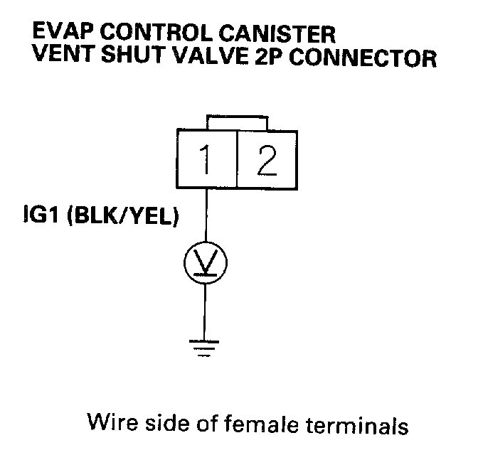

25. Turn the ignition switch ON (II).
pic 12
pic 13
26. Measure voltage between the EVAP control canister vent shut valve 2P connector terminal No.1 and body ground.
YES-Replace the EVAP control canister vent shut valve (A) and O-ring (B).
NO-Repair open in the wire between the EVAP control canister vent shut valve and No.6 ECU (ECM/PCM) CRUISE CONTROL (15 A) fuse.

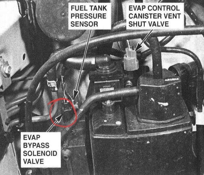

Hello and welcome to 2CarPros. Just wanted to jump in and post a service bulletin for the bypass valve and the PCM on this particular code.
Collision
 8
1998 Honda Accord EX Coupe
L4-2254cc 2.3L SOHC (VTEC) MFI
Emissions/Engine Controls - MIL ON/DTC P1457 (EVAP)
Vehicle Powertrain Management Technical Service Bulletins Emissions/Engine Controls - MIL ON/DTC P1457 (EVAP)
EMISSIONS/ENGINE CONTROLS - MIL ON/DTC P1457 (EVAP)
03-001
January 28, 2003
Applies To:
See VEHICLES AFFECTED
MIL Comes On With DTC P1457: EVAP Bypass Solenoid Valve Failure
SYMPTOM
The MIL is on, and DTC P1457 [leak detected in EVAP control system (EVAP control canister system)] is set.
PROBABLE CAUSE
The EVAP bypass solenoid valve can fail due to corrosion. The solenoid valve may get water inside. If the water contains road salt, the solenoid windings could corrode, causing the valve to fail. In a few rare instances, the corrosion could be severe enough to cause an internal short in the solenoid valve, which could damage the ECM/PCM. If this happens, both the bypass solenoid valve and the ECM/PCM would need to be replaced.
Vehicles driven in the Northeastern part of the U.S. are more likely to have this problem because of the salting of roads during the winter months. Vehicles driven where salt is not used on the roads are much less likely to have this problem.

CORRECTIVE ACTION
Test and, if necessary, replace the EVAP bypass solenoid valve. Replace the ECM/PCM if needed.
