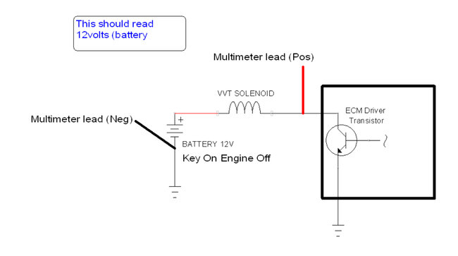

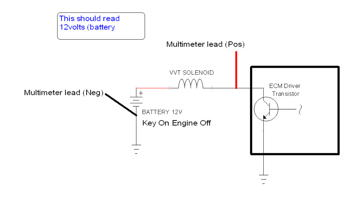

Well, with what you were saying about your findings in the oil pan and the carbon build up on the top end near the camshafts, was that because of a previous owner not taking care of it? My concern is possible carbon being clogged up in the oil ports going up to the cylinder head. Once there's as much as you described, it's pretty much all through the engine. If you want to check the VVT solenoid wiring, it will have a 12volt feed wire and then a wire running back to the ECM which controls the solenoid on the Ground side of the solenoid circuit. So, with the key on engine off, you can actually check the wire at the ECM (the control wire) for 12volts. It will have 12volts until the ECM starts to control the VVT solenoid, which obviously won't happen until the vehicle is running. So, a good circuit check method is to see if the 12volts is making it from its source, through the solenoid, and then back to the ECM connector.
I can make up a quick diagram to explain this a bit better, but that control wire will have 12volts until the ECM starts to pulse the Ground of the solenoid, at which time the 12volts will be pulled to ground, and you would read 0volts. (Or average of the ECM pulse width modulation). Since that is how the ECM controls these solenoids, it pulses the ground wire on and off extremely fast to have accurate control of the solenoid. I understand this might sound confusing, so we can start checking things wherever you are comfortable. Do you have a scan tool and/or basic multimeter?
If you have any questions just ask, I'll keep trying to find this engine's info.
Here's a little diagram to help check the VVT circuit voltage:
