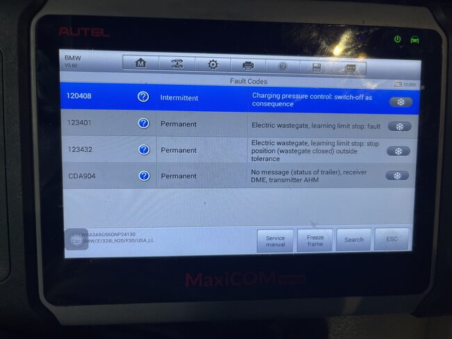

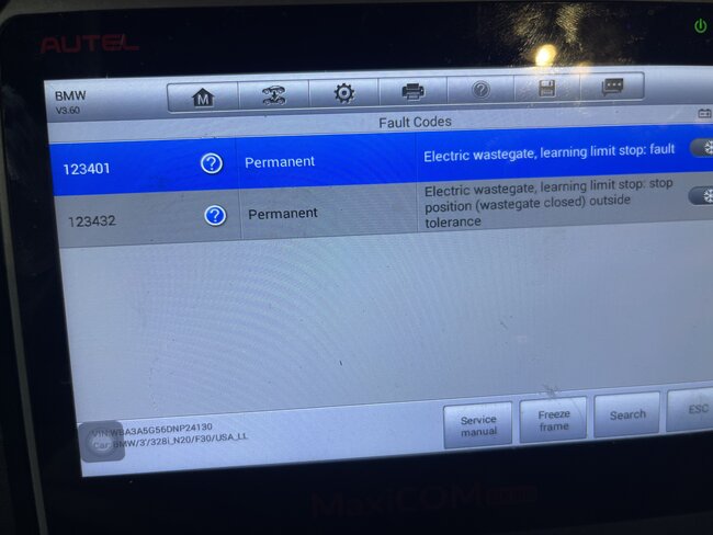

Drives great not in limp mode. I still have the same four codes to turbo but when i delete them and before starting the car i only get 2 codes which means it's a hard code. Having a hard time trying to understand what part i need based on the two codes left.
Oct 30, 2022 at 8:50 AM

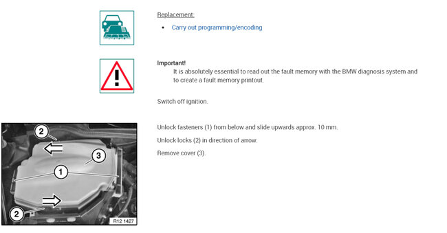

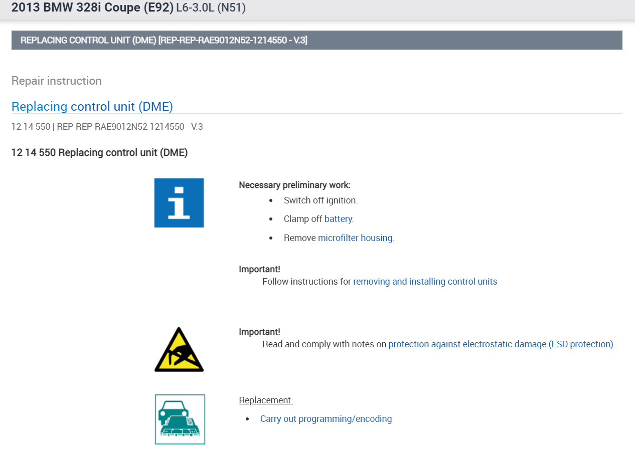

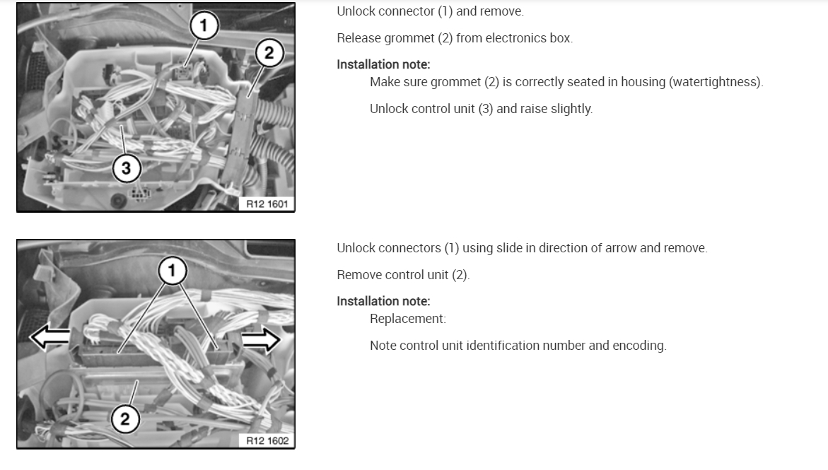

Yep, that DME code I don't like, it can be causing the other codes, I would try to get a rebuilt DME to see if that fixes it. The code P1290 is a difficult one to fix. Check out the images (below). Please let us know what happens.
Oct 31, 2022 at 4:49 AM
