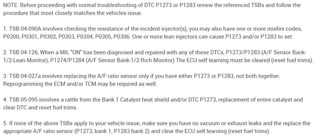

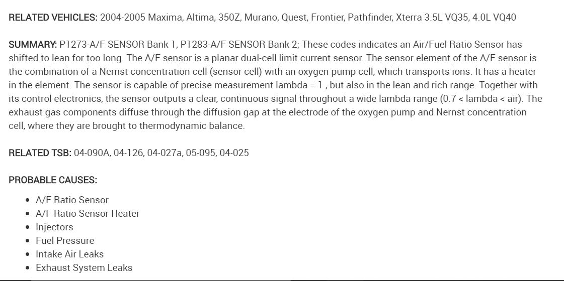

I am having trouble diagnosing a p1283 code on my vehicle listed above. I have replaced both upstream sensors.There no obvious exhaust leaks I have done all the diagnosing as described in the factory service manual (FSM) so there is no shorted or open wires in the harness.Also I have done the accelerator pedal position re-learn, throttle valve closed position re-learn, idle air volume re-learn and the air fuel ratio reset that are all listed in the FSM. After all this I am still getting the code. This is after swapping in a used engine that had approximately 67,000 miles on it. I replaced all the gaskets from the heads up and installed new primary catalytic converters.

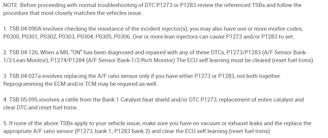

Do you have access to a scan tool that can look at a live data stream? Here is actually a technical service Bulletin on this issue. Also you may have just gotten a bad sensor, maybe try switching the 02's from side to side and see if the code goes to Bank 1 instead of Bank 2. If you get a P1273 that's bank 1.

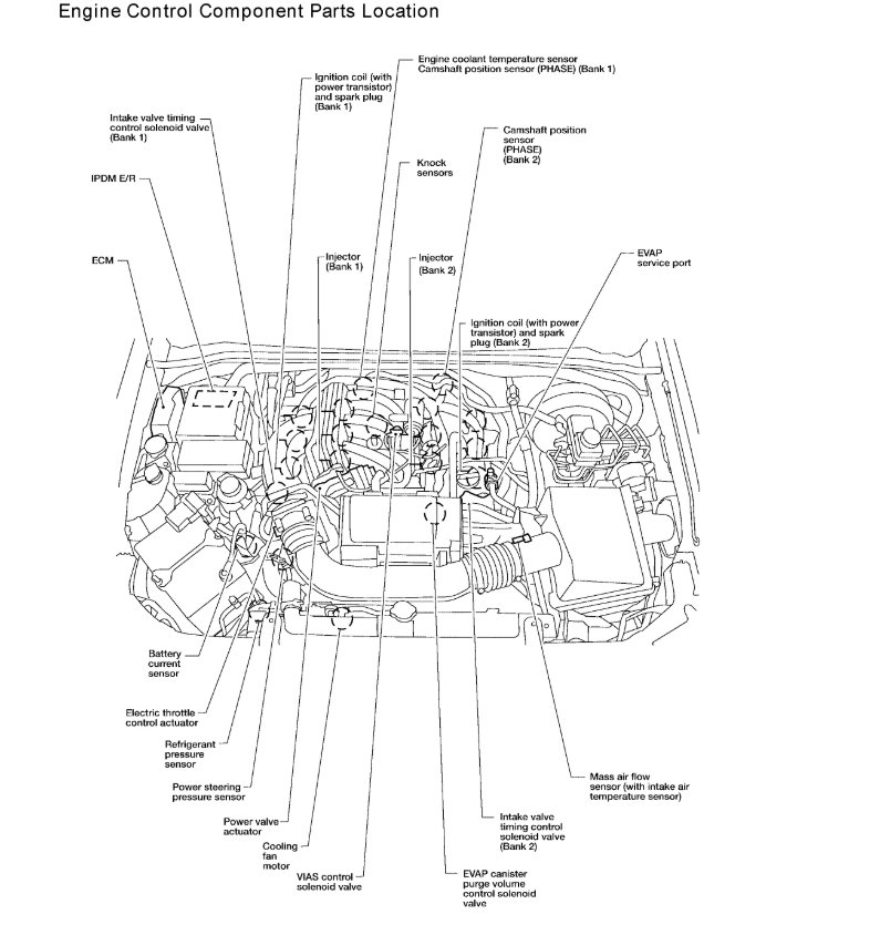

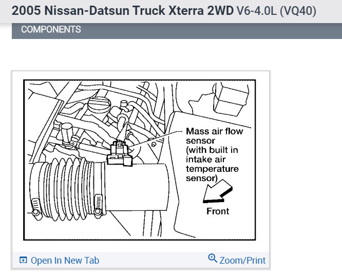

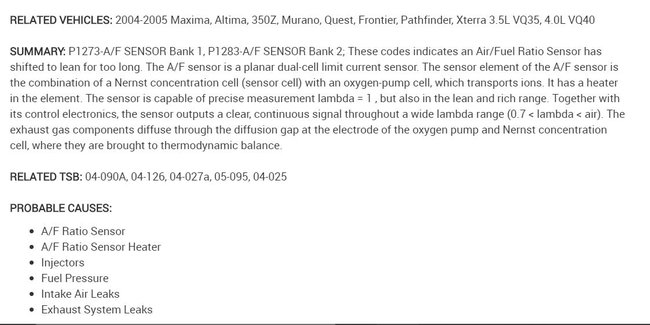

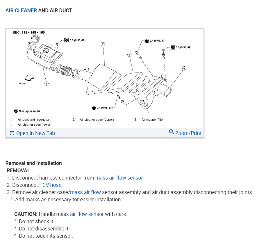

P1283 Nissan Possible Causes. Faulty Air Fuel Ratio (A/F) Sensor 1 Bank 2; Air Fuel Ratio (A/F) Sensor 1 Bank 2 harness is open or shorted. I have seen the MAF sensor cause this issue dues to low readings. I would try a new sensor here is its location. Also please service the throttle body. These guides will help with instructions in the diagrams below on how to change the sensor out:
https://www.2carpros.com/articles/how-to-replace-a-mass-air-flow-sensor-maf
and
Apr 30, 2020 at 3:25 AM

Sounds good the P1283 - Air fuel ratio (A/F) sensor 1 (Bank 2) lean could be caused by a misfire are a clogged injector. can you remove the spark plugs on bank 2 to check the color of the plugs? you are looking for a clean (white) plug or black (soot) to identify the problem cylinder. Please upload a picture of the plugs so we can see what's going on.
