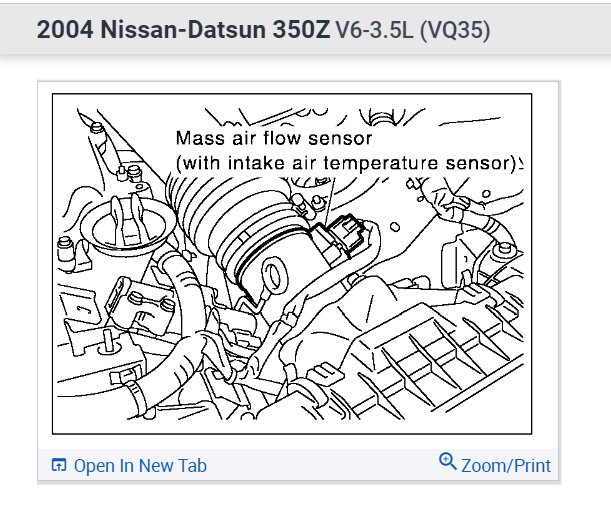

Hello, I am having the same problem as https://www.2carpros.com/questions/p1283-nightmare but I am getting the code for both. I have the turbonetics turbo kit installed had it for about a year and now I am getting the codes. I have replaced both o2s. Can't seem to find the problem.
Jul 10, 2023 at 11:03 PM
  • 55,433 POSTS
This can be a vacuum leak, low fuel pressure/delivery, bad fuel injectors or a bad. Please go over this guide:
https://www.2carpros.com/articles/repair-lean-mixture-codes-p0171-or-p0174-on-some-manufacturers
I have seen the MAF sensor cause this problem.

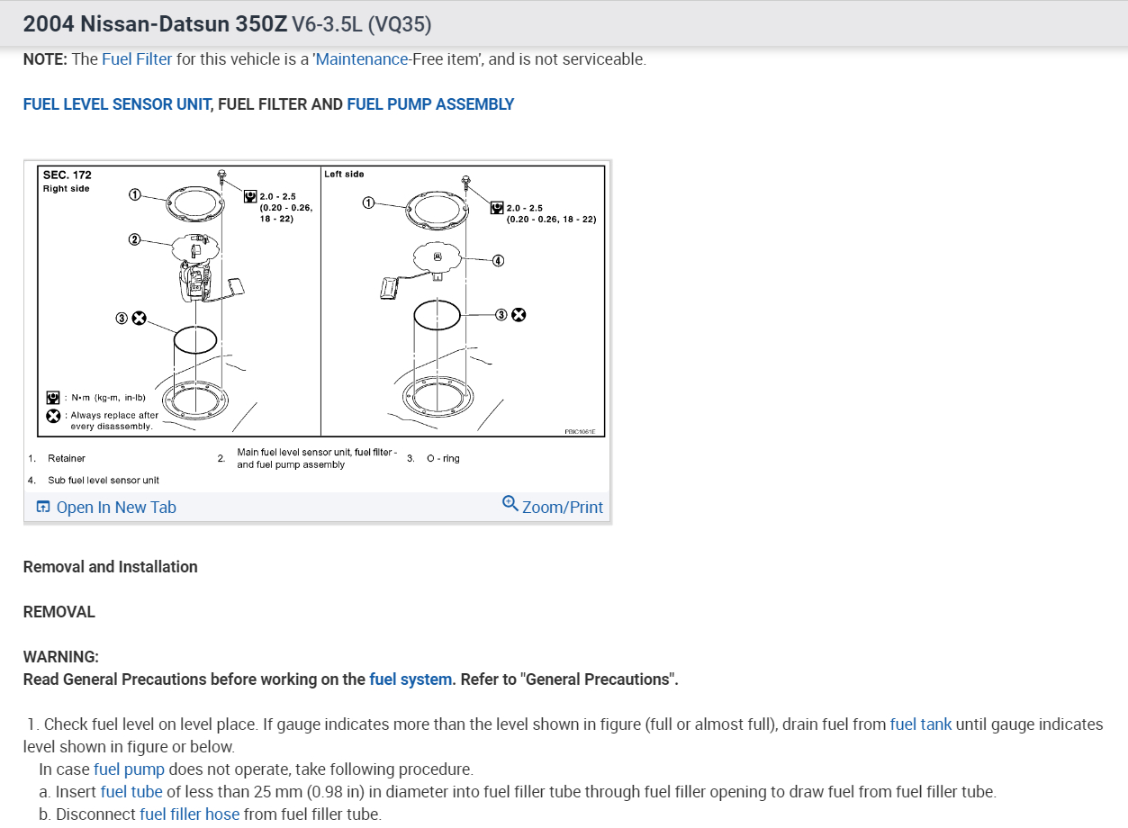

The fuel pump could be getting weak as well. Check out the images (below). Please let us know how it goes
