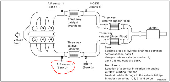

Vehicle keeps shutting off and this is the code that came up.
Apr 15, 2021 at 9:07 AM
DANNY L
  • 5,648 POSTS
Hello, I'm Danny.

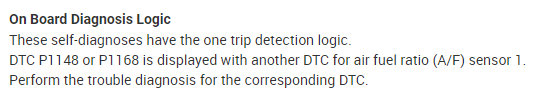

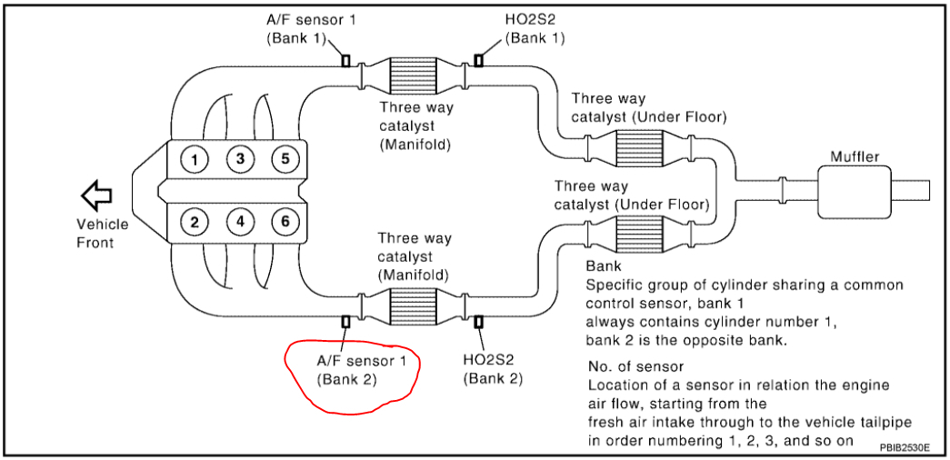

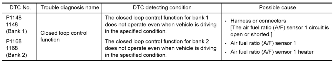

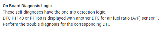

Here is the information you requested. The code you mentioned is a bank 2 sensor 1 heated oxygen sensor code. Here a few tutorials showing how they work and how to replace:
https://www.2carpros.com/articles/how-an-oxygen-sensor-works
https://www.2carpros.com/articles/how-to-test-an-oxygen-sensor-02-sensor
https://www.2carpros.com/articles/how-to-replace-an-oxygen-sensor
I've attached pictures below relating to the code and the location of the faulty sensor for your Nissan and circled in red. Hope this helps and thanks for using 2CarPros.
