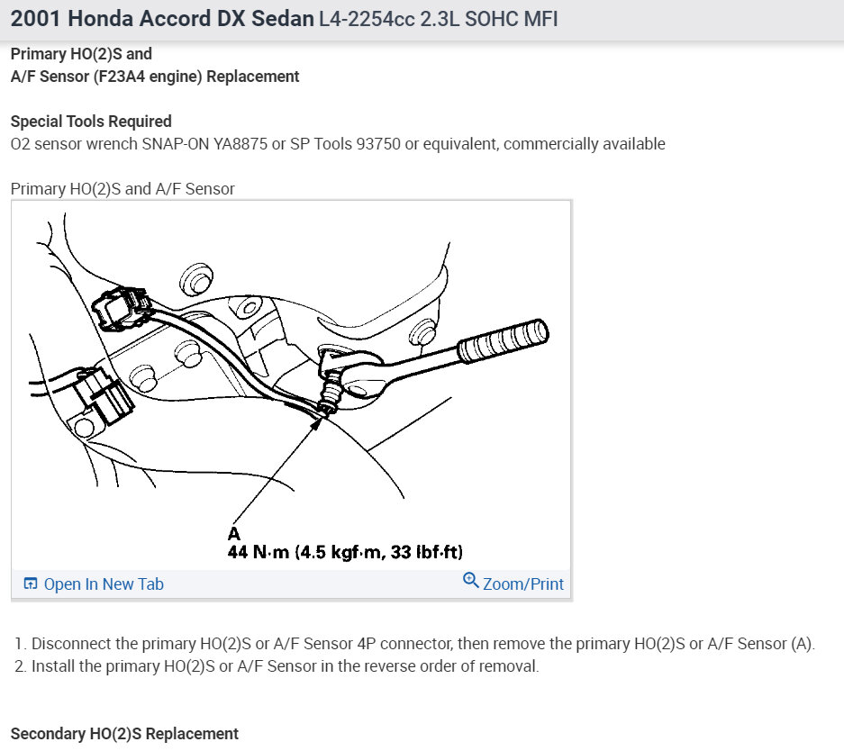

The codes are for the heater circuit, which is common to go out, you can use an OHMs meter to confirm the connection failure inside the sensor heating element. Here is a generic guide to help you step by step with instructions in the diagrams below to show you how on your car:
https://www.2carpros.com/articles/how-to-replace-an-oxygen-sensor

I was able to test for voltage coming to the sensor from the PCM but got no continuity on the heater side of the circuit on the sensor itself, so that seemed to indicate a bad sensor.
Trying to save as much money as possible, I picked up a Bosch o2 sensor for about $50, but the wires are about 3" too short to be able to use it...and that was after driving to 3 different auto parts stores just to find one that fit my '01 Accord 4cyl for Upstream.
Any suggestions for a reliable auto parts place online that I can order from that will get me a proper fitting o2 sensor at a reasonable price?

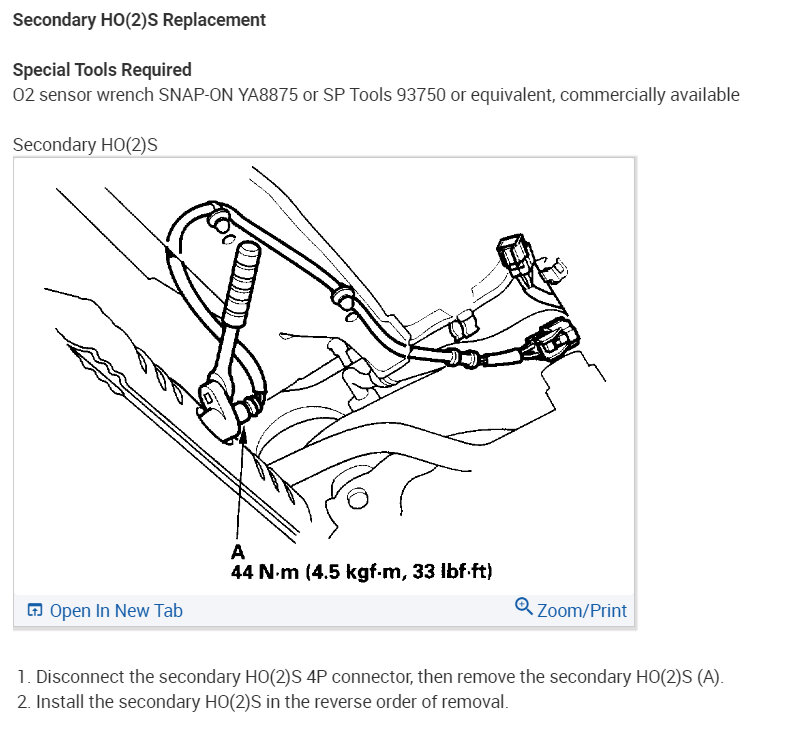

So now I'm back to square one and need to continue diagnosing. I guess my testing of the old sensor was not accurate, because I was assuming the sensor was bad since I was getting no continuity on the sensor itself on the heater side of the terminals.
Should I move on to the downstream o2 sensor, or would you go a different way with diagnosing from this point?

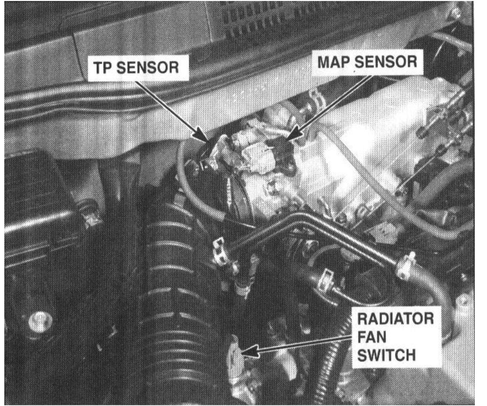

I don't think it is an Oxygen sensor issue, this will be a vacuum leak, engine misfire or MAP sensor that needs to be replaced. Here are two guides to go over, please clear the codes after the work is done.
https://www.2carpros.com/articles/how-to-tune-up-a-car-engine
and use this guide when the engine is cold only:
Here is the location of the MAP sensor so you can change it out. Also how is the engine running? Check out the images (below). Please let us know what you find.

I have not changed out the MAP sensor yet, but I did some checks on it and all the numbers were coming out as expected, such as the 5v reference voltage, and the voltage at idle, which changed as the throttle was increased, so it seemed like the MAP sensor was good, but if you think that may fix it then I could just swap it out and see what happens.
Jul 22, 2023 at 10:31 AM
  • 55,456 POSTS
The sensor may work but the parameters could be off causing the system to lean out. It is worth a try I think, if you get it from Amazon, you can send it back if it does work.

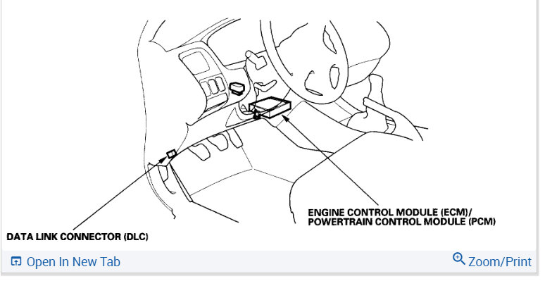

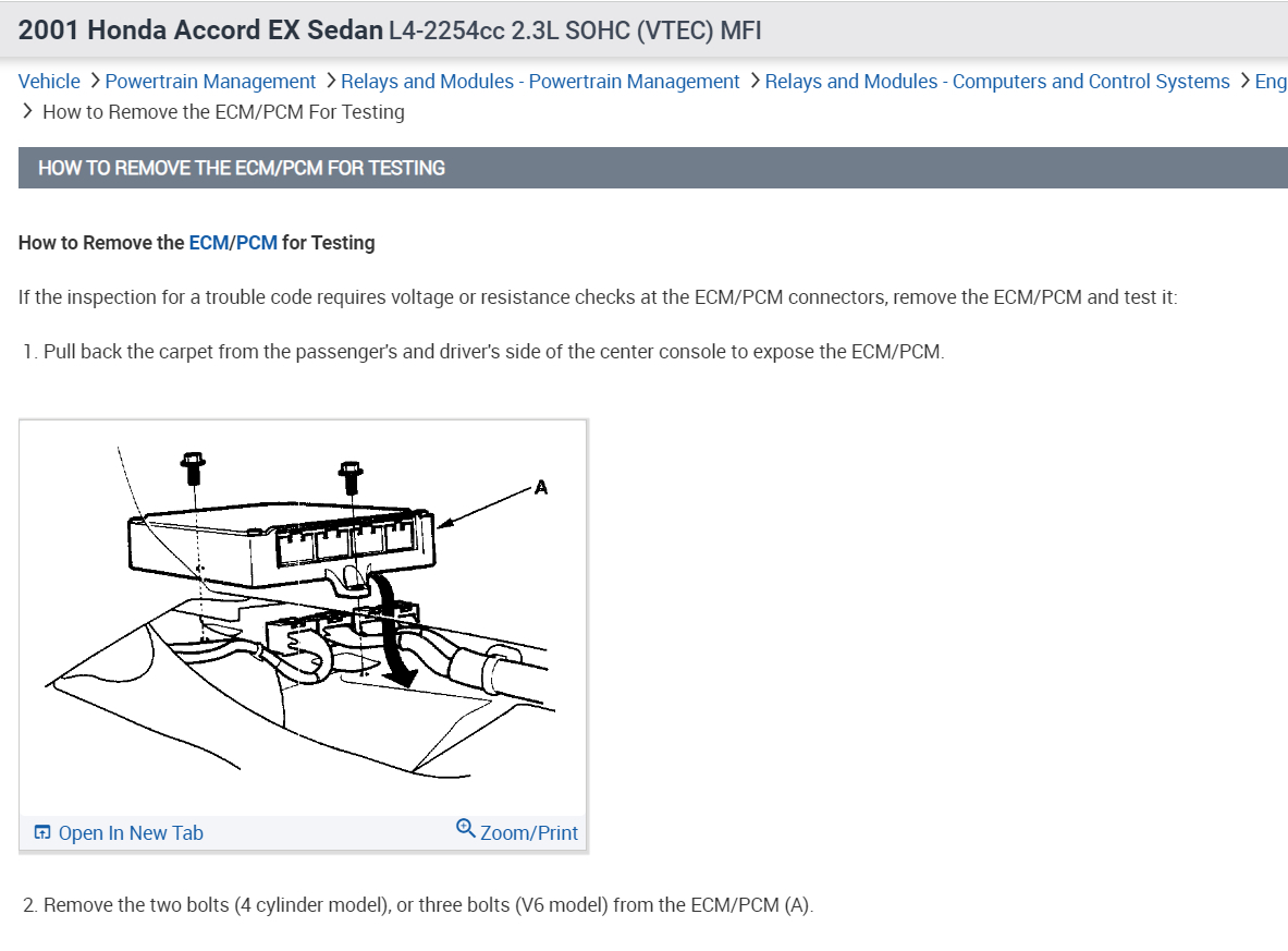

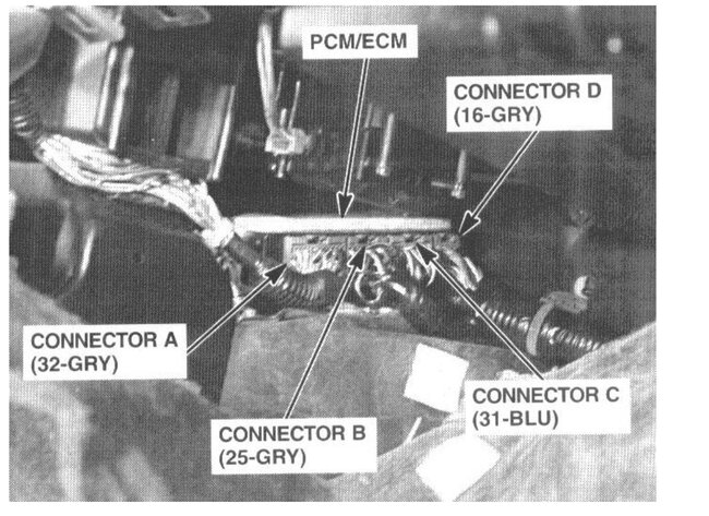

Yep, that is a hard code, that fact that you don't have to drive it and the code is generated, it could mean the PCM is out and needs replacement. I would send it out for testing. Check out the images (below). Please let us know what happens.
