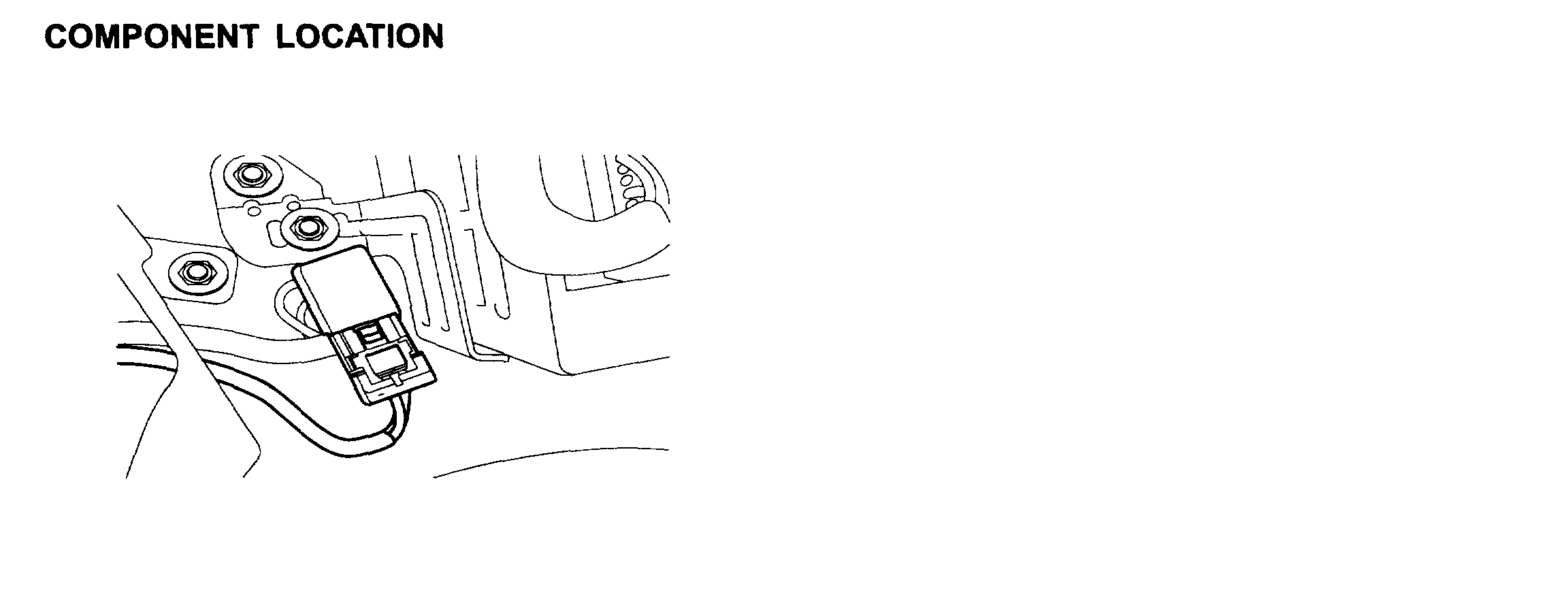

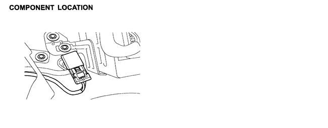

COMPONENT LOCATION
Open In New TabZoom/Print

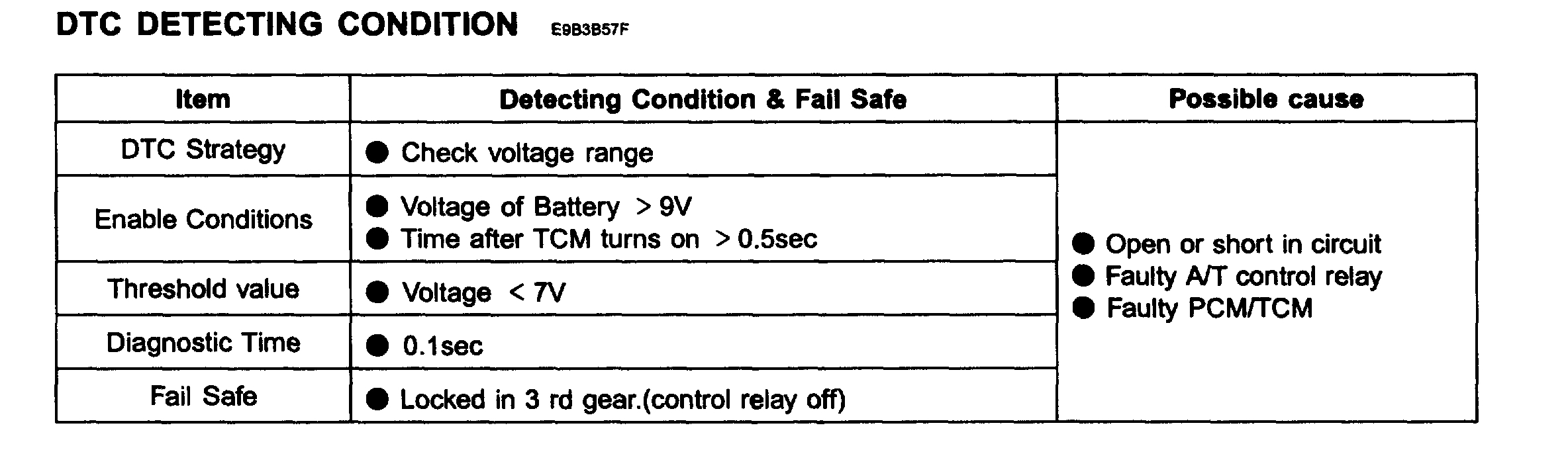

DTC DESCRIPTION
 The TCM checks the A/T control relay signal by monitoring the control signal. If, after the ignition key is turned on, an unexpected voltage value, which is quite a bit lower than battery voltage is detected, the TCM sets this code.
DTC DETECTING CONDITION

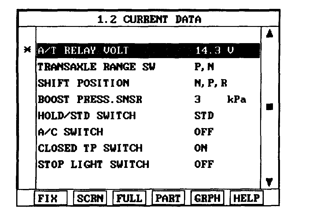

MONITOR SCAN TOOL DATA
 1. Connect scan tool to data link Connector (DLC),
 2. Ignition ON & Engine OFF.
 3. Monitor the A/T, CON. RELAY VOLT parameter on the scan tool.
    Specification: Approximately B+
 4. Is A/T RELAY VOLT within specifications?
    YES
    ^  Fault is intermittent caused by poor contact in the sensor's and/or TCM (PCM)'s connector or was repaired and TCM (PCM) memory was not cleared. Thoroughly check connectors for looseness, poor connection, bending, corrosion, contamination, deterioration or damage. Repair or replace as necessary and go to Verification of Vehicle Repair procedure.
    NO
    ^  Go to Terminal & Connector Inspection procedure.

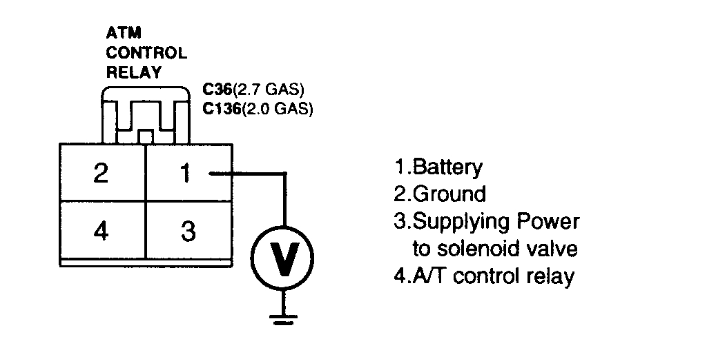

POWER SUPPLY CIRCUIT INSPECTION
 1. Ignition ON & Engine OFF.
 2. Disconnect the A/T CONTROL RELAY connector.
 3. Measure the voltage between terminal 1 of the A/T CONTROL RELAY harness connector and chassis ground.
 4. Is voltage within specifications?
    YES
    ^  Go to Signal circuit inspection procedure.
    NO
    ^  Check that A/T-30A Fuse in engine room junction is installed or not blown.
    ^  Check for Open in harness. Repair as necessary and Go to "Verification of Vehicle Repair" procedure.

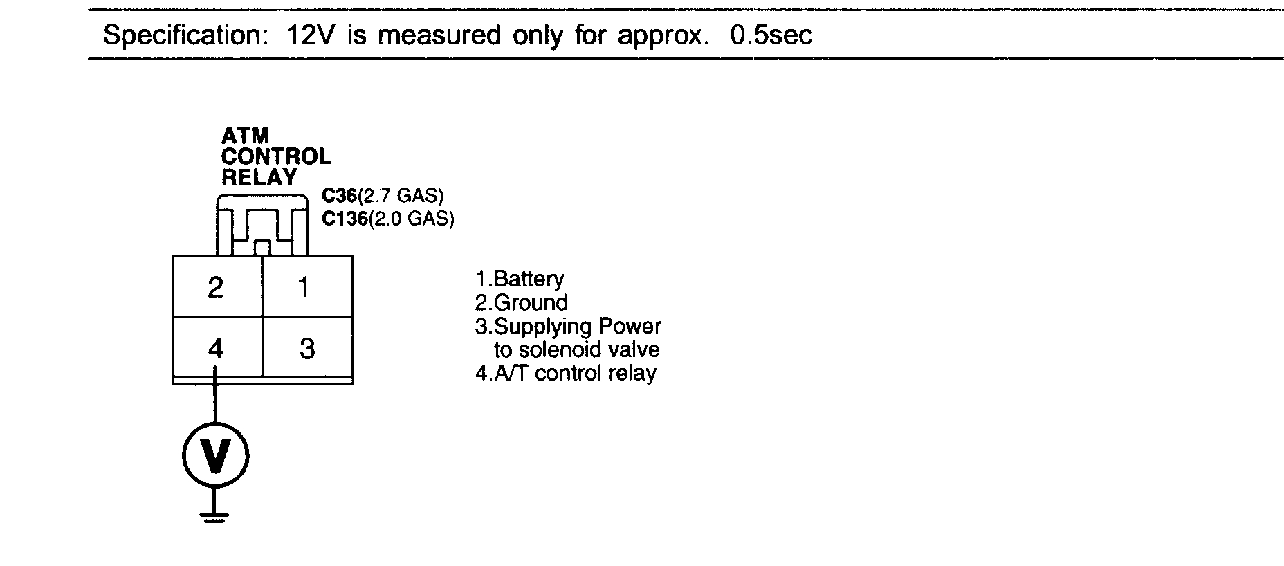

 1. CHECK A/T control relay harness
    1) Ignition OFF.
    2) Disconnect the A/T CONTROL RELAY connector.
    3) Measure the voltage between terminal 4 of the A/T CONTROL RELAY harness connector and chassis ground.
Specification
    4) Turn ignition switch OFF -ON.
       Specification: 12 Volts is measured only for approximately 0.5 seconds

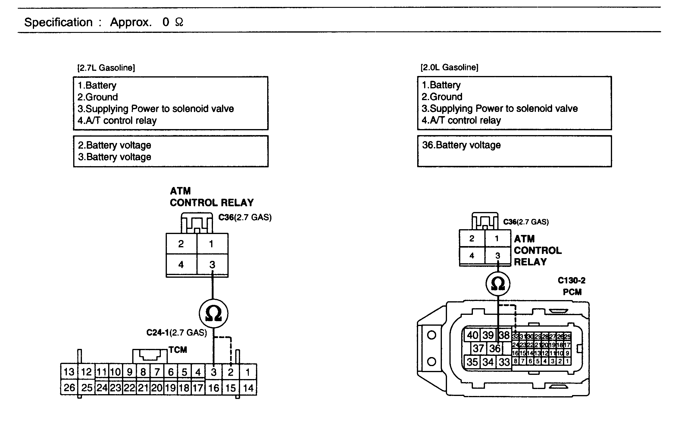

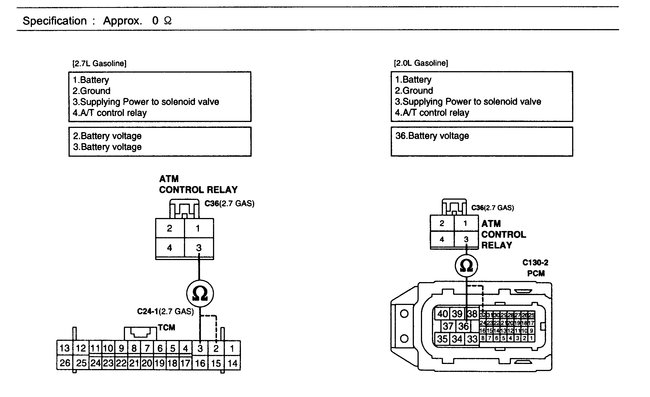

 2. CHECK Supplying Power to solenoid valve harness
    1) Ignition OFF.
    2) Disconnect the A/T CONTROL RELAY and PCM/TCM connector.
    3) Measure the resistance between terminal 3 of the A/T CONTROL RELAY harness connector and terminal 2, 3 of the PCM/TCM harness connector.
       Specification: Approximately 0 Ohms
    4) Is resistance within specifications?
       NO
       ^  Go to Ground circuit inspection procedure.
       ^  Check for Open in C-35 (2.7 GAS) joint connector.
       ^  Check for open in harness. Repair as necessary and Go to "Verification of Vehicle Repair" procedure.

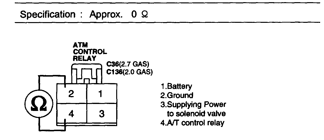

GROUND CIRCUIT INSPECTION
 1. Ignition OFF.
 2. Connect the A/T CONTROL RELAY connector.
Specification

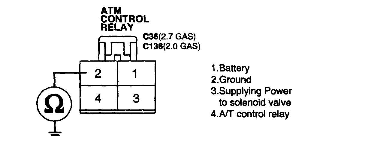

 3. Measure the resistance between terminal 2 of the A/T CONTROL RELAY harness connector and chassis ground.
 4. Is resistance within specifications?
    YES
    ^  Go to Component inspection procedure.
    NO
    ^  Check for open in harness. Repair as necessary and Go to Verification of Vehicle Repair procedure.

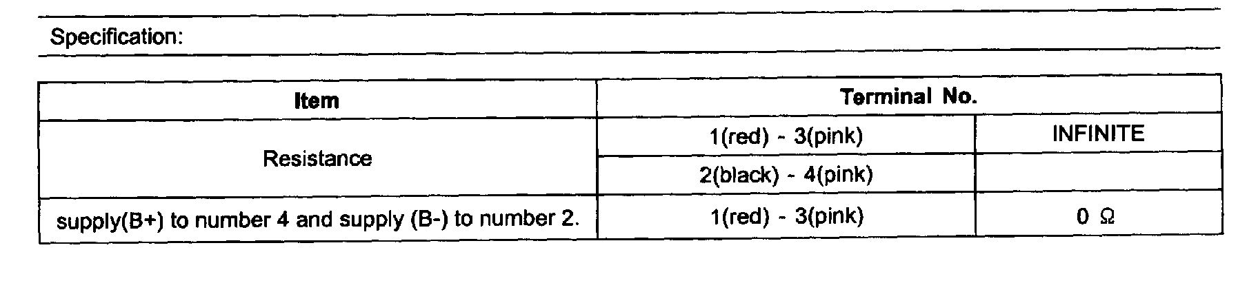

COMPONENT INSPECTION
 1. Ignition OFF.
 2. Remove A/T CONTROL RELAY
 3. Measure the resistance between each terminal of the sensor.
    Specification:
Specification
 4. Is resistance within specification?
    YES
    ^  Thoroughly check connectors for looseness, poor connection, bending, corrosion, contamination, deterioration, or damage. Repair or replace as necessary and then go to Verification of Vehicle Repair procedure.
    NO
    ^  Replace ATM CONTROL RELAY and then go to Verification of Vehicle Repair procedure.
