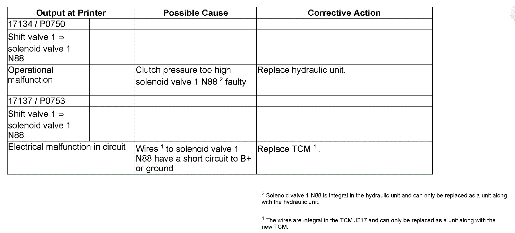

The code indicates there is either a short to battery voltage or a short to ground. Take a look at pic 1 below.
According to the code and description, the TCM needs to be replaced. The wiring is integral with the TCM and is replaced as a unit with the TCM.

According to my manual, if there is a short to power or ground, it's the TCM. I totally understand why you would be concerned. I'm sure it isn't cheap. But that's what I have.

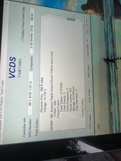

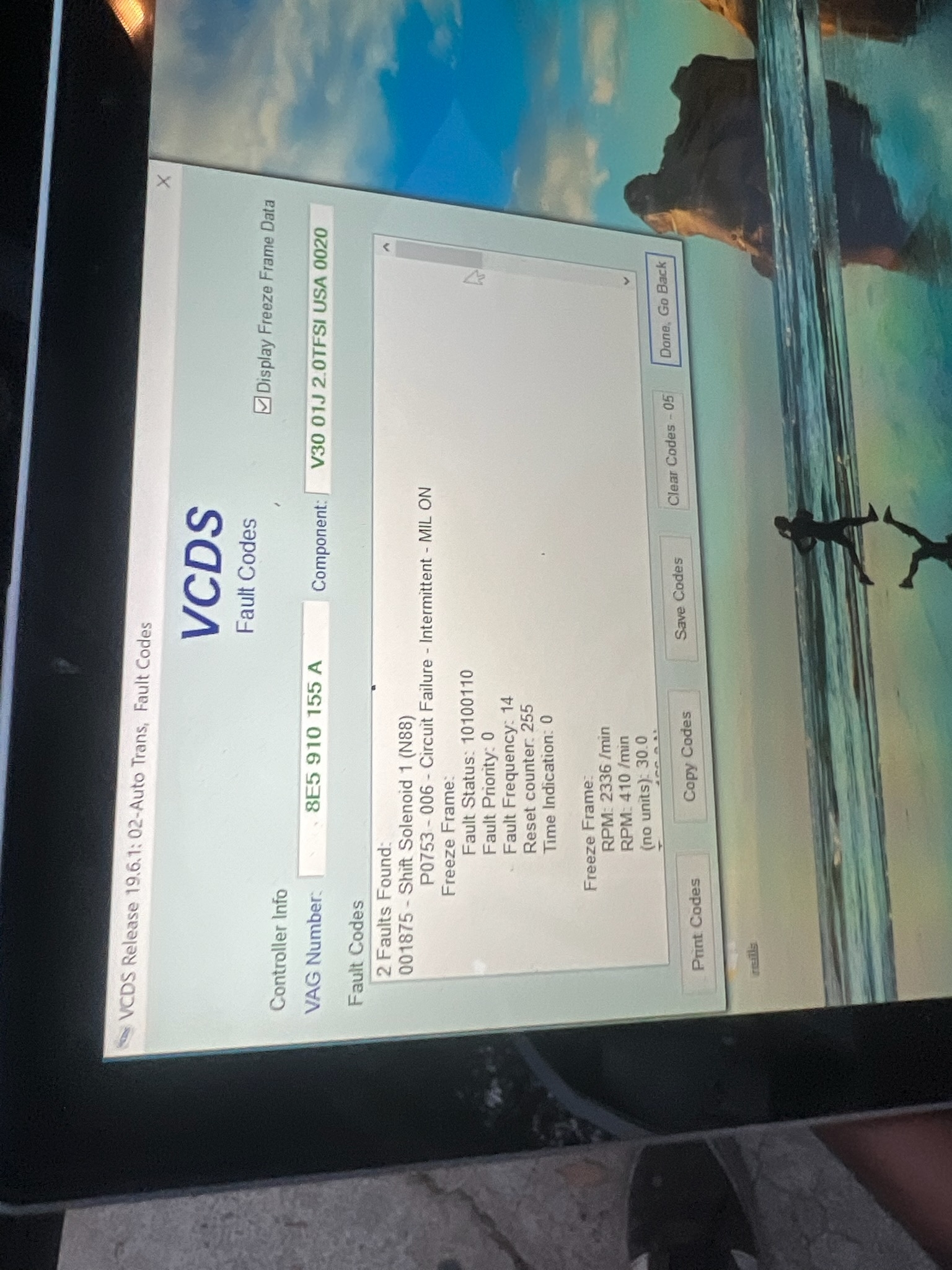

I'll post a pic of the DTC code. Just for reference. I'll update when I have any luck, lol. Thank you.

Hello, it's been a while. I have an update on the car. So, I replaced the N88 solenoid (solenoid A) on the valve body and again drained and filled the transmission oil as a result. The car originally wouldn't go into gear at all without stalling and now goes into gear with no jerking. Limp mode or the PRNDS light was still on for some reason. I don't know if I had to do a specific procedure after changing the solenoid, but fast forward a couple weeks later of turning the car on and running it, limp mode turned off, I reset the service light and erased the stored code and so far, so good. Hopefully it continues that way. Transmission shops would've quoted me a rebuild for a $50.00 part. Just some elbow grease and enduring the Southern California heat and saved hundreds of dollars. Thank you for the help and advice. I appreciate it.
