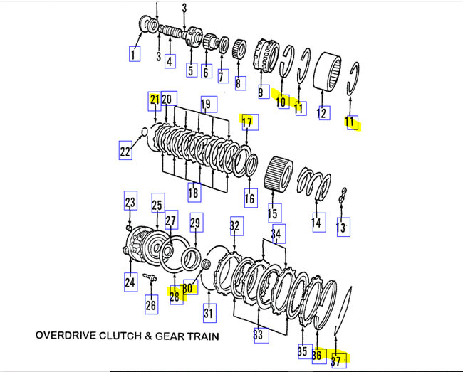

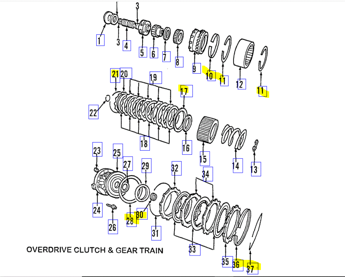

The OD unit can be removed from the rear of the transmission. However, how big was the broken ring you found? Does it look like a snap-type ring that would be used to secure clutch packs?
If possible, take a pic of the ring you found and upload it for me to see. If you look at the pic below, it's an exploded view of the OD clutch assembly. I highlighted different retainers, snap rings, and so on. Does what you found look like it could have come from one of these retainers?
See pic below.

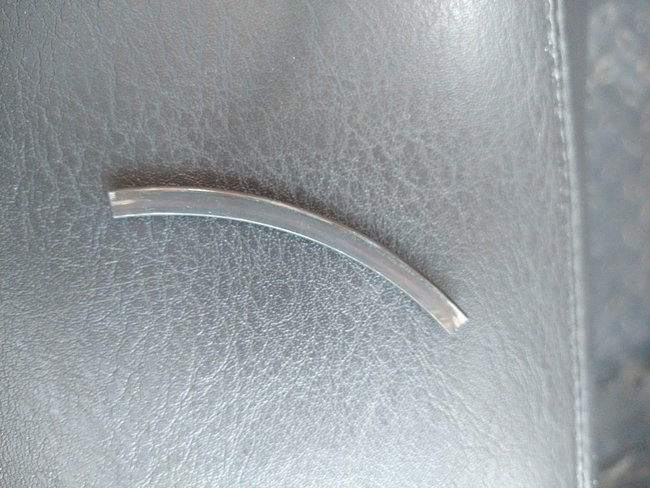

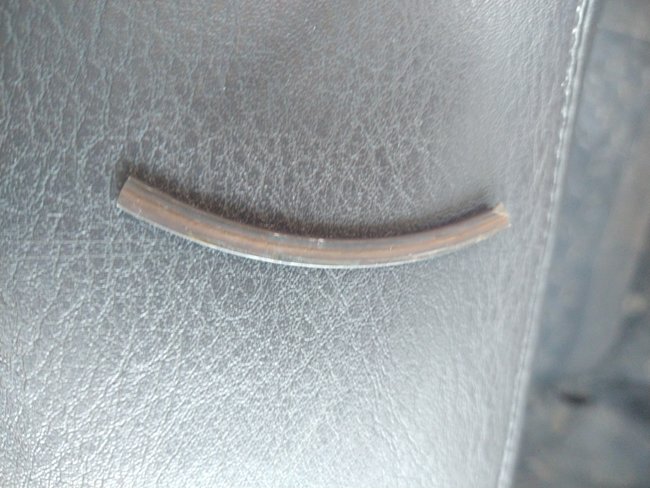

Thank you very much for your help. Here's an image of the broken ring found in the pan.
Any guidance you can provide for me I would be extremely grateful for!

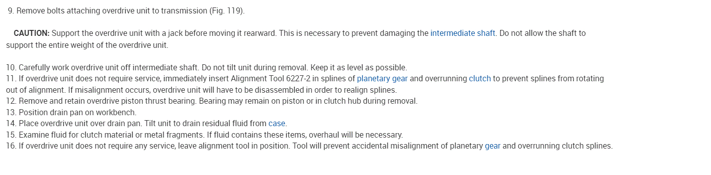

Looking at the pic, I believe you are correct. That appears to be a piece of a retainer and based on the code, chances are it is in the OD clutch assembly.
Before just replacing the sensor, the clutch pack assembly should be removed and inspected. However, because all clutch packs have different retainers, the sensor could be the issue and the broken retainer you found may have come from a different location.

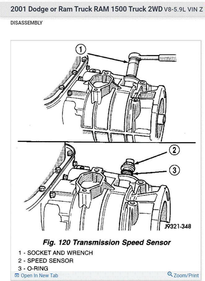

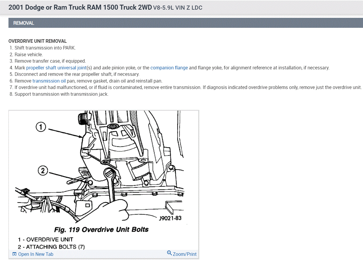

The only way to check is to remove the assembly. I attached three pics below showing how to remove the rear section exposing the components. Try this and check to see if there is any evidence of a problem.
If nothing is noticed, we have two choices. Remove the transmission and disassemble it to find the broken retainer or put the new sensor in and hope that it takes care of it. The broken retainer may still be holding things in place. However, that is going to be for a limited time
Let me know what you decide or if you have other questions. Additionally, if you want the entire disassembly procedure for the OD assembly, let me know. It is quite extensive.

You could save the fluid that comes out and reuse it. Just make sure the pan is clean. As far as the assembly, when you start taking the clutch and hub assembly apart, it becomes involved.
My biggest concern is that the part is from a different clutch pack and the solenoid itself may have at least temporarily taken care of the issue. The issue is it really needs to be identified and replaced before more happens. If nothing is found in the OD assembly, then the transmission needs to be removed, disassembled, and inspected. Which will be much more involved.
