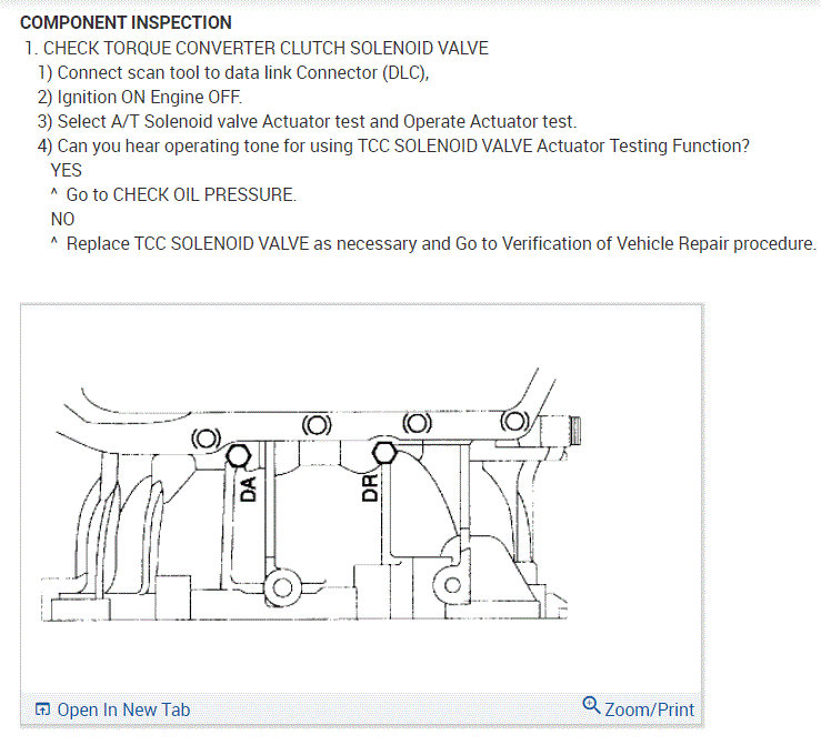

Code P0741
2006 HYUNDAI TUCSON
200,000 MILES • 2.0L • 4 CYL • AUTOMATIC
JOSEPH PAUL CORBETT-AMY CORBETT

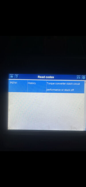

Intermittent shift problem.
Light comes on after a while.
Aug 16, 2021 at 5:01 AM
  • 110,240 POSTS

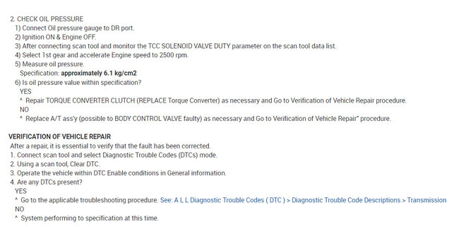

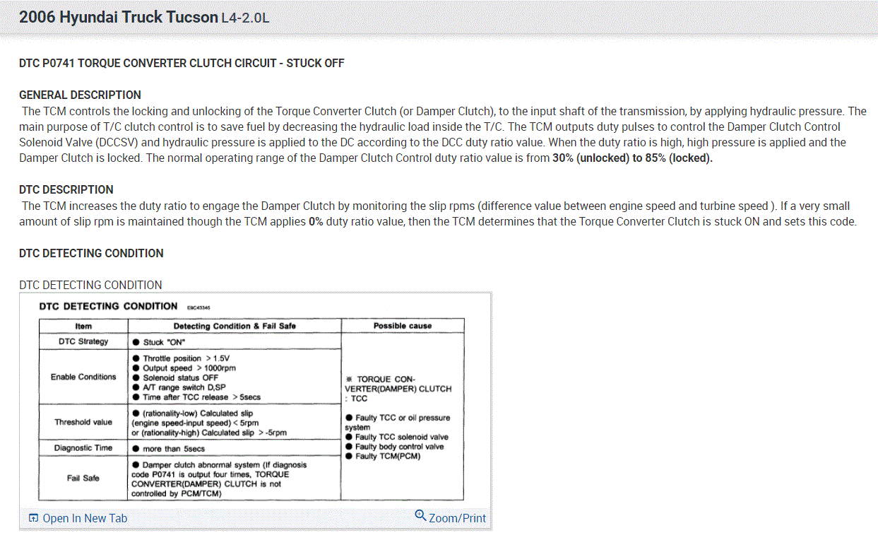

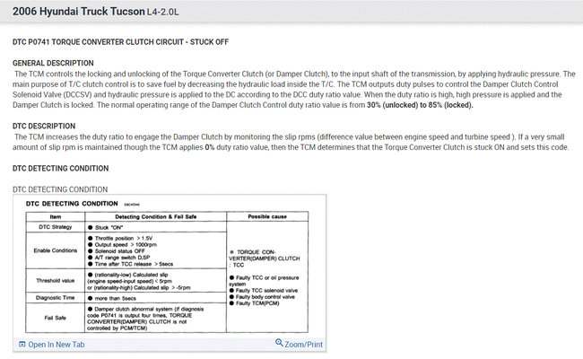

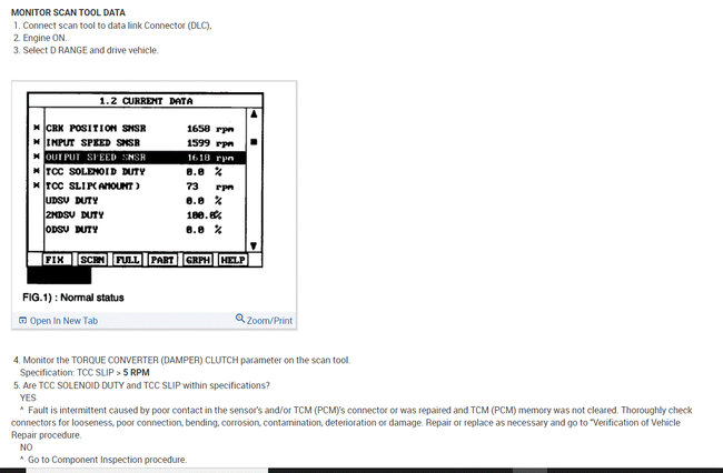

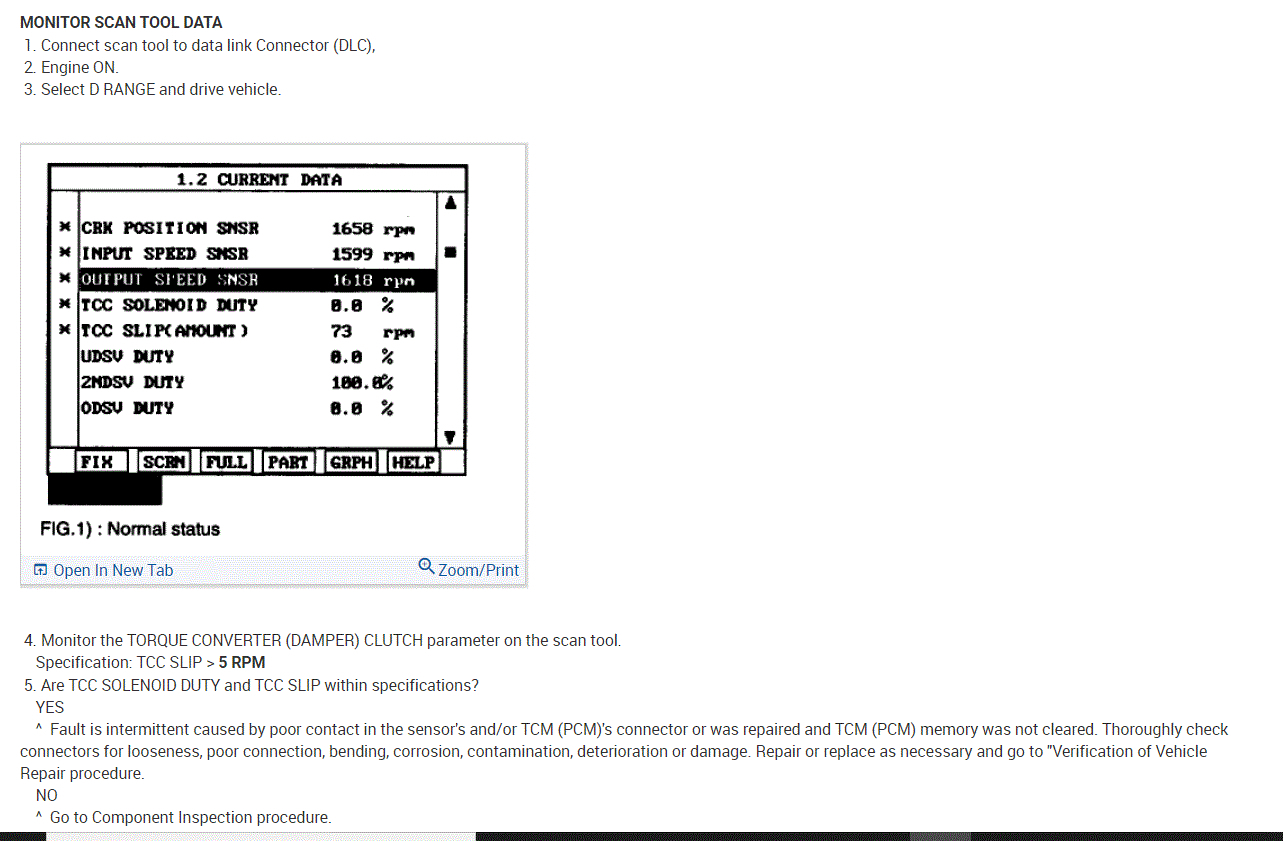

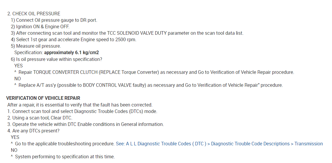

The code is related to the torque converter clutch. It is stuck in the off position. This could be a wiring issue, low line pressure, or the TCC clutch solenoid.
I attached directions below related to the code. The attachments include a description of the code and how to diagnose the problem.
