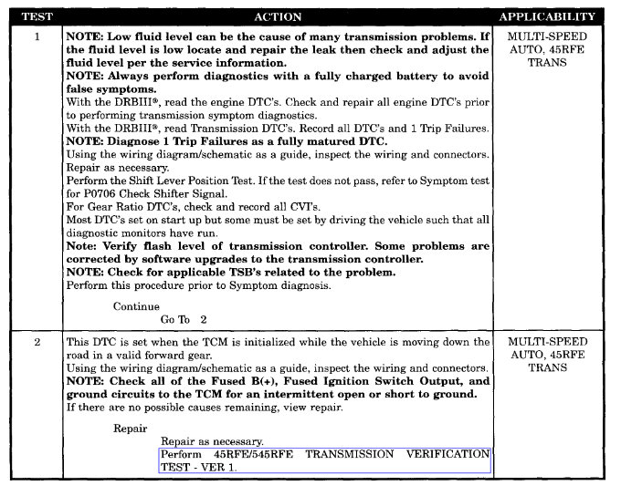

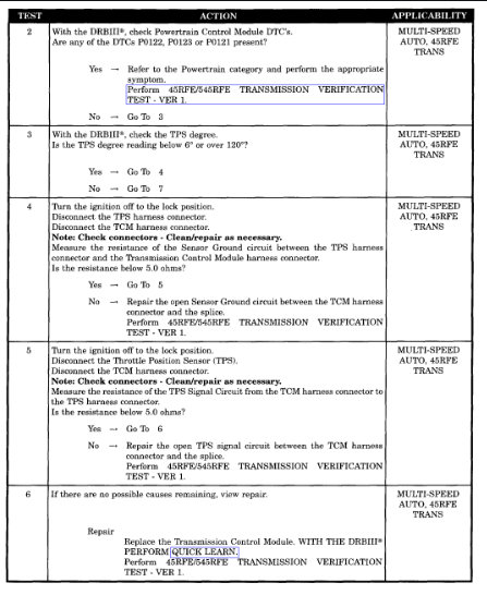

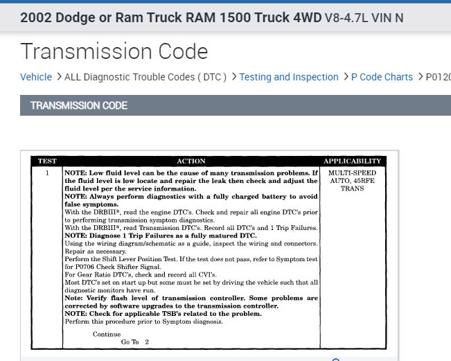

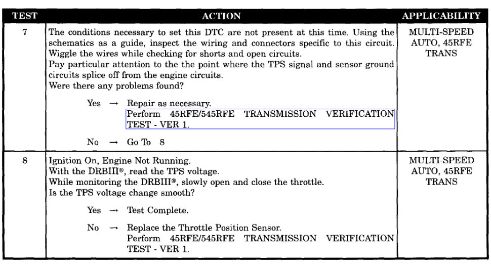

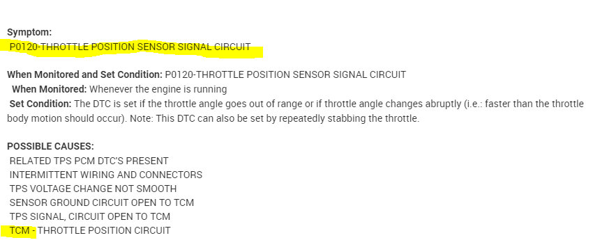

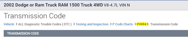

The throttle position sensor, P0120, is tied into the transmission. A signal from the TPS is used by the transmission control module (TCM) to determine engine load.
If you look at the first four pics below, they provide a description of the code and the diagnostics. Note, in all sections of the procedure there is no indication of transmission failure. Instead, there could be the need for a software update, a wiring issue, or a module issue.

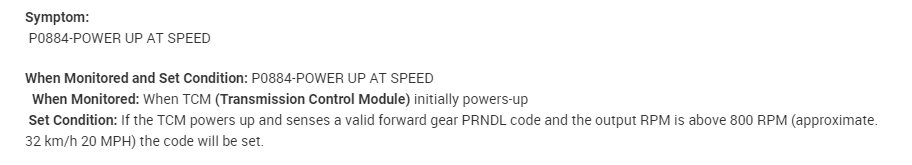

The last three pics are specific to the P0884. This is the specific transmission code. It indicates the TCM voltage input is intermittent. This is most likely a wiring issue and not the module. Again, this doesn't indicate the need to overhaul the transmission. If the transmission is overhauled and the electrical issue isn't addressed, it will continue doing the same thing.
Prior to all of this happening, were there any transmission issues you remember?
