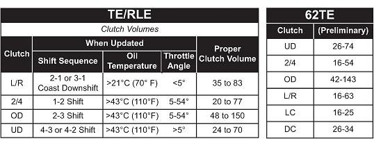

Driving down the highway and it just went to neutral. No forward or reverse. Cleared engine code. It got low back. But if it shifts into second, that's it. It quits pulling and locks in second until you clear the code. Now I pulled the pan and then the valve body. Transmission looks good inside. No degree in pan or filter. All valves in valve are free and no bad valve bores. Reassembled. Added ATF +4. Same problem. Took solenoid assembly apart and cleaned. Ohms checked all solenoid. (300.5 ohms). And last of all. Got schematic wiring of complete system, and got to check the L/R switch through voltage readings and appears to be functioning. Can't check other two switches because of the transmission not getting into those gears. What next?

P0732 - Gear 2 Incorrect ratio
This is typical of a slipping clutch pack. There's two common causes of that. The first is a cut rubber lip seal on the piston. The more common cause of that is worn fiber plates in the clutch pack. The way to identify that is by reading the "clutch volume index", (CVI). I use a Chrysler DRB3 scanner for my vehicles. I suspect other high-end scanners will do that too.
This chart applies to one version of transmission in your van. Pay particular attention to the volumes for the low / reverse clutch and the 2 / 4 clutch. If you find a CVI value close to the maximum listed, it's time for a rebuild.
The CVIs are calculated by watching the input speed sensor and output speed sensor signals to determine when one clutch pack releases and the next one locks up. The time it takes is used to make that calculation. One trick that often works to verify a clutch pack is taking too long to lock up is to accelerate harder than normal to cause a delay in an up-shift, then release the accelerator pedal long enough to let that up-shift occur under low torque. That will reduce the slippage so it won't be detected, and won't go into limp mode. That can allow you to get into the higher gears, but it only delays the inevitable for a few days or weeks. The rebuild is the permanent fix.

What does the "Preliminary" CVI on the 62TE mean? My L/R shows and out of spec 68 CVI when the van is driving. Van drives perfectly.

"CVI" is "clutch volume index. That is a two-digit number that corresponds to the volume, in ccs, of fluid it takes to apply each clutch pack. My training goes back to the '89 models that were four-speed computer-controlled transmissions. Chrysler was the first to introduce them, as they were for most innovations that benefitted car owners. Today every manufacturer has their own versions.
With the older hydraulically-controlled automatic transmissions that were around since the '50s, as the clutch plates wore down, it took more and more fluid to apply those clutch packs. As that occurred, we observed a little "engine runaway" during upshifts, meaning it was like the transmission went into neutral for a fraction of a second. That slippage gave us up to two or three years notice that a rebuild was in its future.
One of the advantages of the computer-controlled transmission is the computer continually learns those volumes of fluid it takes to apply the clutch packs, and as the plates wear, it takes more and more fluid. Based on those updated values, the computer will turn on second gear, for example, a little sooner, before it releases first gear. That overcomes engine runaway and makes for a nice crisp shift just like when the vehicle was new, . . . until the day comes when it can't update any further. Once that day comes, you had a nice solid shift yesterday, but today the excessive slippage gets detected and the computer puts the system into "limp" mode to allow you to drive slowly to a repair shop without needing a tow truck. The wear has been taking place for years, just like before, but you don't get the few years of warning like before.
Two speed sensors are involved with this slippage. One is the input speed sensor which is after the torque converter, and the output speed sensor on the tail shaft. The Transmission Computer has the gear ratios for each gear programmed in. Based on that and the gear it is in, it knows for a given input speed, the output shaft had better be going its calculated speed. It knows there's excessive slippage in a clutch pack when those two speeds don't agree. When excessive slippage occurs, besides going into limp mode, it will set a diagnostic fault code for, "incorrect gear ratio" for the specified clutch pack.

Thank you for the very detailed explanation. I appreciate that. I will take your advice and post my own question. I am in the early learning stages about automatic transmissions. What limited reading I've done informed me about some of what you covered. I did read about CVIs and I think I have a basic understanding of those. What I didn't, and still don't understand is why the specs for CVI values for the 62TE state "preliminary". Other Chrysler transmission model specs that I've seen just give a low and high range for CVI values. I will include the details in my question, but my van is a 2013 Chrysler Town and Country with ~ 150000 kms on it, 3.6L Pentastar engine. I bought it about a month and a half ago. Since acquiring the van I have replaced all of the fluids including extracting 4L of ATF+4 and replacing, a week later dropping the pan and replacing the filter and pan with a drain plug (added ~5.5L, ATF+4). I have the temp/level chart and I am just shy of the max range. The van drives perfectly with smooth shifting. I was just trying to figure out why my L/R CVI seemed out of spec. All other CVIs are within range and line pressure (desired and actual) are always in agreement. I am aware of some of the potential issues with the 62TE and have watched all of Gary Ferraro's youtube vids on the transmission. Once again, thank you for the detailed summary. I learned a lot from it.

I too have never seen the designation, "preliminary" What I can share is any time the battery is disconnected, those learned CVI values are lost. The computer reverts back to the initial starting values programmed in at the factory, then it could shift like a race car for the next two miles or dozen shift cycles until it relearns that data.
