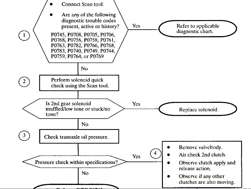

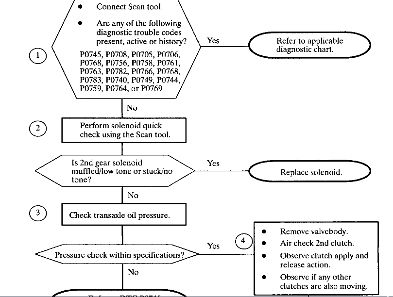

No reverse unless cold,
Hard shift into second.
How can i tell if its a clutch pack or a solenoid?
Pulled code p0732.

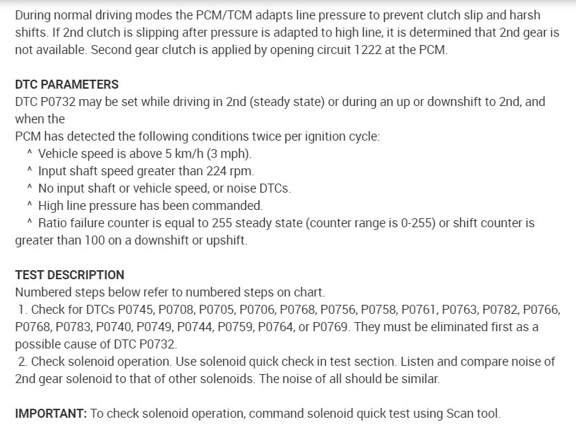

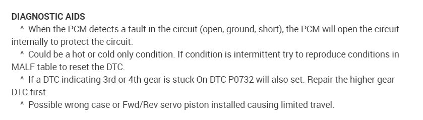

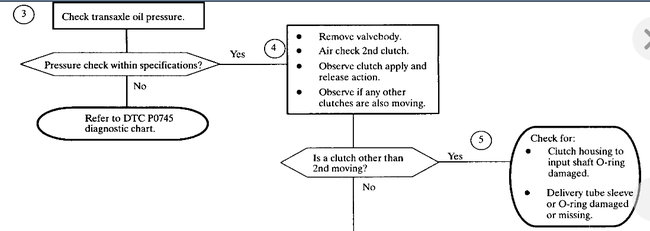

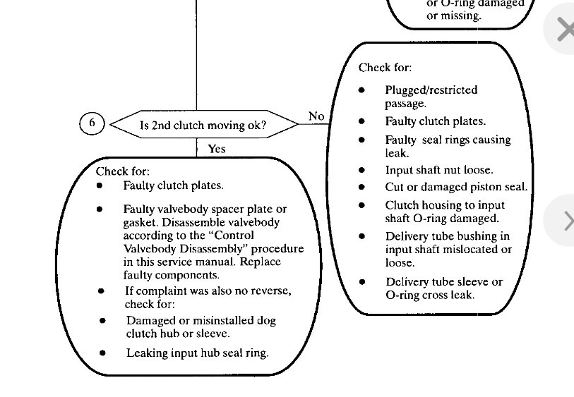

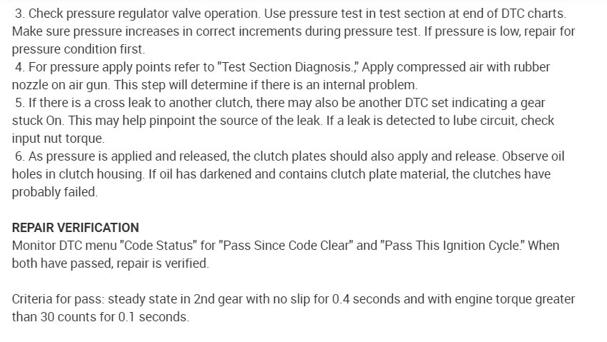

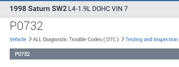

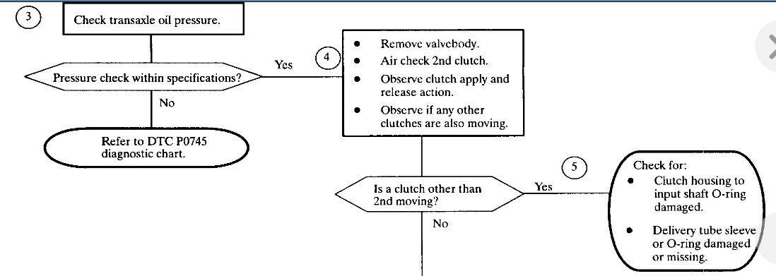

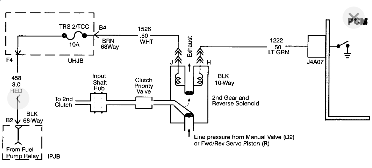

This Direct Trouble Code (DTC) is a problem with second gear in your vehicle's transmission. It can be while you are driving in second gear or shifting into or out of second gear as well. The way that you can tell if it is a clutch pack or a solenoid is to go through the factory troubleshooting flowchart that I have included for you in the diagrams down below. Please get back to us with what you find out.
Thanks,
Alex

JOHNSTON COREY
Okay, i wasn't specific enough. is there a way before you pull valve body off? I am thinking by what i have read and troubleshot its the solenoid. Which is something i think i can reasonably fix. Clutch pack on the other hand is something i would take to a repair shop or sell car. I have jeeps, have replaced just about everything but, once it gets to inside the transmission i leave it to a professional. Thanks for the information, going to pull valve body and test solenoid. Darn auto correct wont give me the same spelling of solenoid twice. Lol. Thanks for the diagram.
Mar 28, 2019 at 8:47 AM

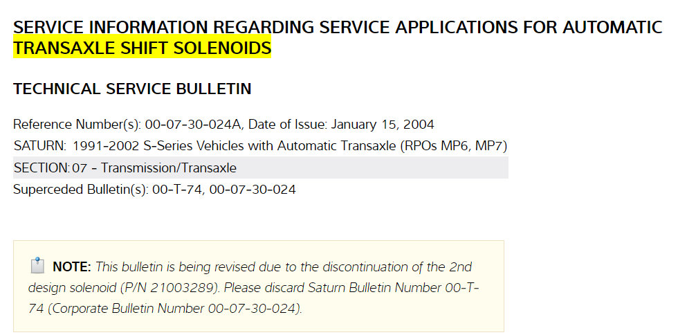

SCGRANTURISMO
  • 4,897 POSTS

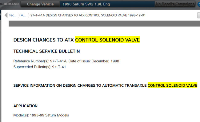

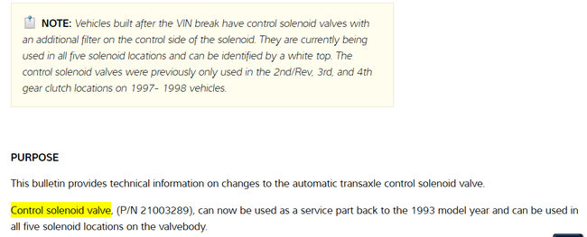

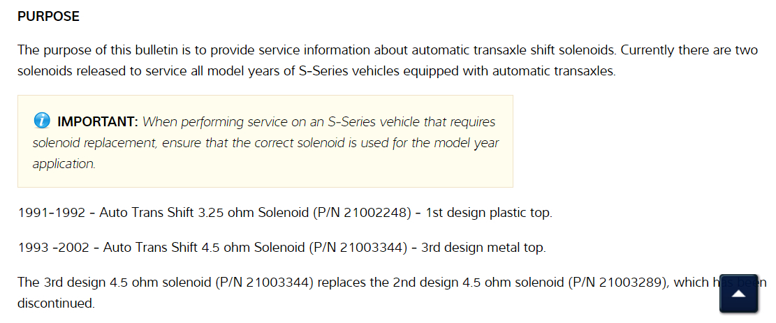

Hello again,

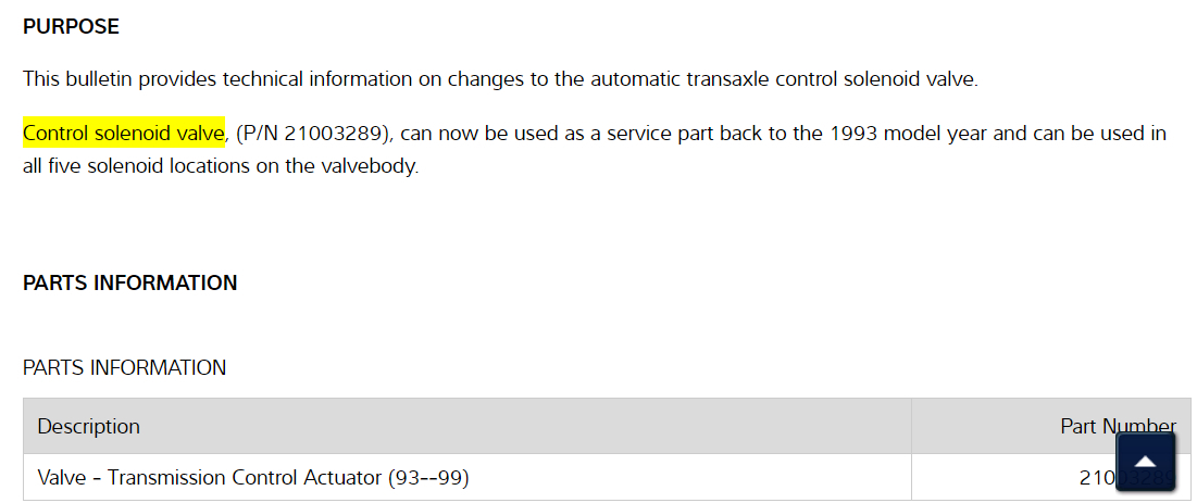

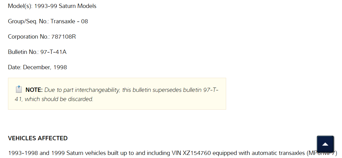

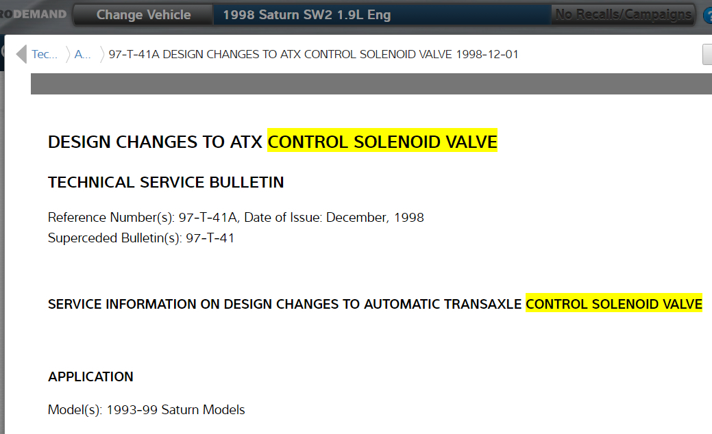

I was able to find these Technical Service Bulletins (TSB)(s) which might be of interest to you. I have included them in the diagrams down below for you.
Thanks,
Alex
2CarPros
