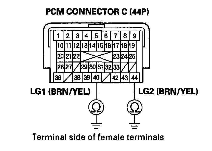

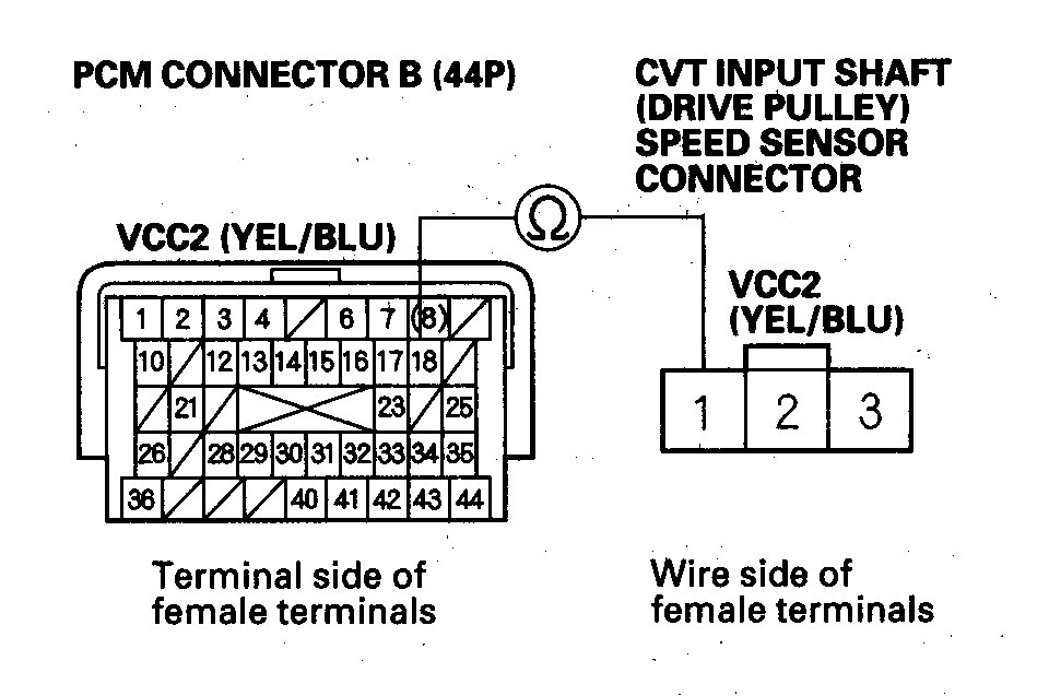

P0717 codes, shifting problem, D light flashing.
I do not know which pick-up sensor to replace. Speedometer sensor 28810-PCJ-014 or
Vehicle Speed Sensor 28810-P7W-004. I think there are two of each type on the CVT transmission. I only found one each so far. I replaced one of the 28810-PCJ-014 (short) sensors but problem came back. See:
https://www.hondapartsnow.com/parts-list/2008-honda-civic-4dr_mx_hybrid-ka-cvt/transmission-case.html
Dec 4, 2018 at 4:50 AM
  • 110,248 POSTS
This is not a sensor issue. It is a circuit. I am going to provide the diagnostic flow chart to help you find what is causing the problem. All attached picture correlate with these directions. Also, you will need a good scanner/live data/freeze frame abilities.
_____________________________________
DTC P0716: Range/Performance Problem in CVT Input Shaft (Drive Pulley) Speed Sensor Circuit
DTC P0717: Problem in CVT Input. Shaft (Drive Pulley) Speed Sensor Circuit (No Signal Input)
NOTE:
^ Before you troubleshoot, record all freeze data and any on-board snapshot with the HDS, and review General Troubleshooting Information.
^ This code is caused by an electrical circuit problem and cannot be caused by a mechanical problem in the transmission.

7. Turn the ignition switch to LOCK (0).
8. Jump the SCS line with the HDS.
9. Disconnect PCM connector C (44P).
10. Check for continuity between PCM connector terminal C40 and body ground, and between PCM connector terminal C44 and body ground.
See pic 1
Is there continuity?
YES - Go to step 11.
NO - Repair open in the wires between PCM connector terminals C40, C44, and ground (G101), or repair poor ground (G101), then go to step 28.

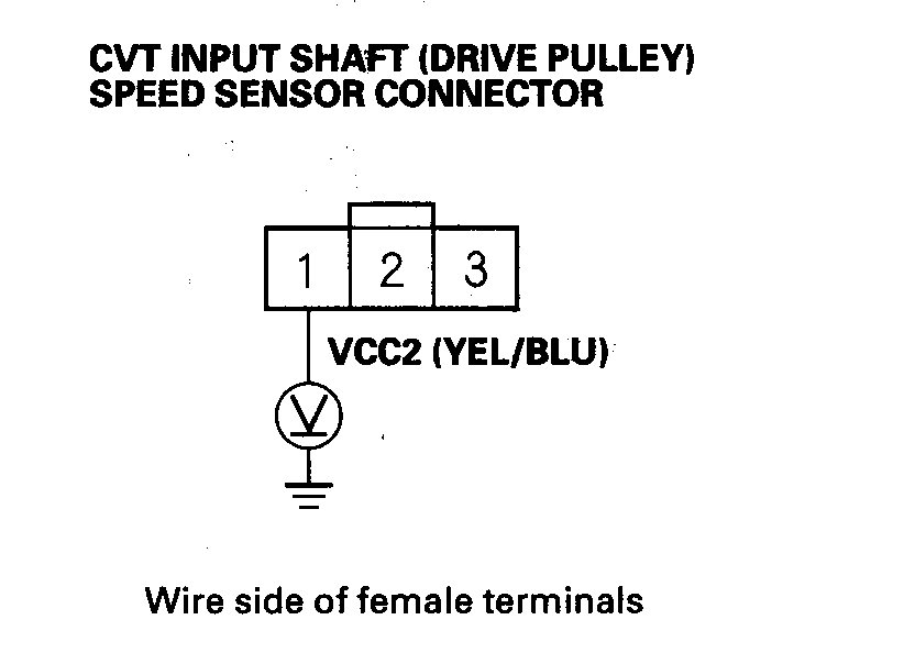

11. Connect PCM connector C (44P).
12. Disconnect the CVT input shaft (drive pulley) speed sensor connector.
13. Turn the ignition switch to ON (II).
14. Measure the voltage between CVT input shaft (drive pulley) speed sensor connector terminal No. 1 and body ground.
See pic 2
Is there about 5 V?
YES - Go to step 18.
NO - Go to step 15.

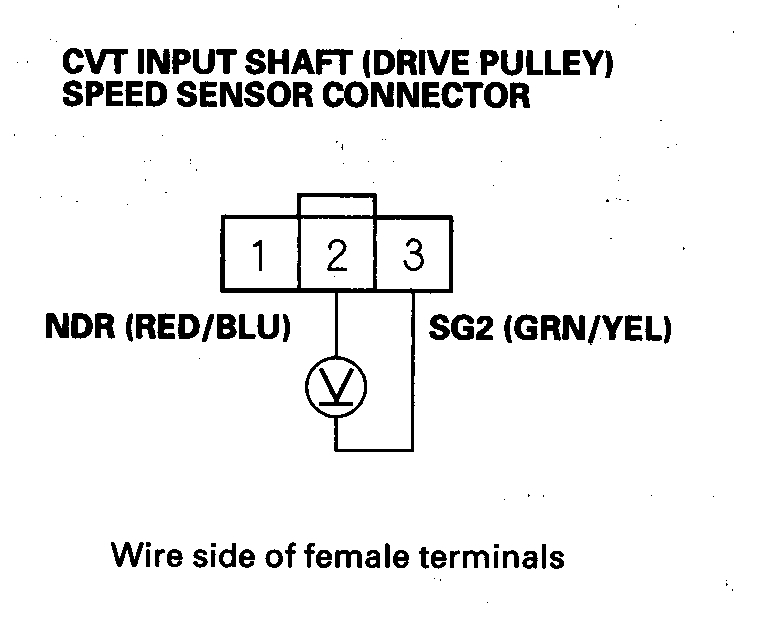

15. Turn the ignition switch to LOCK (0).
16. Disconnect PCM connector B (44P).
17. Check for continuity between PCM connector terminal B18 and CVT input shaft (drive pulley) speed sensor connector terminal No. 1.
See pic 3
YES - Go to step 34.
NO - Repair open in the wire between PCM connector terminal B18 and the CVT input shaft (drive pulley) speed sensor connector, then go to step 28.

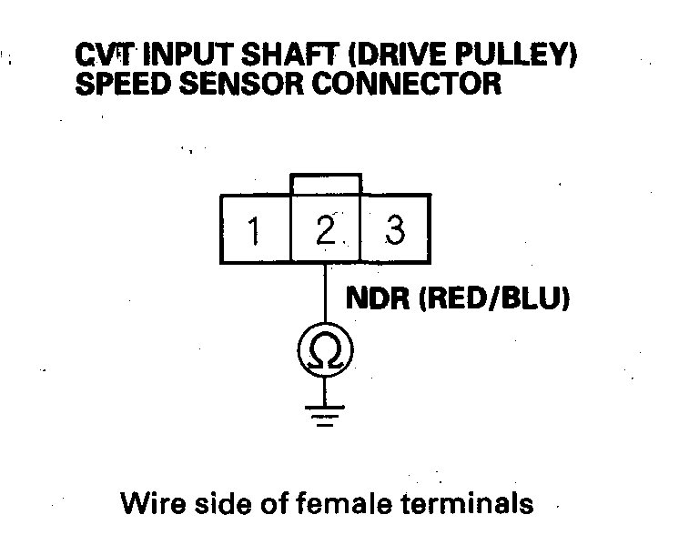

18. Turn the ignition switch to LOCK (0).
19. Disconnect PCM connector B (44P).
20. Check for continuity between CVT input shaft (drive pulley) speed sensor connector terminal No. 2 and body ground.
See pic 4
YES - Repair short to body ground in the wire between PCM connector terminal B17 and the CVT input shaft (drive pulley) speed sensor connector, then go to step 28.
NO - Go to step 21.

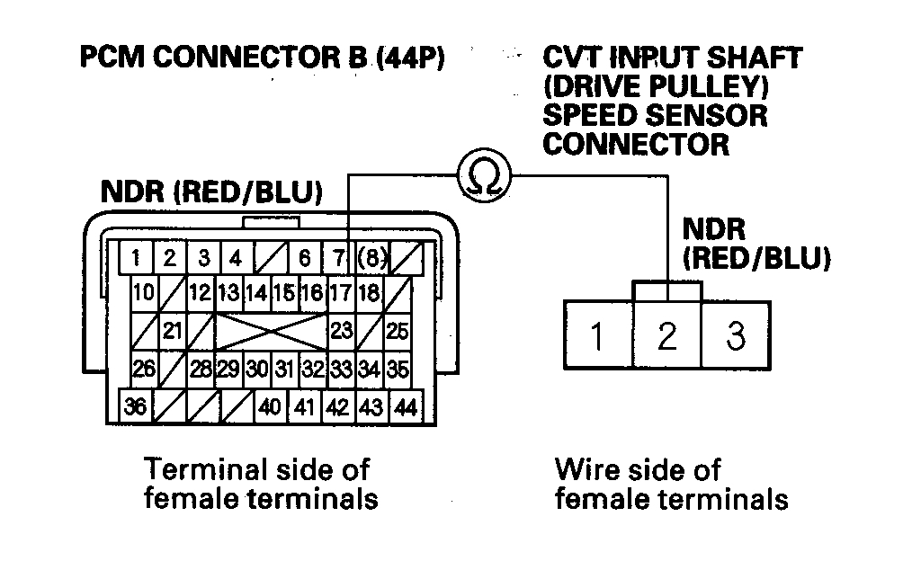

21. Check for continuity between PCM connector terminal B33 and CVT input shaft (drive pulley) speed sensor connector terminal No. 3.
See pic 5
YES - Go to step 22.
NO - Repair open in the wire between the CVT input shaft (drive pulley) speed sensor connector and PCM connector terminal B33, then go to step 28.

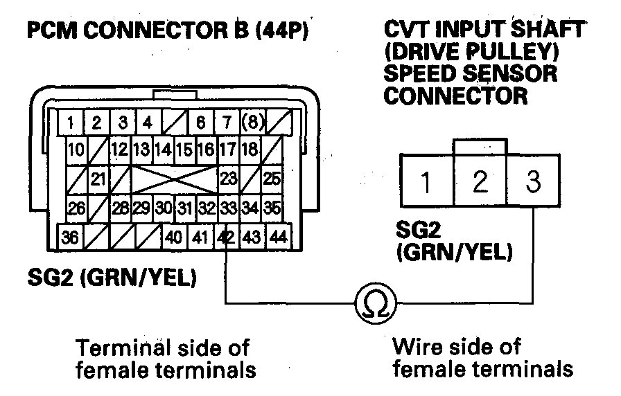

22. Connect PCM connector B (44P).
23. Turn the ignition switch to ON (II).
24. Measure the, voltage between CVT input shaft (drive pulley) speed sensor connector terminals No. 2 and No. 3.
See pic 6
Is there about 5 V?
YES - Go to step 28.
NO - Go to step 25.
