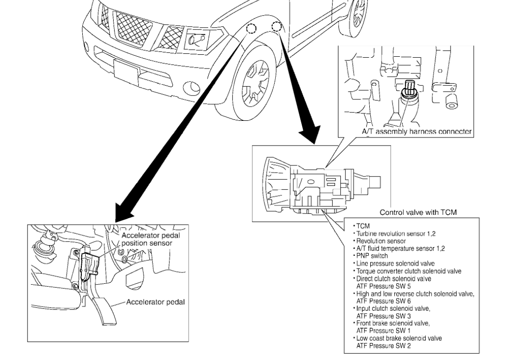

My car has a P0717 and a P0301 code. I replaced the TCM valve body and the output speed sensor. I'm still getting the p0717 code and the car shifts fine up to 3rd gear but will not go past that. Just revs very high to build speed. Close to 5 rpms at around 80 mph. Please help!

Here are the codes:
P0717 - Input/Turbine Speed Sensor Circuit No Signal:
P0301 - Cylinder 1 Misfire Detected:
We handle one problem per thread so this thread will will fix the P0717

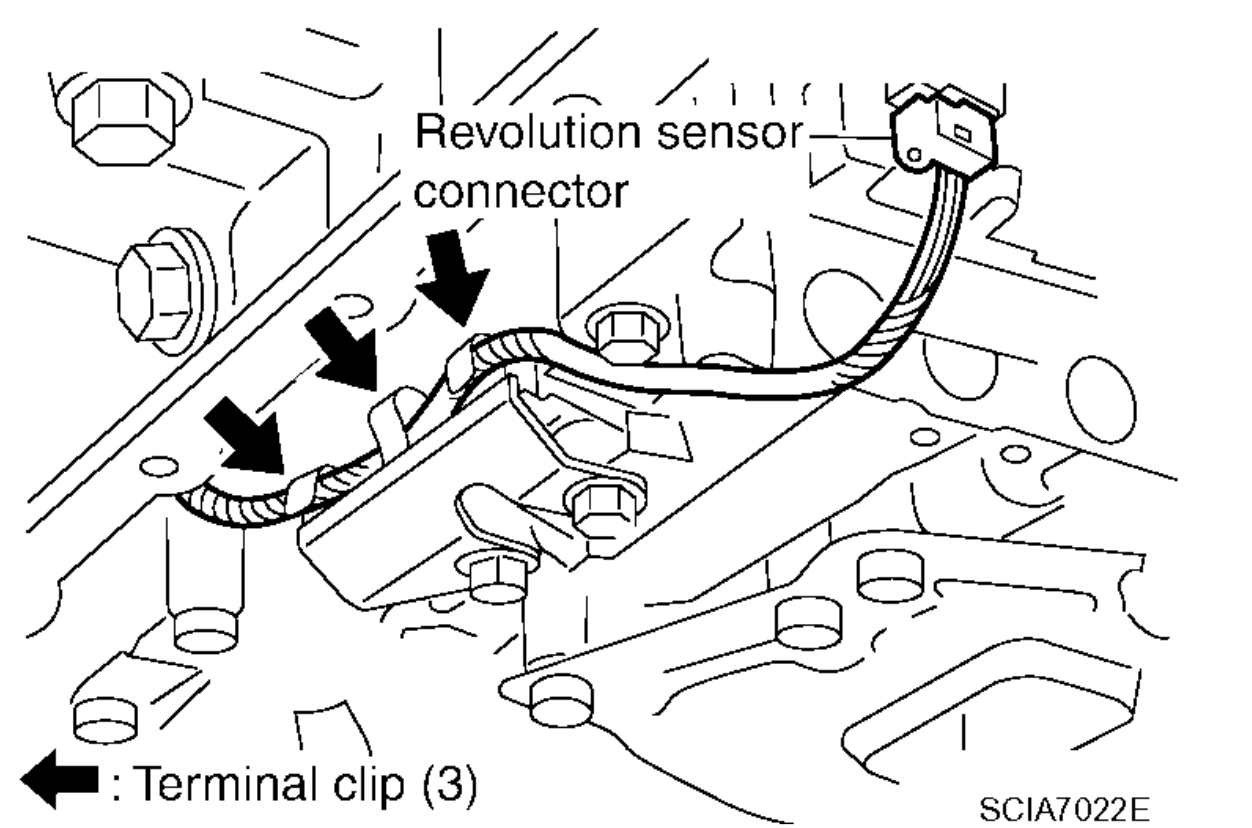

Here is the location so you can check it out. I would check the condition of the wiring as well. Check out the images (Below). Please let us know what happens.

Unfortunately, I replaced the output revolution sensor in the diagram and the TCM module which has the input turbine speed sensor on it. I still have the same issue. Any other suggestions?
