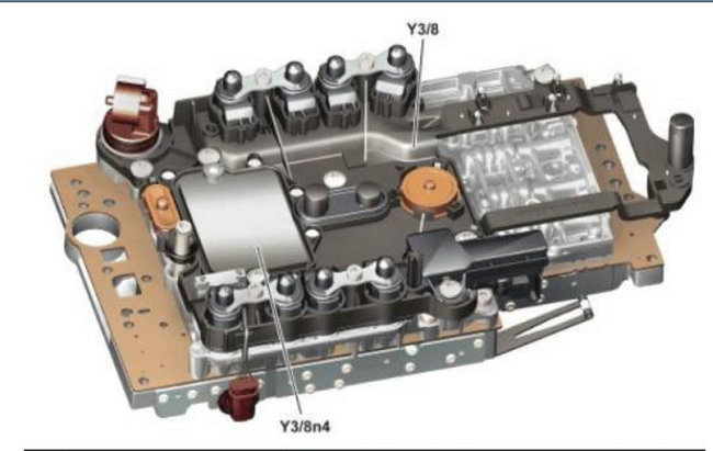

The car shows drive but I know the car is in neutral because I might be going 60 mph and the car would just rev for a second and then go back into gear. This only happens rarely and can’t tell exactly when will it happen again. Do you know where the range sensor is located?
Feb 4, 2020 at 12:51 PM
  • 110,240 POSTS
This vehicle has a fully integrated transmission control unit. It is in the transmission. It isn't something you want to try and find it isn't the problem. It isn't cheap. I attached a pic of it.

I don’t think the conductor plate is defective. I have seen other Mercedes with a conductor plate issue where the car would go into limp mode and won’t go higher than second gear. My car shifts fine into all 7 gears it has and doesn’t go into limp mode. It just throws the code and turns the check engine light on. I’m not sure if a bad trans fluid would cause this issue.
Feb 5, 2020 at 12:51 PM
  • 110,240 POSTS
The idea that it jumps to neutral is certainly a concern and understand why you want it repaired. I have a feeling it could be related to the sensor I mentioned or even the the control module. Both of these will require extensive diagnostics.
Feb 5, 2020 at 1:08 PM

I am currently replacing the transmission fluid and filter. My technician took out the solenoid that the car was saying is defective. He said there is nothing wrong with the solenoid and it’s functioning properly. He’s telling me the conductor plate might be defective but told me to wait before replacing that. I don’t think it’s the TCM as the car never went into limp mode and it shifts into all its gears fine.

JITHIN MATHEW
  • 71 POSTS
Hello Daniel,
I fixed the code 30,000 miles ago and the car is going great. The code is set because the speed sensor built into the tcm has failed. Only way to fix it is by replacing the tcm and having it reprogrammed with Mercedes xentry. I gave it to a Mercedes independent shop to do it. After the new one was installed my car wouldn’t accept the new programming, so the independent shop towed my car to a Mercedes dealership, and they figured it out.
