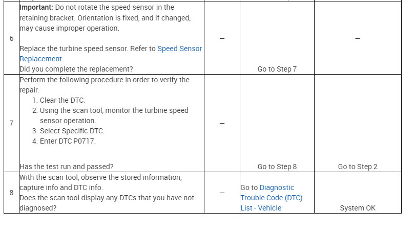

My truck is throwing codes po700 po717 and it shifts first to second hard but then third to fourth it has a slipping shift and also makes a funny sound coming from the dash or under the hood. Then fourth to fifth it would slip 3 or 4 times before catching. Where do I start? Cause I also heard that the alternator could be the problem.
Jun 15, 2022 at 12:50 AM
SQM
  • 6,383 POSTS

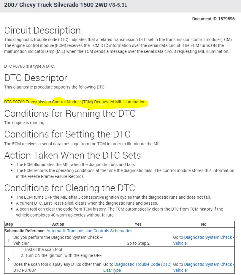

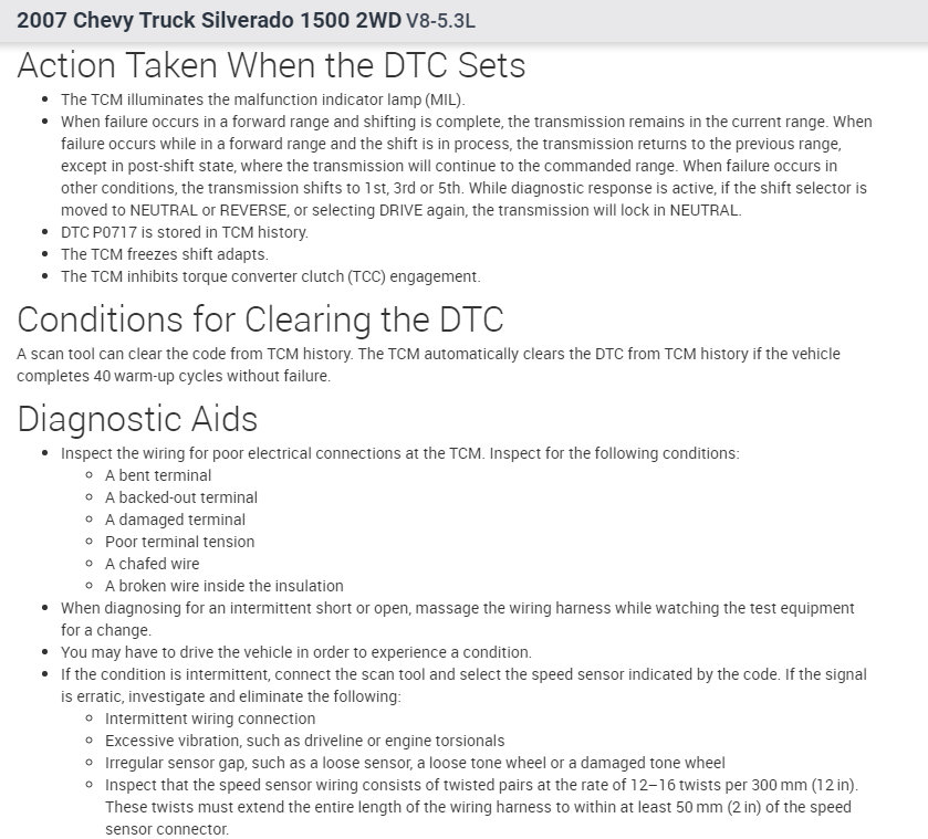

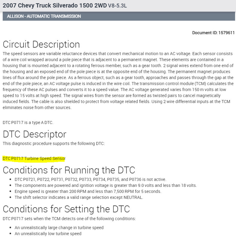

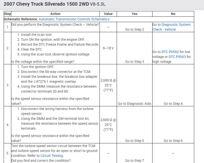

The code P0717 gets triggered for the turbine speed sensor and the P0700 is a general transmission diagnostics code for when there is an error code present.
The turbine speed code could be due to a faulty sensor or possibly wiring issue.
I have attached the troubleshooting guide for the code below.
Follow the steps as it can help you determine the issue.
Let me know what you find or if you have any questions.
