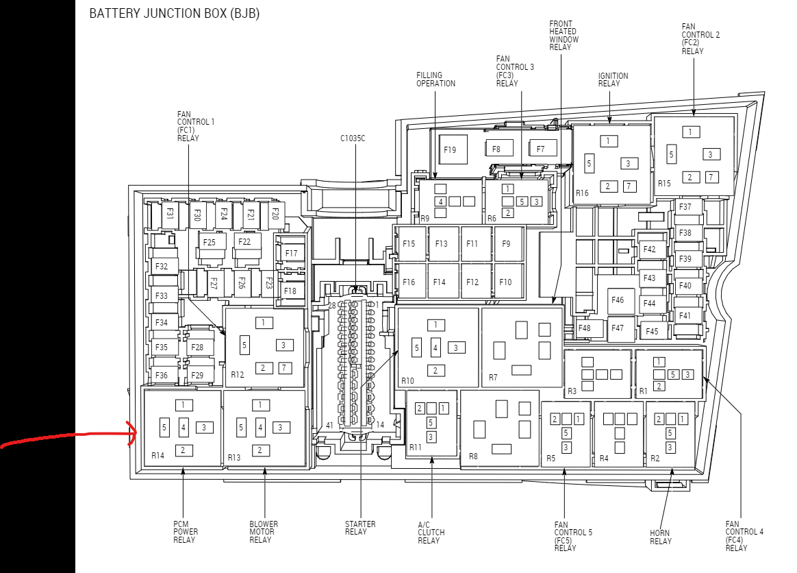

Any idea what this can be related to?
Nov 2, 2022 at 11:50 PM
  • 55,721 POSTS
P068A is a generic trouble code that says “ECM/PCM Power Relay De-Energized Performance – Too Early. Which is usually caused by the PCM power relay malfunctioning, I would remove it and get a new one then clear the codes. Here is the location of the relay in the images below. Let me know what happens.

You may have a bad PCM please let me know what you find. We are interested to see what it is.
