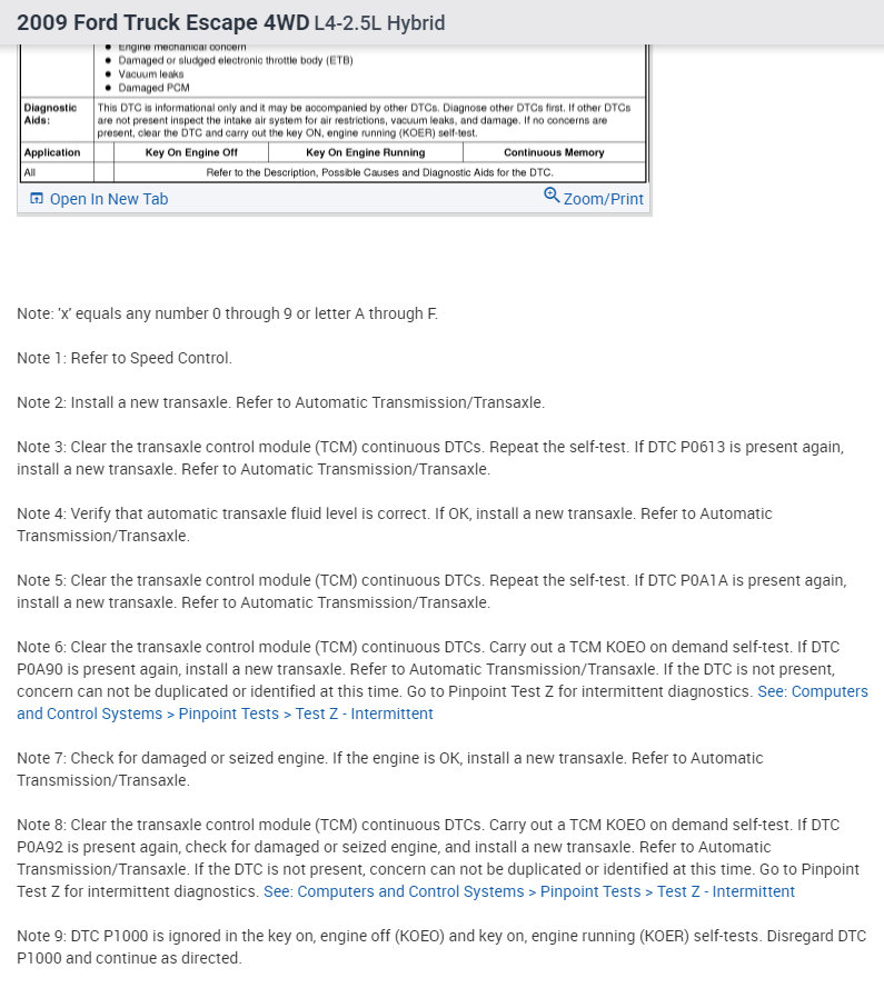

Hello, today check engine light came on, there is only one dtc P050E Cold Start Engine Exhaust Temperature Too Low. Car runs and drives great, i cleared dtc but it came on about two weeks later.
Jan 10, 2022 at 8:47 PM
SQM
  • 6,383 POSTS

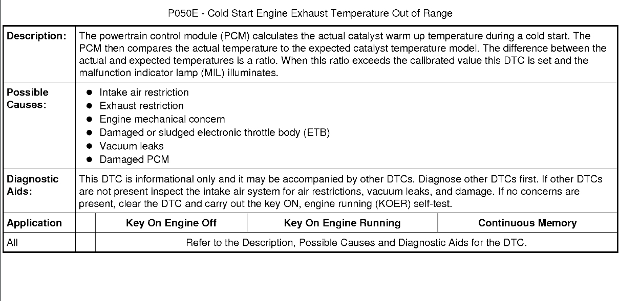

The code P050E can get triggered due to several factors.
It could be because of intake air restriction, exhaust restriction, dirty throttle body. It can also get triggered for vacuum leaks.
The best course of action would be to take a look at each possibility and take appropriate action.
I have attached the trouble shooting guide for the code P050E below. Go through those steps as it can help you determine the issue.
