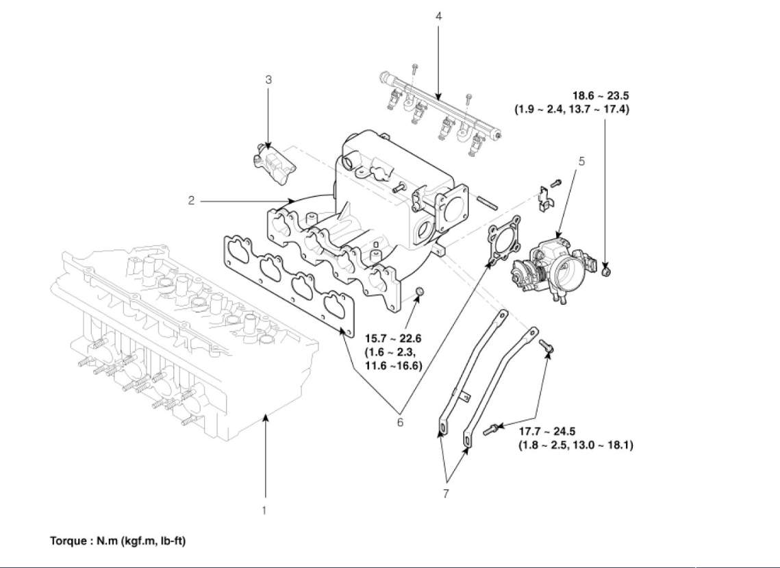

Hi, I have just purchased a new car listed above. The engine light is on, and I have done a scan and is coming up with the p0507 code. What do you recommend doing to fix this code? Thank you for your time.
Dec 30, 2022 at 3:30 AM
  • 55,412 POSTS
The P0507 code means the idle control is too high which can be a vacuum leak, or the throttle body needs to be serviced. Here are three guides to help fix the problem with instructions for your car in the images below.
https://www.2carpros.com/articles/engine-idles-too-high
This guide will help you step by step to do the service for the throttle bore:
This guide do only when the engine is cold:
Clear the codes when the job is complete. Check out the images (below). Please let us know what you find. We are interested to see what it is.
