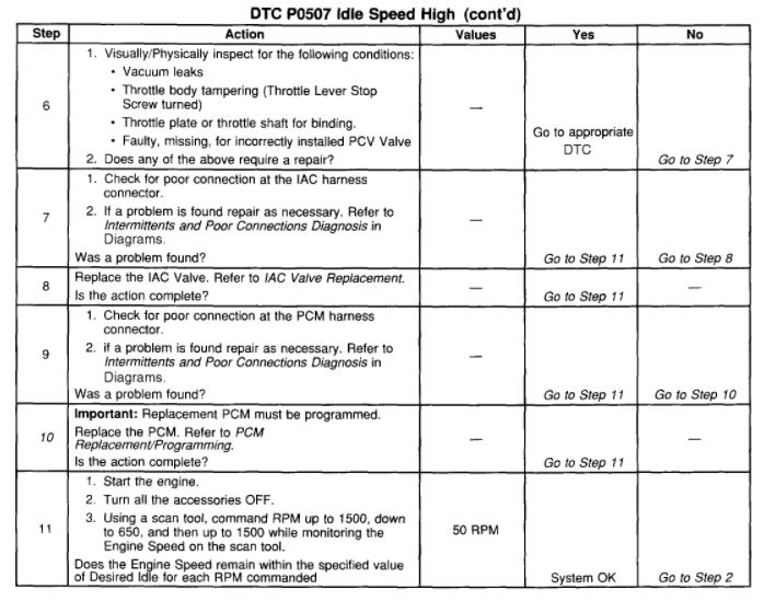

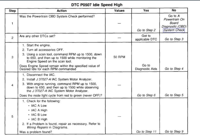

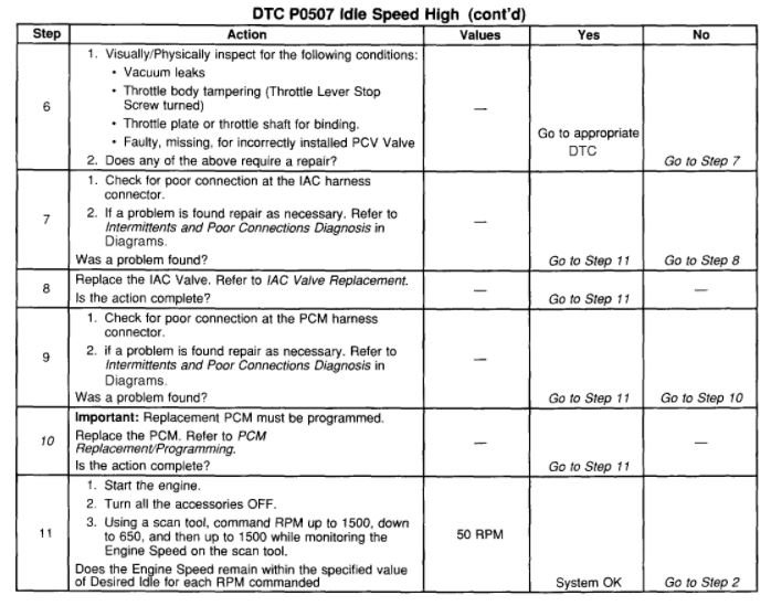

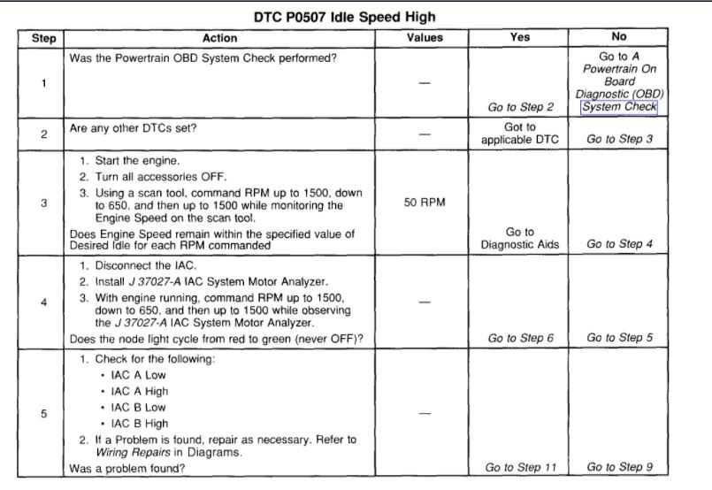

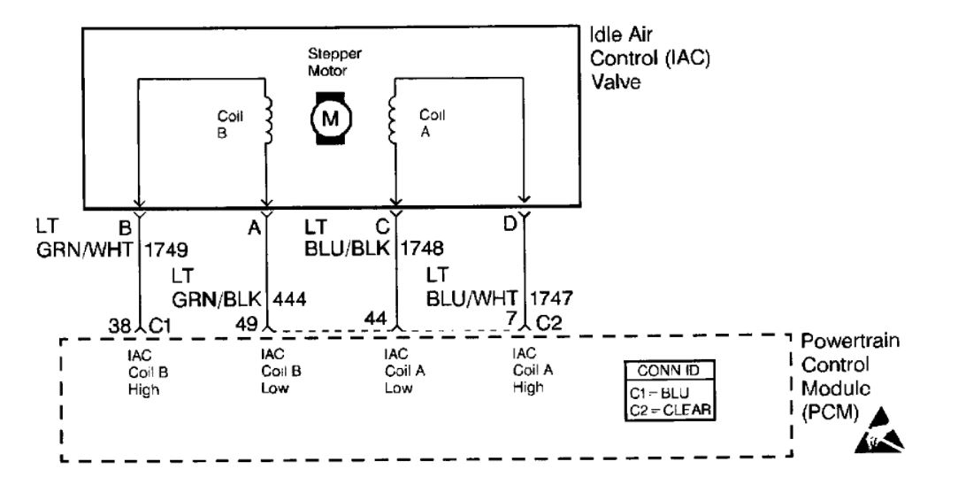

The problem I am having is the car is running good but the check light keeps coming on. I had a problem with a misfire I ended up finding a vacuum leak and I cleaned the idle control valve and it ran good. Then the light came back on so I replaced the IAC valve. it was fine for about a day and the light came back on and I got a p0507 code. I reset it and about 10 miles it comes back on. any help would be appreciated. The inspection is up the end of January.

Good morning,
I attached the flowchart for you for the code. It is for the idle air control.

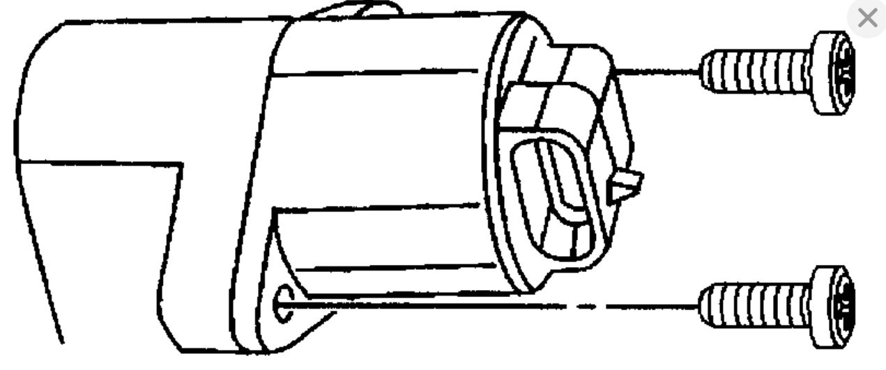

You cannot clean this valve as the part that sticks is not accessible. If there is an issue, it must be replaced.
https://www.2carpros.com/articles/how-to-replace-an-idle-speed-control-motor-iac
Circuit Description
The PCM controls the air entering into the engine with an Idle Control (IAC) valve. In order to increase the idle rpm, the PCM commands the pintle inside the IAC valve away from the throttle body seat. This allows more air to bypass through the throttle blade. In order to decrease the rpm the PCM commands the pintle towards the throttle body seat. This reduces the amount of air bypassing the throttle blade. A scan tool will read the IAC valve pintle position in counts. The higher the counts, the more air that is allowed to bypass the throttle blade.

^ Poor connection at PCM or IAC motor. Inspect harness connectors for backed out terminals, improper mating, broken locks, improperly formed or damaged terminals, and poor terminal to wire connection. Refer to Intermittents and Poor Connections Diagnosis.
^ Damaged harness. Inspect the wiring harness for damage. Refer to Wiring Repairs in Diagrams.

1. Turn OFF the ignition switch.

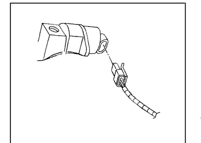

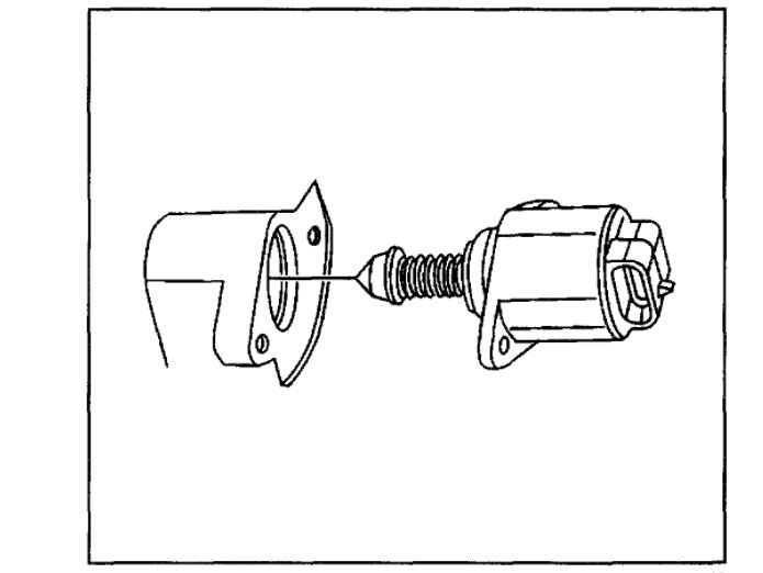

2. Disconnect the electrical connector from the idle air control valve.
3. Remove the idle air control valve (2) attaching screws.
4. Remove the idle air control valve.
5. Remove the idle air control valve O-ring.

Thank you for your reply. I will inspect the wiring closer. i have a brand new IAC valve in and cleaned the throttle body bore and plate. i have no vacuum leaks the pdf looks good. I will look at EGR closer too. A friend has a good scanner with freeze frame so I can see when it's happening. Thanks again.
