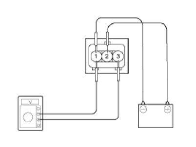

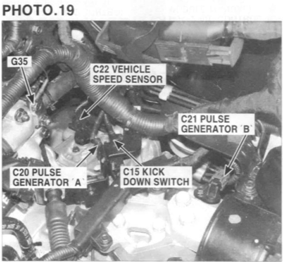

I am a bit confused. Did you replace an ABS sensor? When you say the axle was replaced, I think you may have gotten the wrong sensor. Take a look at picture 1. It shows where the speed sensor is located. If that is not what you replaced. Here are the directions for testing it. Picture 2 correlates with these directions.
Inspection
Vehicle Speed Sensor
1. Connect the positive (+) lead from battery to terminal 2 and negative (-) lead to terminal 1.
2. Connect the positive (+) lead from tester to terminal 3 and the negative (-) lead to terminal 1.
3. Rotate the shaft.
4. Check that there is voltage change from approx. 0V to 11V or more between terminals 3 and 1.
5. The voltage change should be 4 times for every revolution of the speed sensor shaft.
If operation is not as specified, replace the sensor.
Let me know if this helps.

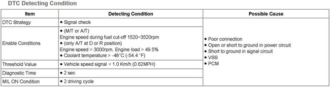

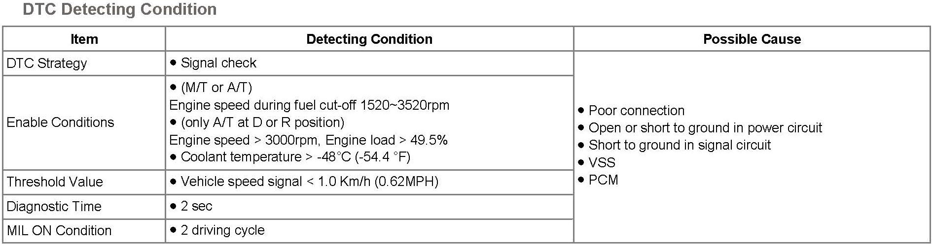

After more thought, I really feel you are already on the right track. I did more research and found that the wheel speed sensor can set the code. Since the other sensor (on transmission) was okay prior to repairs, I think you are right. What can set the code is If the vehicle speed signal is below 0.62 MPH during 2 sec under enable conditions, PCM sets P0501. Basically, when you press the gas to accelerate in drive or reverse, that is an enabling condition. If the sensor indicates under 1 mph for longer than 2 seconds, it sets the code.
Take a look at the picture I attached. It describes it more in depth. It also lists possible causes. I doubt the PCM went bad since the repairs, so my suspect is a bad connection, broken wire, or a bad sensor.
As far as the transmission fluid, that wouldn't causer this.
Take a look at this and let me know your thoughts.
