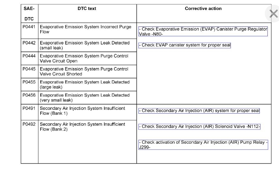

Codes P0491, p0492, p0456 and p0431
2003 VOLKSWAGEN PASSAT
180,000 MILES • 2.8L • 6 CYL • 2WD • AUTOMATIC
IFYUSER
  • 54 POSTS

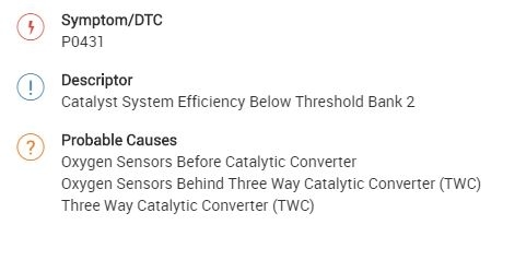

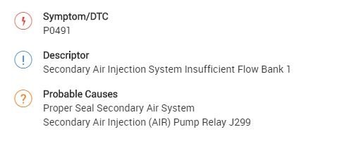

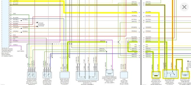

What is the problem with this car and are they related?
Feb 29, 2020 at 3:16 PM
Good morning,

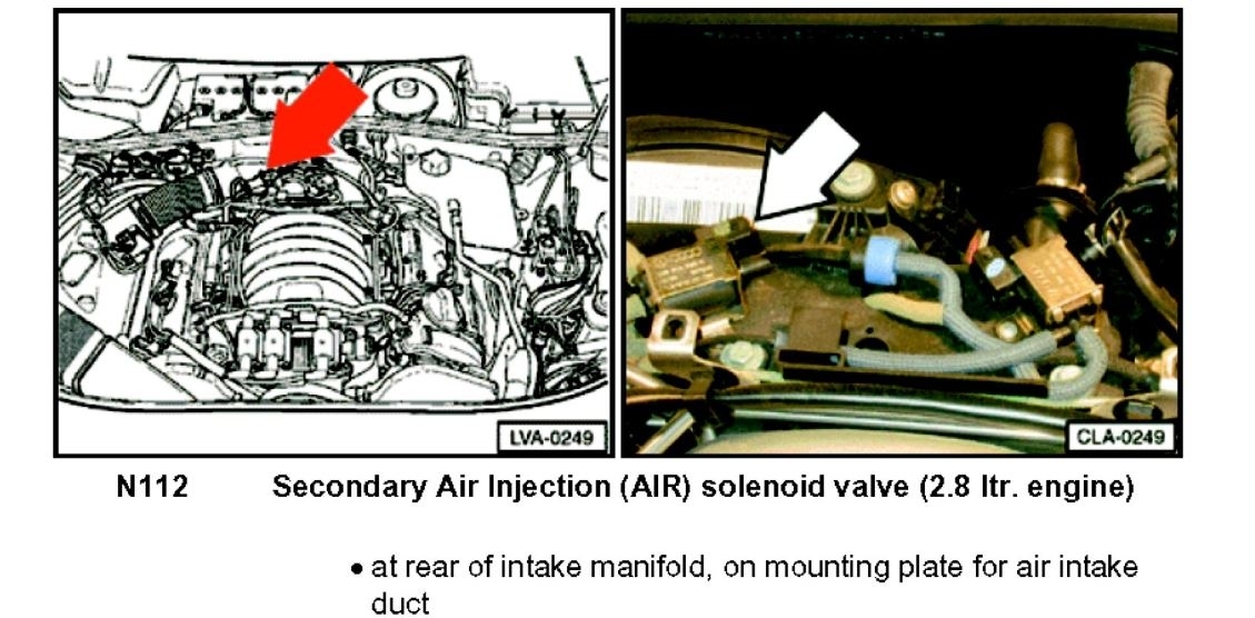

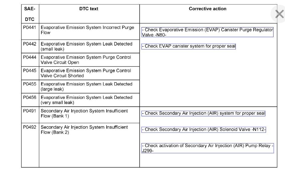

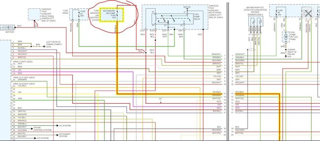

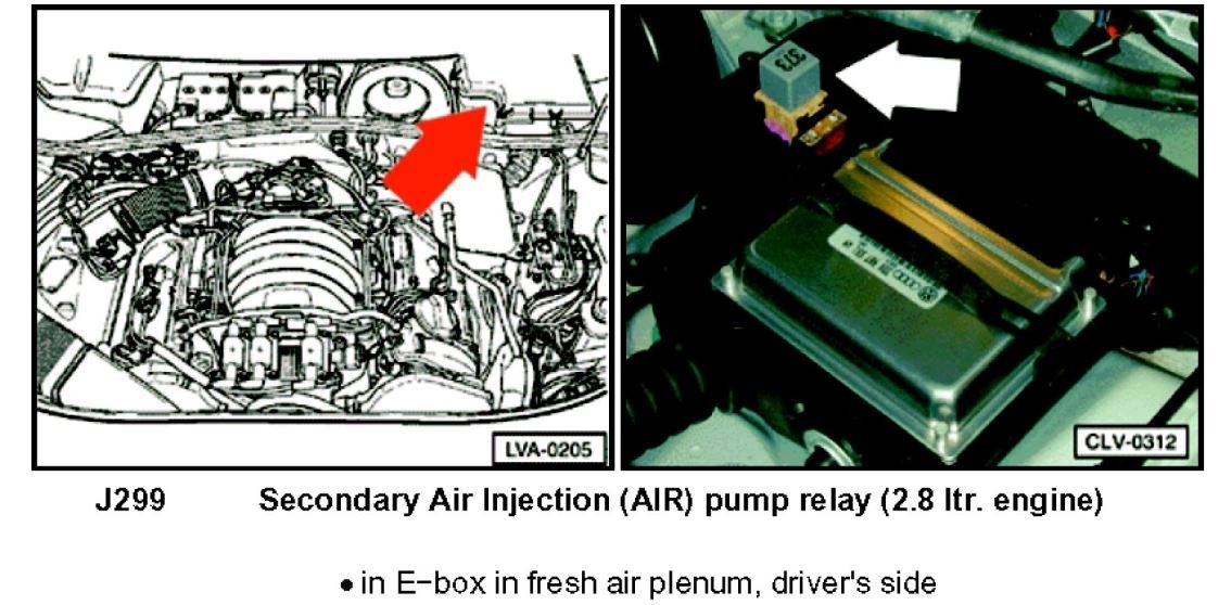

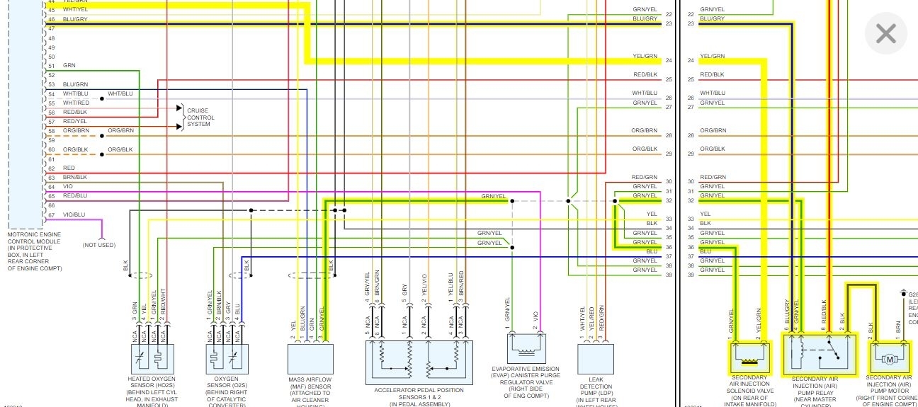

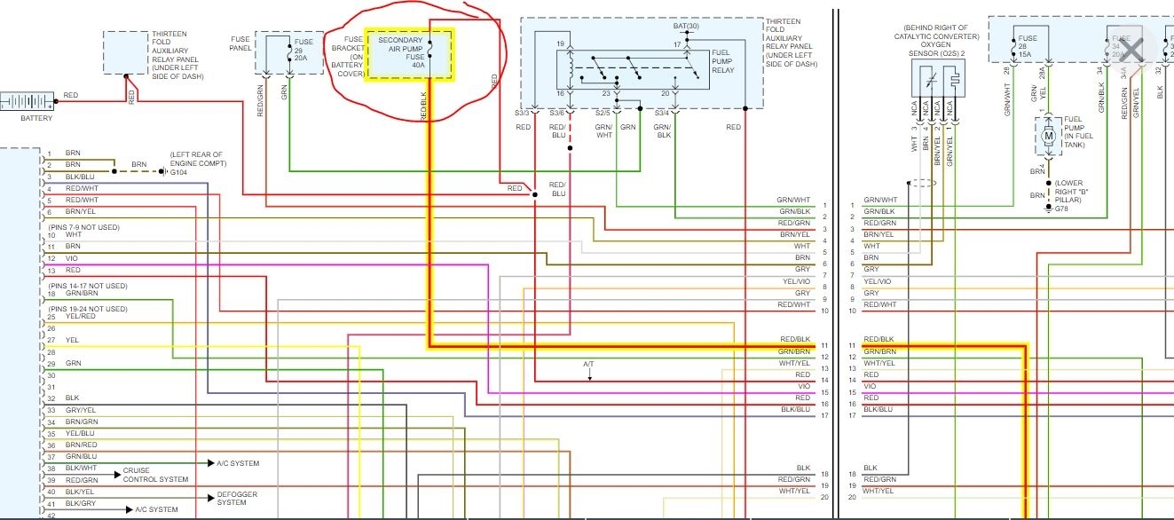

491 and 492 are for the secondary air injection system. It could be the relay or the solenoid. There are also cases that have the passages clogged with carbon. It is difficult to get to the passages as they are at the back of the motor.
the 456 is for an emission leak in the evap system. The system needs to be smoke tested to find the leak.
https://www.2carpros.com/articles/how-emission-control-systems-work
https://www.2carpros.com/articles/evap-system-code-repair

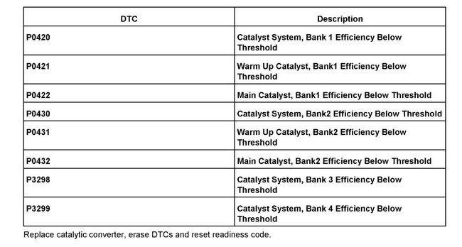

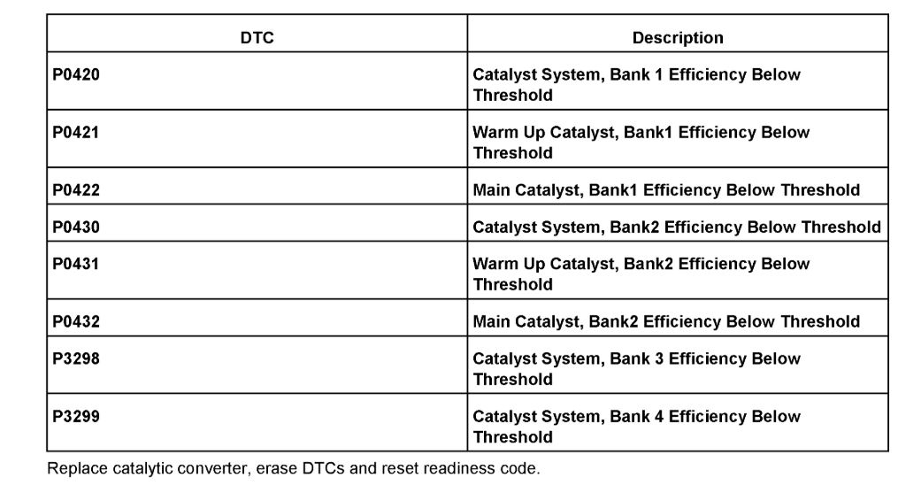

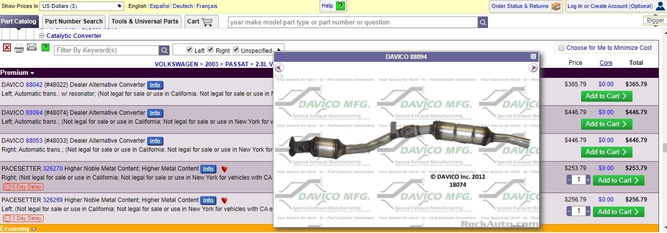

The 431 is for the catalytic converter. It is worn out and needs to be replaced.
