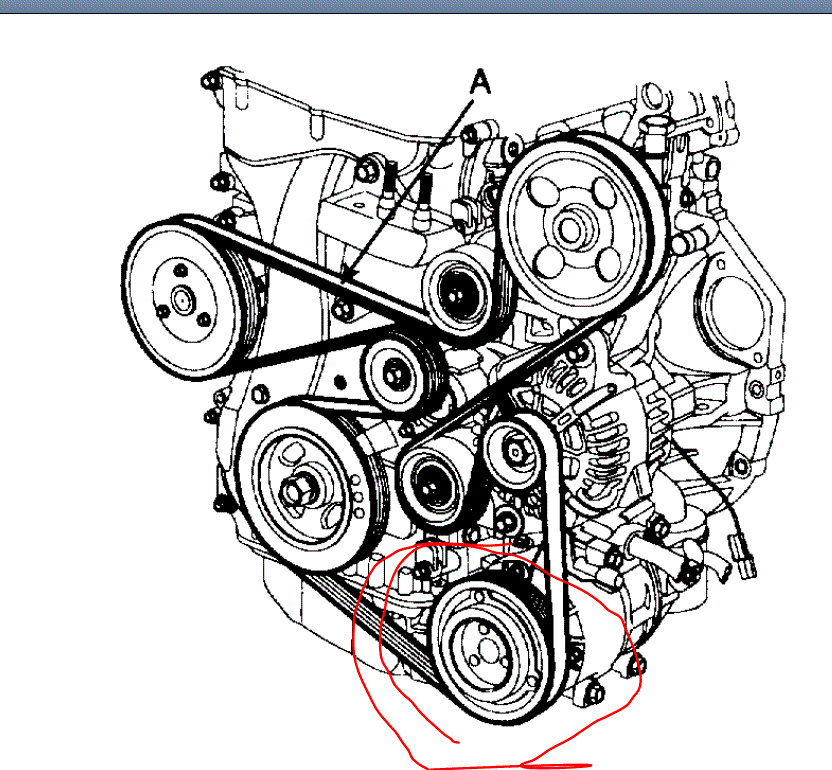

Thank you for the reply! So I checked under the car and couldn't really find any source to the sound it has been making when idling or at low speed but found another detail. The sound completely goes away when I turn on the A/C. I should also mention my A/C hasn't been blowing cold air as of late and when checking the Freon the PSI seems to be at the appropriate level, this could be taken care of in another post I'm sure but wanted to mention it as a part of my rattle sound problem as well. Thanks again!
Jun 25, 2020 at 8:27 AM
  • 110,240 POSTS
Do me a favor, open the hood and locate the A/C compressor. See pic 1 for location.
Have a helper start the engine with the A/C off. Have the helper turn the A/C on and off a couple times to see if that is where the noise is coming from.
As far as the EVAP leak, you really need to have the system smoke tested.
Let me know what you find.
