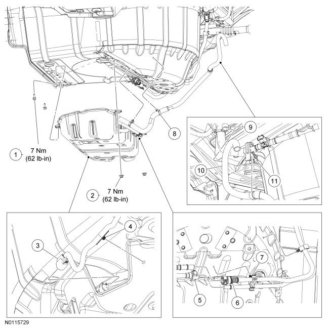

I have had this code twice and I did take out the fuel senders to clean. but did not happen until I drove it on interstate and I did hit something on road that went by dear passenger rear tire and code appeared immediately. Stopped to access damage and was nothing and cleared code and drove another 30 miles and shut car off twice in times before it did it again. can the sender seals be cause or cap less full?

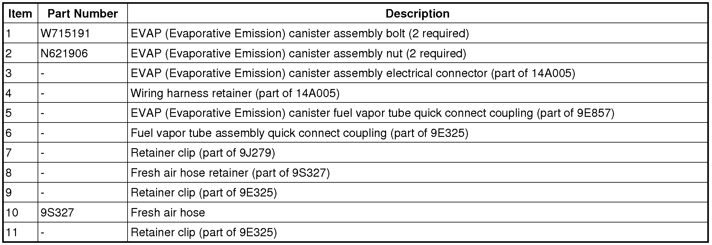

I would look closely at the evap canister under the rear of the car under the trunk area. I've replaced tons of these after people hit debris on highway or go over curbs etc. A damaged canister can also cause the fuel filler nozzle to click before the vehicle is actually full. I included a blow up of the evap canister and lines, inspect the lines at the left rear wheel well areas as well.
