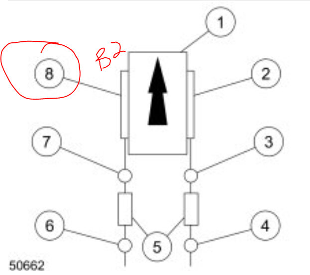

As far as replacing it again, I would do some checking first. First, make sure you have the correct side for bank 2. See pic 1 below.
Next, do you have a live data scan tool? If you do, watch the O2 sensors' voltages. If the converter is working, the voltage readings between the upstream and downstream sensors will be a good bit different. If the converter isn't working, then the sensors' voltages will likely be nearly the same or the same.
Also, if you have an infrared thermometer, compare the temperature and the input of the converter and the outlet. If the converter is working, the temperature will be between approximately 30- and 100-degrees F hotter at the output. If there is little to no difference, the converter isn't doing its job.
Let me know what you find or if you have questions.

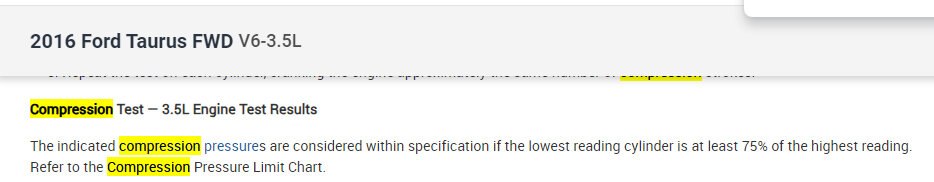

  • 110,241 POSTS
There doesn't need to be a large leak. Usually, if there is 25% or more difference between the highest and lowest cylinders, you will at least feel a rough idle. Usually, if it exceeds that, you will get a misfire.
See pic below.

OZ1991
  • 14 POSTS
Hey Joe,
I have had conducted a digital (computer based) cylinder compression which showed all values to be okay except for cylinder 5 which had showed 1% deviation and that's when I resorted to the basic mechanical compression test (you recommended), and it turned out cylinder 5 was doing just fine and no leak is present.
