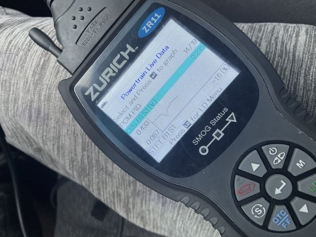

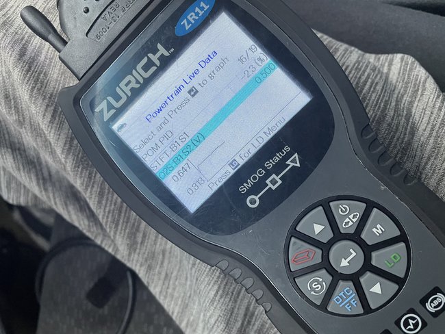

I got the code awhile back and replaced my catalytic converter the manifold one and the code came back couple hundred miles. i have checked the 02 readings and both good. i think the b1s1 is an air fuel ratio sensor and were both good and the catalytic converter is brand new. matter a fact the whole exhaust is brand new not to long ago.
Both readings at idle and also for b1s1 i pressed the gas for a second full throttle and it shot down then up them back to normal which means sensor is good and everything just need help also b1s2 is steady which is supposed to i believe.

When you check the downstream sensor, test it at 1,200 RPMs, and see if the voltage is steady. If it varies, the cat is bad.

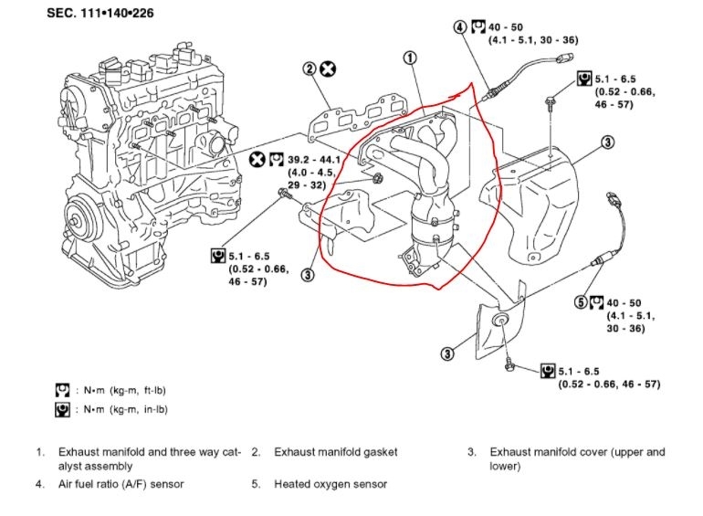

EXHAUST MANIFOLD AND THREE WAY CATALYST
Removal and Installation

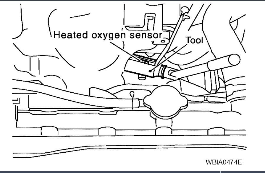

2. Disconnect the electrical connector of heated oxygen sensor 1 or air fuel ratio (A/F) sensor 1, and unhook the harness from the bracket and middle clamp on the cover.
3. Remove the heated oxygen sensor 1 or air fuel ratio (A/F) sensor 1 using Tool.
Tool numbers
Air fuel ratio (A/F) sensor wrench : J-44626
Heated oxygen sensor wrench : KV10117100 (J-36471-A)
CAUTION:
Be careful not to damage heated oxygen sensor or air fuel ratio (A/F) sensor.
Discard any heated oxygen sensor or air fuel ratio (A/F) sensor which has been dropped from a height of more than 0.5 m (19.7 inch) onto a hard surface such as a concrete floor; use a new one.

7. Loosen the nuts in the sequence as shown, on the exhaust manifold and three way catalyst.
8. Remove the exhaust manifold and three way catalyst assembly and gasket. Discard the gasket.

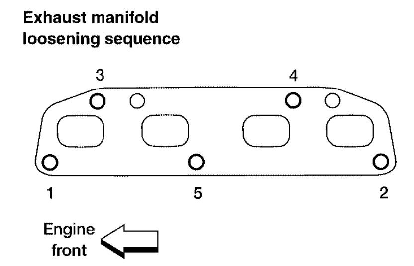

Tightening Exhaust Manifold Nuts
Tighten the nuts in the numerical order shown, to specification. After tightening No. 5, retighten No. 1 and then No. 3 to specification.
