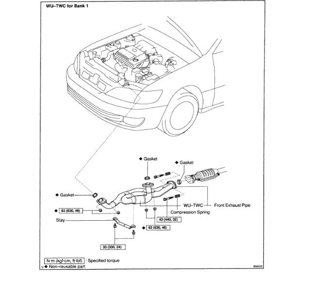

Hi, love this site. Have a 2000 Lexus GS300, P0420 code popped up. Car runs great, no discernible performance difference, no strange noises, etc.
P0420 Catalyst System Efficiency Below Threshold Bank 1
This car has a new MAF, replaced on a whim to trouble shoot a recent misfire issue.
I took a peak at fuel trims, ST’s hovering at 3%, LT’s hovering at 17%. But the same on both 1 and 2. Readings taken at idle.
What are the potential causes? Since there is no performance issue, I am guessing it is a sensor, but would love to hear from the group here.

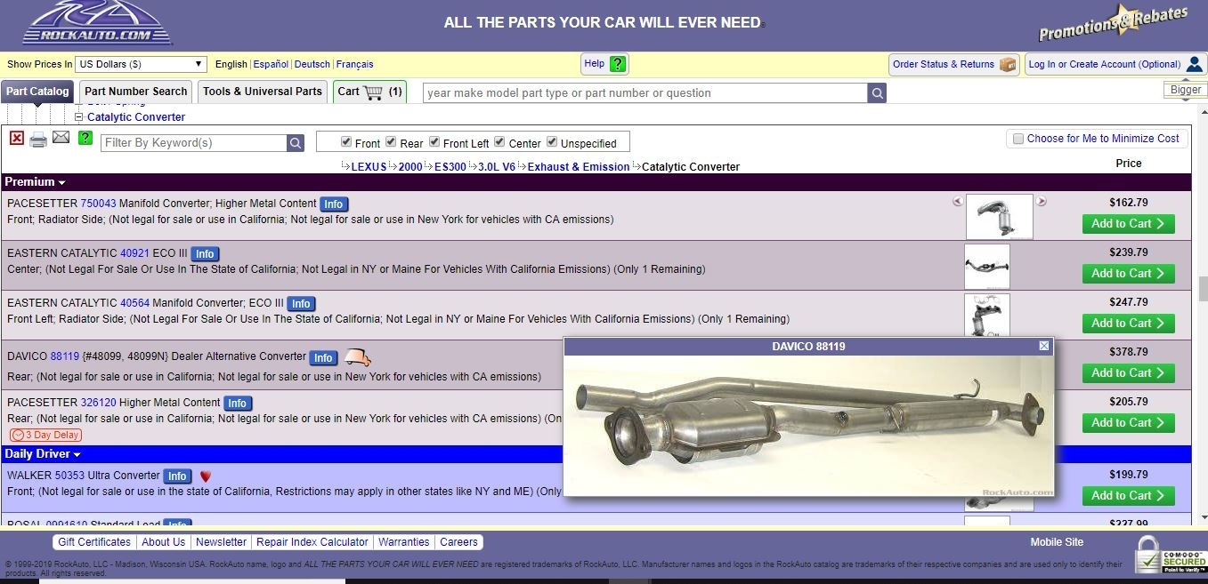

You need a catalytic converter for bank 1. The code indicates the precious metals inside the catalytic converter are worn out.
I attached a picture of the location and the part from rock auto.

Okay, you need to raise the car.
If you looked at the picture I sent, there are 3 attaching points that need to be released. There is one bracket that has to be released as well.
The front bottom is easy to release as it is right there. The one that attaches to the rear exhaust is the tough one. There are 2 bolts that hold it up securely.
The rear part has 2 spring bolts. They will have to be replaced when you take them off.
Spray rust remover on all connections before attempting to remove the bolts.
It should take you about 1 to 2 hours. When you have it down, you will need to remove the O2 sensor. It will be easier when it is on the ground.
