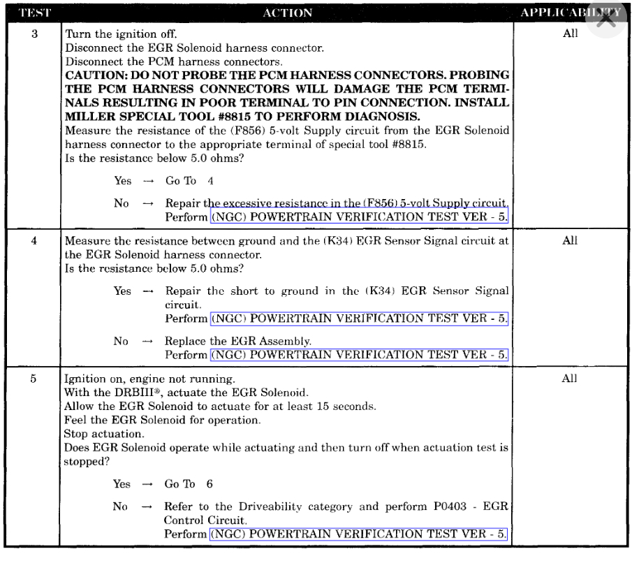

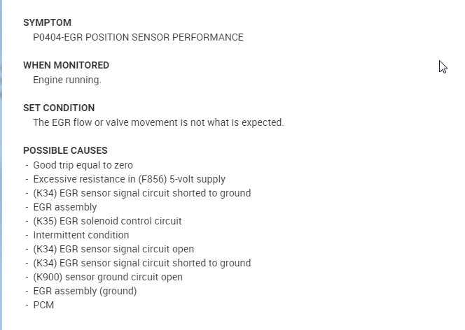

P0404 has come up three times in the last 10 months and has been reset in all cases. Once in Sept of 2019 and twice this past week. When should I become concerned with this code and what would be the best solution to take if the vehicle needs to be worked on. Thanks, Jim Felland
Jul 21, 2020 at 5:05 AM
Clearly the truck is able to be operated as this is not a code that will render the truck inoperable but it should be addressed. Not only will the truck run properly but you may be able to get a little better fuel mileage.

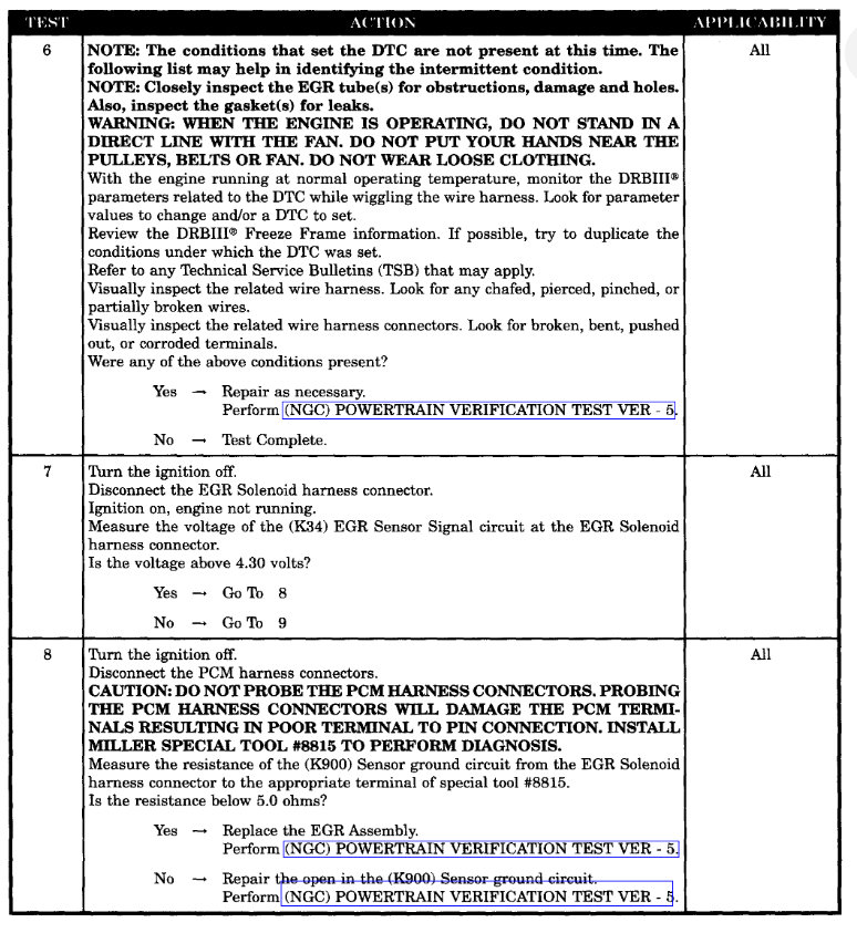

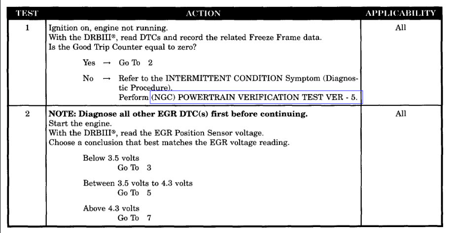

I attached the testing that we need to do in order to figure out what the issue is. Let's run through this and let us know if you have questions. Thanks
