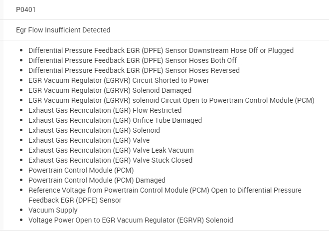

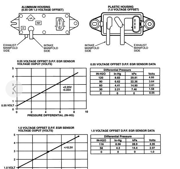

The code is for the DPFE sensor. It is a feedback sensor for the EGR system.
The hoses are easy. They are different sizes and cannot be placed in the wrong position. The electrical connector is the only connector.
This sensor is the most common failure for this code.
If the hoses melted from heat, then that is different. If that is the case, that indicates a clogged catalytic converter.

Is there a way to test it because it's only about a year old? How about a way to test the EVAP canister purge valve? out of all the things that go wrong with this system what is usually the number one cause? please and thank you.
Oct 25, 2019 at 10:00 PM
Okay, first, the EVAP has no connection to the issue you have with the code.
Yes, the most common is the sensor itself. To test it, you need an advanced scan tool to read the signal voltage being sent back to the PCM.
Do you have a real scan tool that can read live data?
