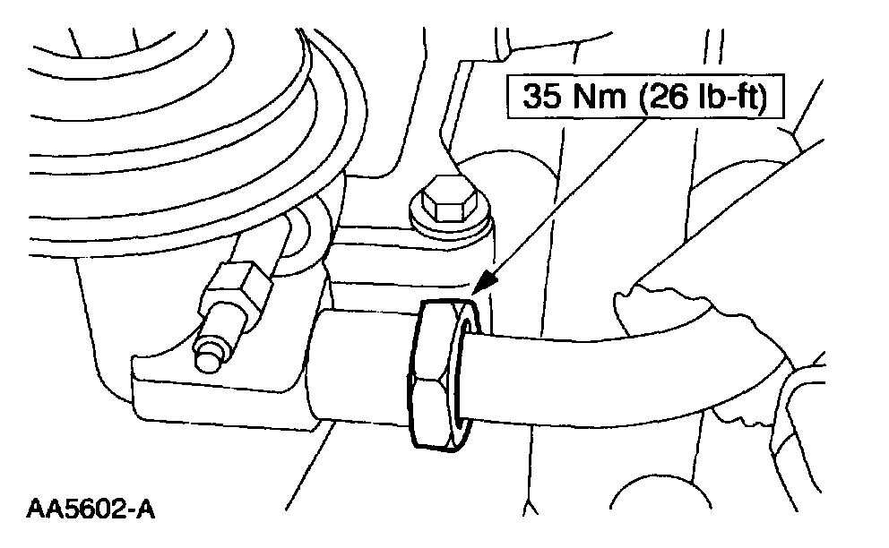

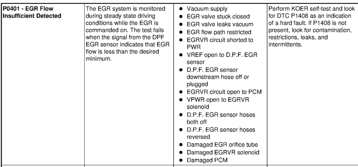

Exhaust gas recirculation flow insufficient detected. how should i go about this? steps? thanks
Feb 19, 2021 at 9:09 PM
  • 110,244 POSTS
If that is the only code present, chances are there is a carbon build-up issue in the intake or on the EGR itself restricting airflow. If you look at pic 1, column three indicates possible issues. Check the EGR which is on the intake manifold and make sure the vacuum supply to it is good Also, make sure it isn't disconnected or cracked.
Next, if the vacuum is good, remove the EGR and inspect it as well as the intake for carbon issues that can cause the restriction. Note that with the EGR out, you can apply a vacuum to it to see if the pintle moves.

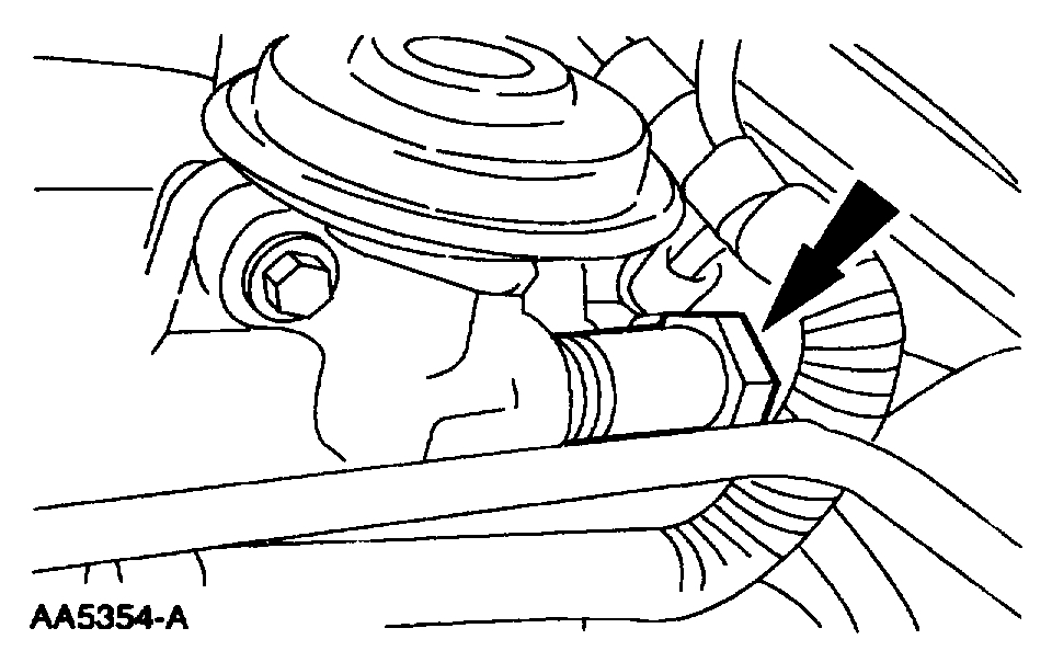

Here are the directions for removal and replacement of the EGR. The attached pics correlate with the directions.
________________________________________________
2000 Ford Mustang V6-3.8L VIN 4
Procedures
Vehicle Powertrain Management Emission Control Systems Exhaust Gas Recirculation EGR Valve Service and Repair Procedures
PROCEDURES
REMOVAL
NOTE: The 4.6L, 4V is shown. The 3.8L and the 4.6L, 2V are similar.
pic 2
1. Disconnect the vacuum hose.

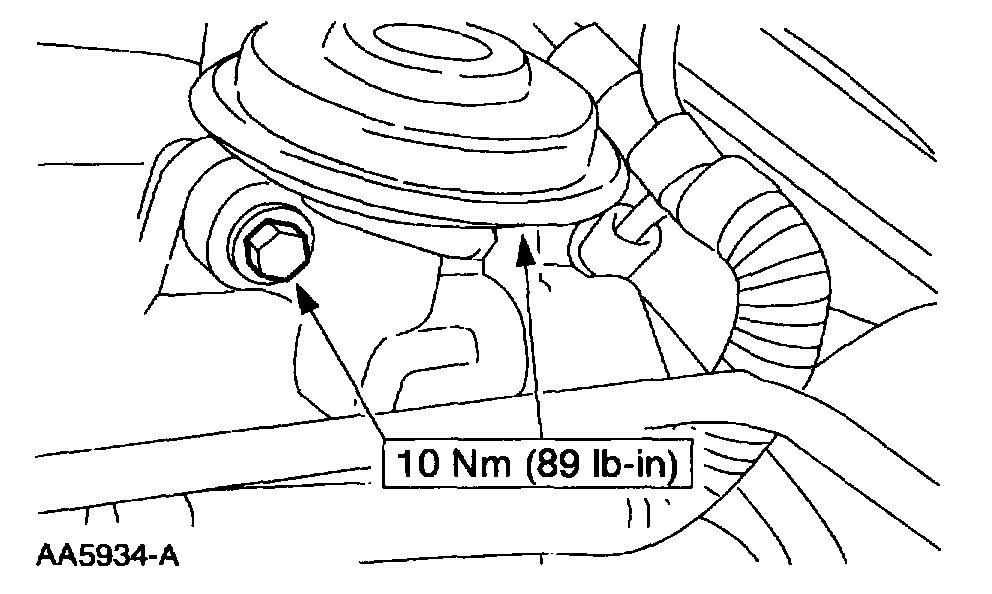

pic 3
2. Disconnect the Exhaust Gas Recirculation (EGR) tube from the EGR valve.

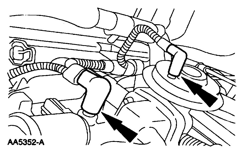

pic 4
3. Remove two bolts, the EGR valve and gasket.

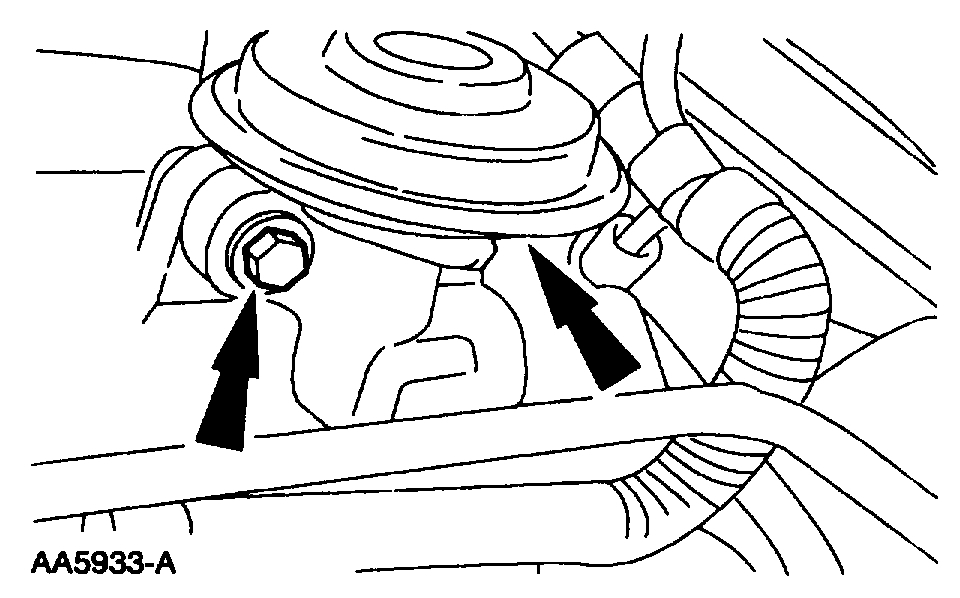

INSTALLATION
pic 5

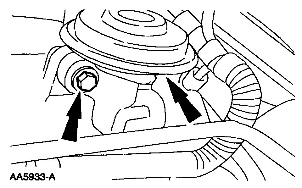

pic 6
1. To install, reverse the removal procedure.
NOTE:
^ Install a new gasket.
^ The 4.6L, 4V is shown. The 3.8L and the 4.6L, 2V are similar.
