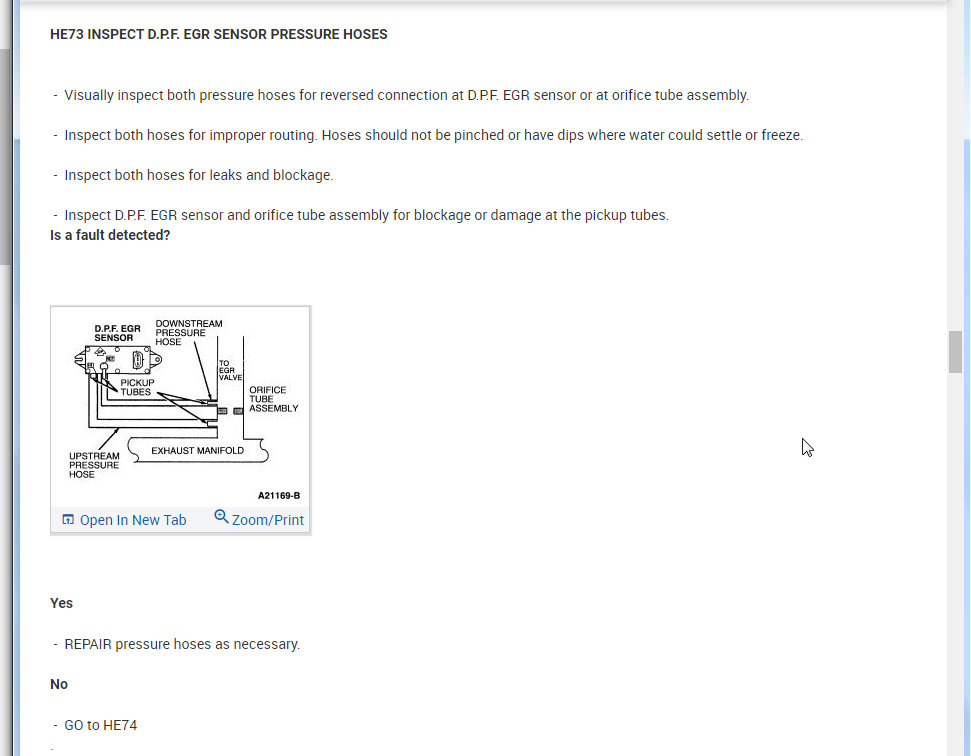

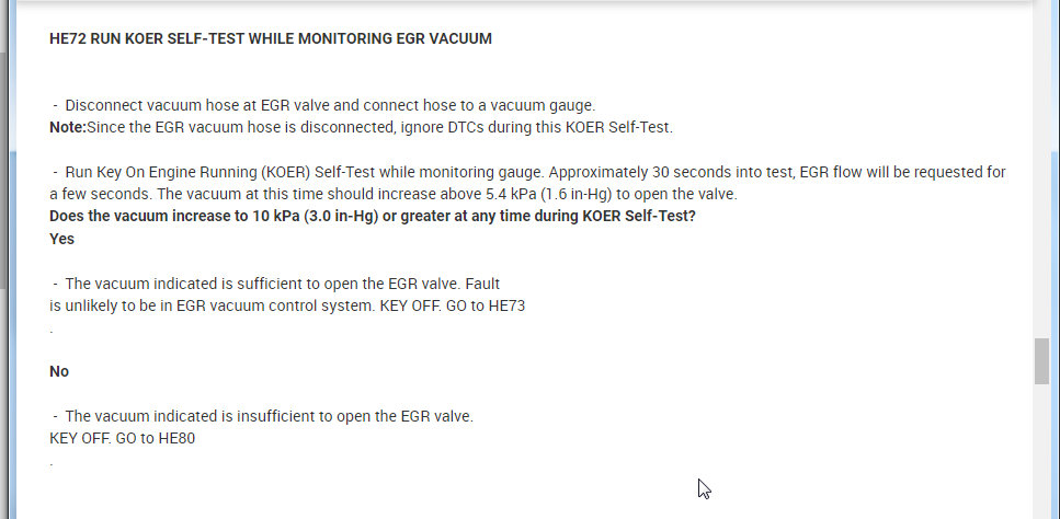

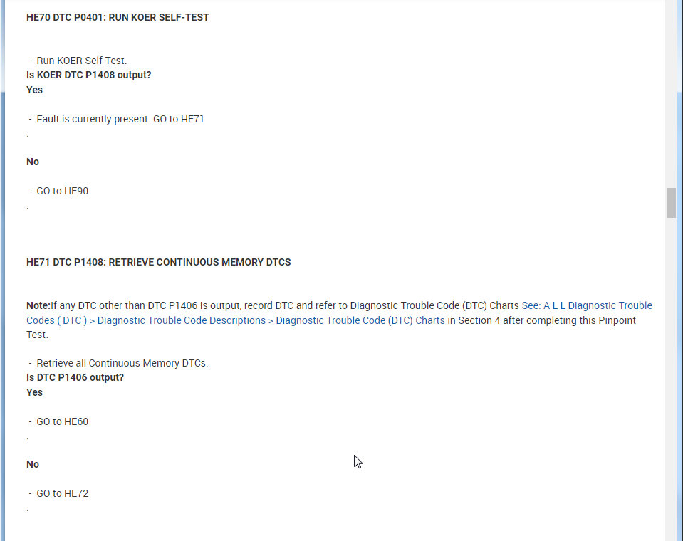

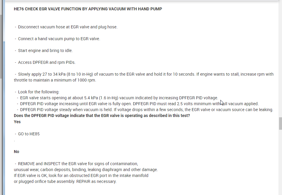

Here is a guide that will help with this:

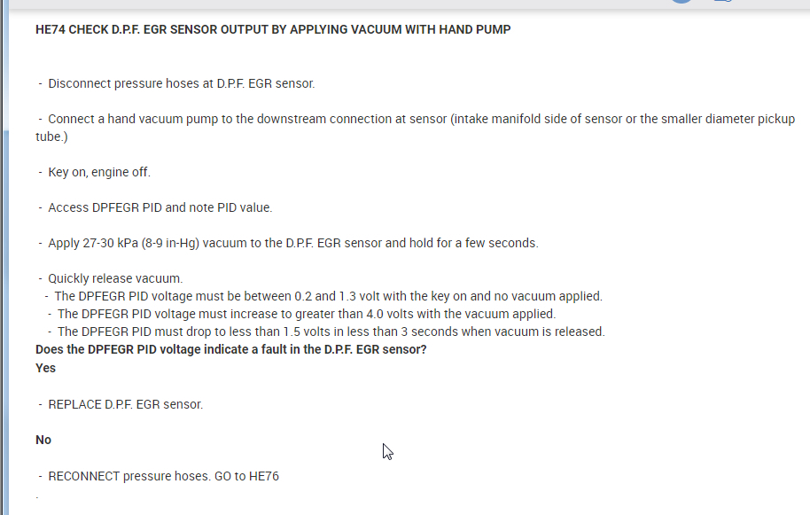

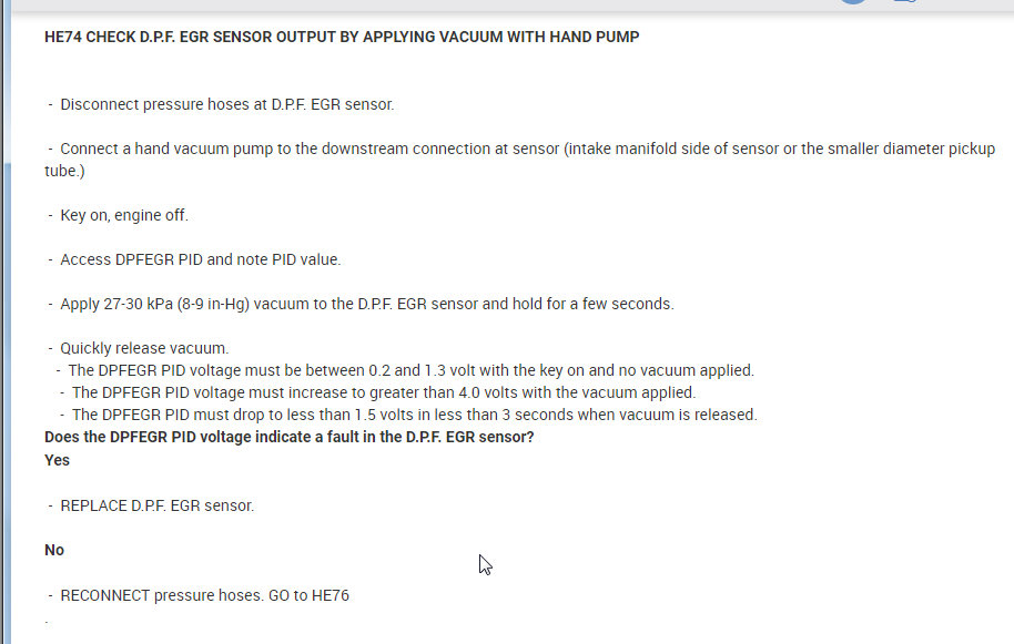

Below you will have the testing for this code if you want to run through that as well.
Let me know if you have questions. Thanks

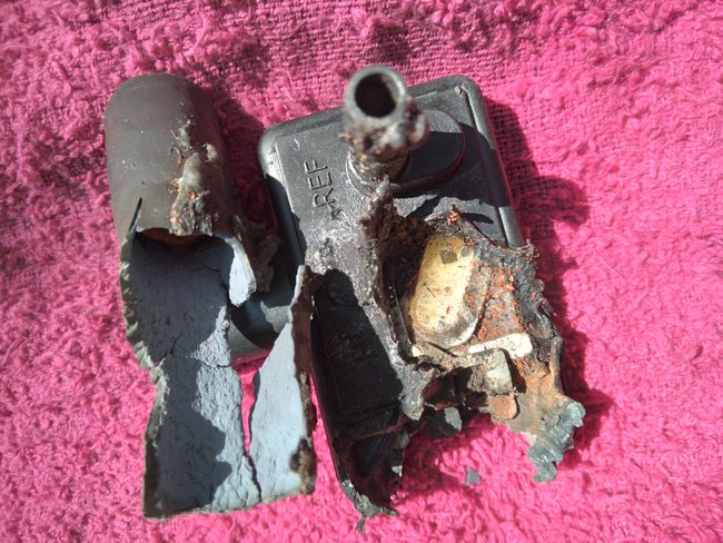

After I removed the intake and throttle body was able to see this.
May 21, 2021 at 8:49 AM
Oh my. I would say that is an issue. That appears that it was a DPFE at one point.
It has EGR lines running to both sides of it so that would explain where the air was coming from.
Please let us know if you need more info in the future. Thanks for the picture and using 2CarPros.

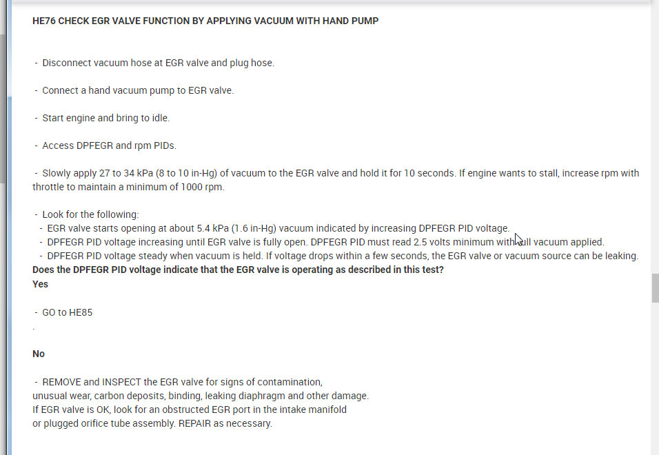

Since our last conversation I have replaced some bad pieces of vacuum line and the EGR valve. EGR Solenoid tested faulty so replaced that this morning. Cranked right up, but rough idle. As soon as I gave it some gas it shut off. Noticed that while engine was still cool (only ran for a minute) the exhaust tube from EGR valve was almost too hot to touch. Wondering if the DPFE could have been bad out of the box or another issue I haven't considered. Thanks in advance for any reply.
May 27, 2021 at 8:05 AM
It could but I would rule out base engine before condemning the DPFE again. Due to the EGR pulling exhaust gases, it is going to be the first thing that gets hot so I would expect it to be hot but it does sound quick.
