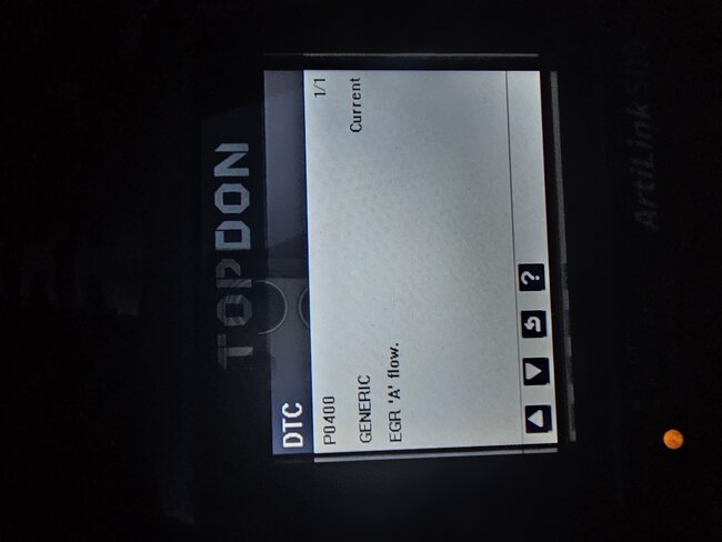

Hi, I have the vehicle listed above mk3 2006 1.8 petrol.
I had PO400 code had EGR value replaced and a 02-lambda sensor also had a new air filter. However, I still get a PO400 A Flow code any ideas how to permanently clear code or anything else I can change ?
Thank you

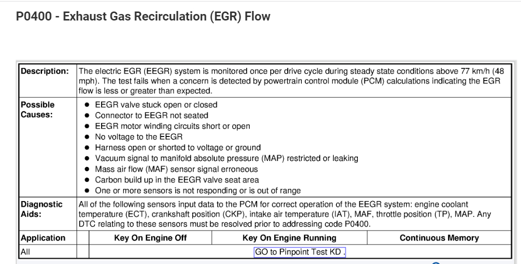

This model isn't offered in the US, but I will try my best to help. As you are already aware, the EGR system is causing the code. When you replaced it, did you check if there was any evidence of carbon build-up where it was attached to the engine? Are there any vacuum-related issues that you are aware of?
Since this is the only code, I question if it is a sensor-related issue, but anything is possible.
I attached possible causes in the pic below. Let me know what you have done to this point.
See pic below.
