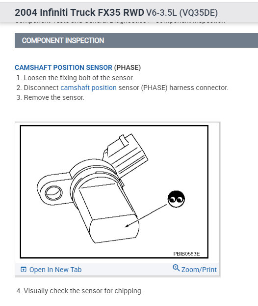

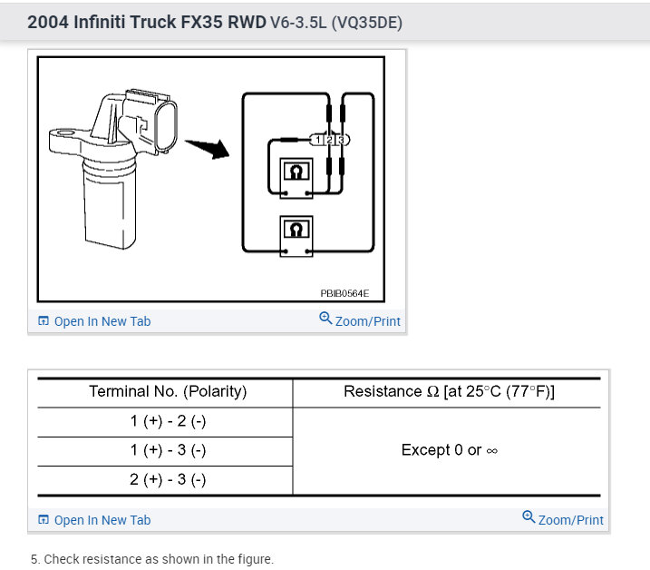

I attached a simple test for the sensor itself below. Take a look and let me know if you are comfortable performing them.

First, I'm happy to help, so no problem whatsoever. The funny thing about the sound is how and when it happens. When steel gets hot, it expands. When you removed the cam sensor, was it in good condition and not showing any evidence of possible damage?
I ask because I'm wondering if something is expanding and rubbing when it gets hot. It's only a theory.
