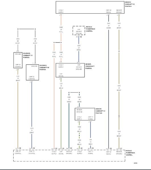

When I'm driving my car randomly stalls and shuts off. I have to drift to the side of the road and try several times before it will restart. Check engine light came on and gave the code p0335. I took it and had it checked, they said the crankshaft position sensor was fine and so was the wiring and said the PCM would need fixed. I took it to the dealership and had it replaced, about 2 weeks later it has now stalled and shut off while driving again. What else could it be?

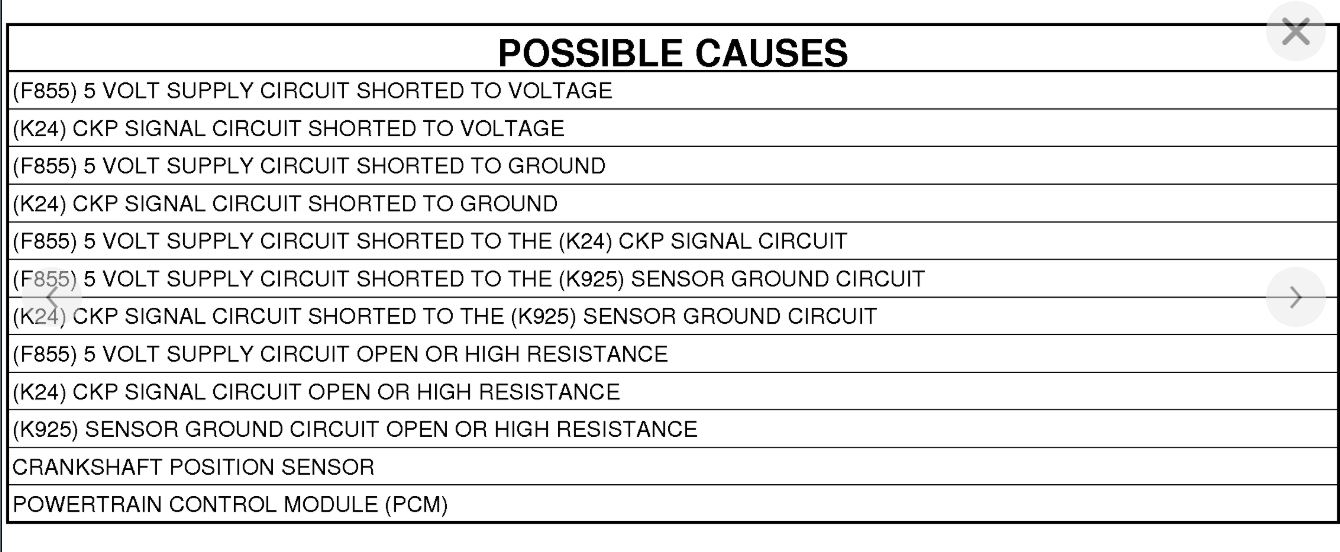

They missed the boat on this code. Whoever told you it was the PCM jumped the gun. In most cases, this code is electrical wiring between the PCM and the crank sensor itself.
I attached a wiring diagram and possible issues that must be checked before doing anything. The loss of the 5 volt signal is the most common issue.
