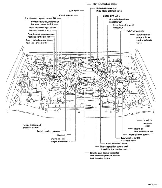

I have the truck listed above. Manufactured 08/1999. I am diagnosing it for a friend of mine. He has complained of hard starting issues at different times. I have driven it. It drives at cruise speeds okay but with 207,000 miles it seems to cruise okay at highway speeds. It does have hard starting problems intermittently. First thing I did was scan OBDII for codes and I have a P0325 code and a P0325 "pending" code. I know it is a knock sensor 1 circuit malfunction. I understand that the sensor is under the intake manifold. I have read that knock sensor is not important but me I know it is coming on for a reason. I cleared the codes and started engine back up and codes reappeared quickly. Also, there is No CEL light on instrument panel, only the codes P0325 twice on my scanner. P0325 and P0325 "pending". I want to know how the P0325 can affect my drivability or hard starting or idle issues. Thanks.

Hello SZALKUSKT and thank you for using 2CarPros. Nissan has always had an issue with posting that fault code with the knock sensor. The code will not go away no matter what you do. So for now you should ignore the fault code and actually try to duplicate the concern.

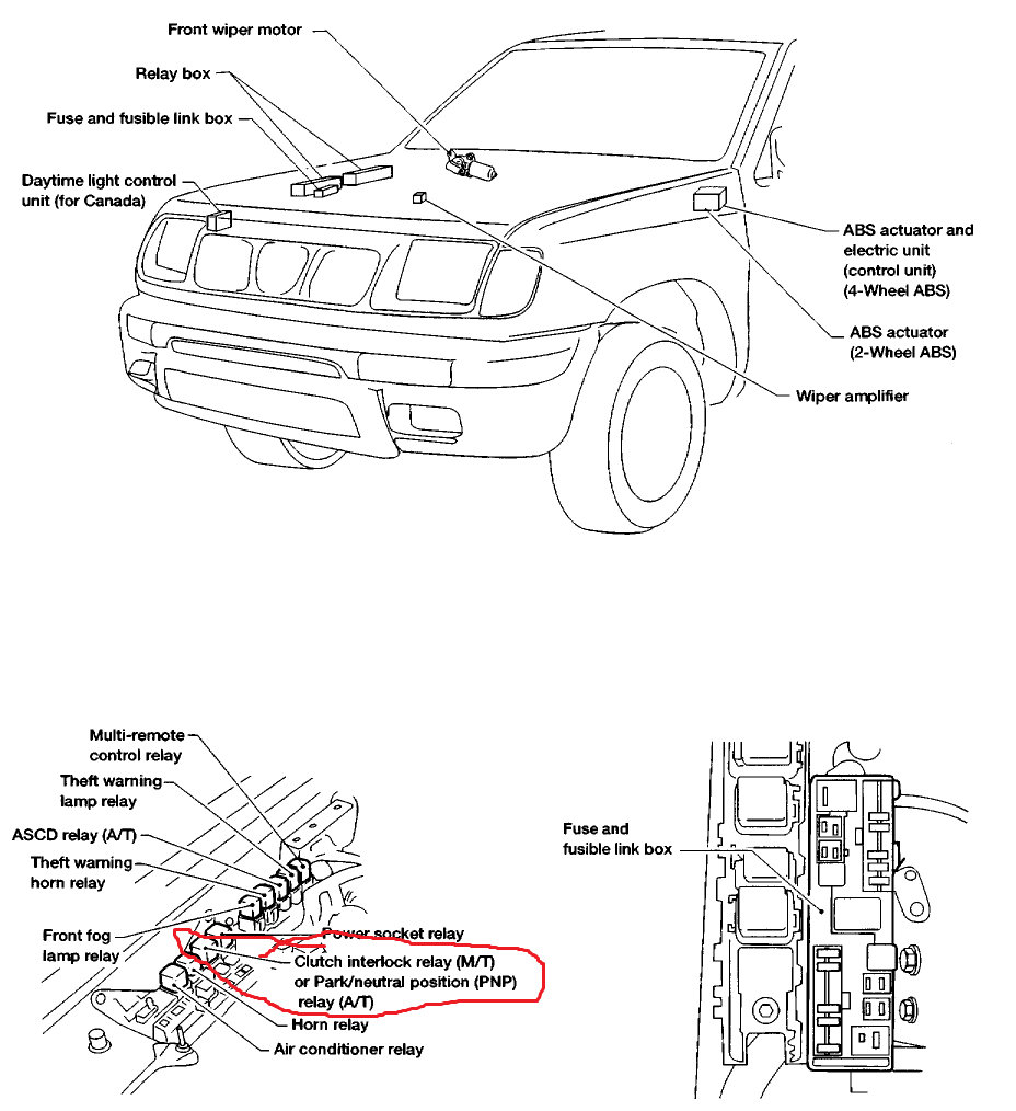

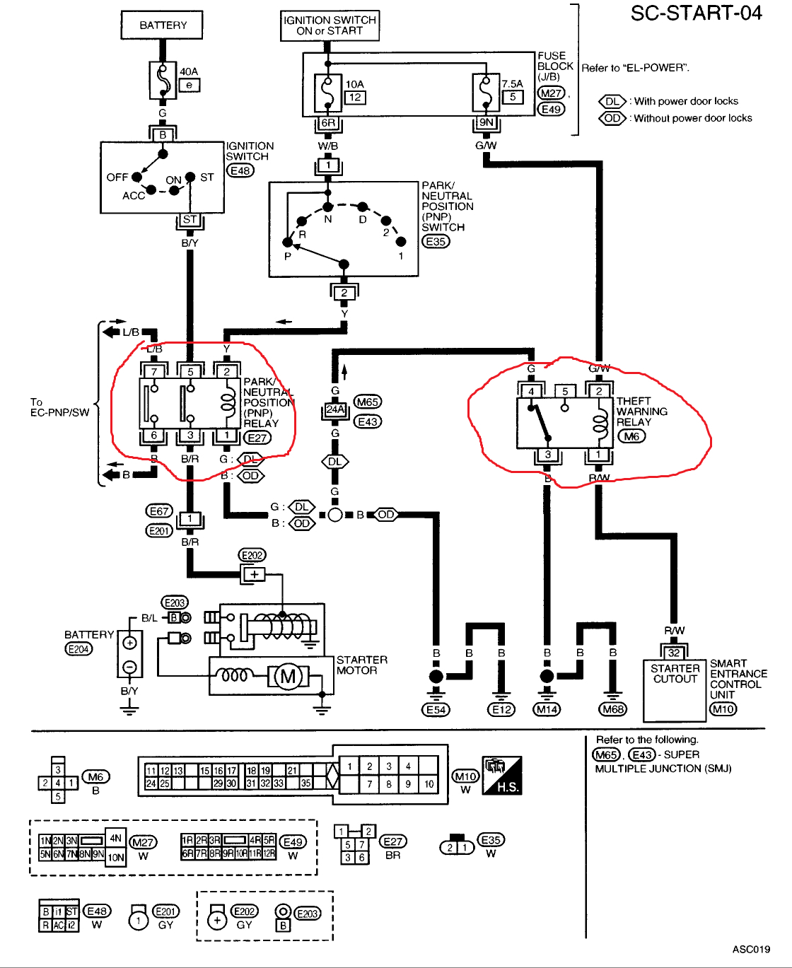

When your friend has the no start condition does the vehicle crank over? If you have a no crank no start condition then look at the warning relay but I would suspect the park/neutral relay. But as stated earlier, you would need to duplicate the concern and when it does not start does the vehicle crank over? Let us know.

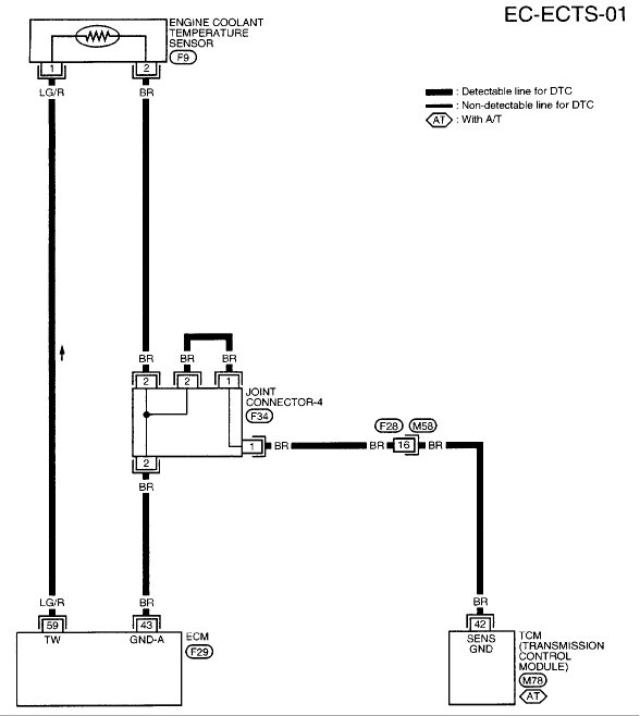

If you corrected the hard start then I would suspect an idle air control fault. The OBD2 system should have detected this by now and posted a code. Also, verify the the engine coolant temperature sensor is reading correctly. If it is thinking it is cold it will raise the rpm high to try and "warm up" the engine.
Jun 9, 2018 at 3:46 PM
SZALKUSKT
  • 274 POSTS
I have not had a code for the IAV valve. It does definitely have inconsistent idle values. How can I check the coolant temperature sensor if there is no code posted?
Jun 9, 2018 at 3:55 PM
JIS001
  • 3,412 POSTS
Once engine is at normal temperature back-probe the the signal return wire. Normally it should read under 1 volt, usually 0.50 volts. If higher it means it thinks it is colder. Also removing spark plugs. If they are wet with fuel it is dumping too much fuel also to try and make the idle high which in turn give you a hard start because the plugs are wet with fuel.
Jun 9, 2018 at 4:13 PM
SZALKUSKT
  • 274 POSTS
Do you have a wiring diagram so I can determine which wire is the signal return wire?
Jun 13, 2018 at 4:06 AM
JIS001
  • 3,412 POSTS
Light green red stripe should be the 5 volt reference. Brown wire is the signal return. When engine fully warm the brown wire should read under 1 volt. Normally 0.50V.
