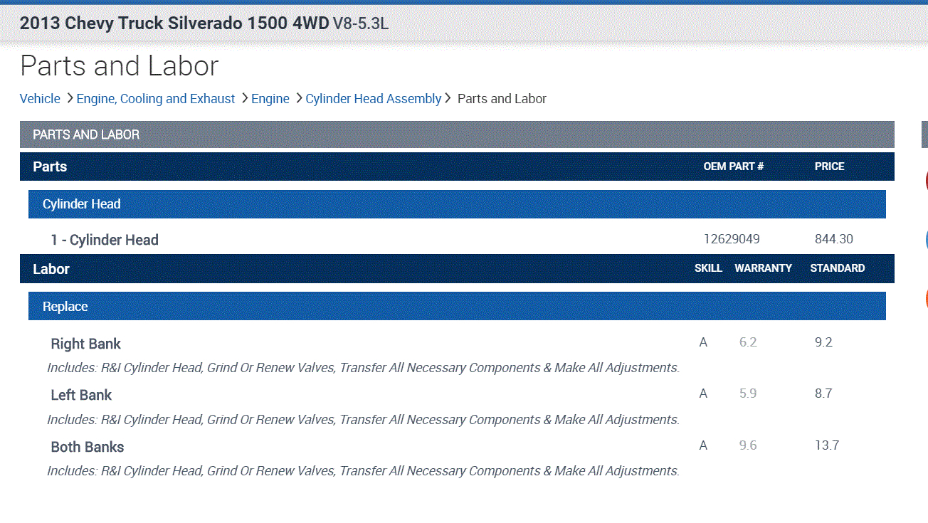

If it is possible, record the sound so I can hear it. Also, as far as taking the engine apart to check it is all going to be labor related and based on what is removed. For example, if a cylinder head is replaced, labor is showing 9.2 hours. The is a lot of money in time. However, if it is just removed, I can't imaging it would take more than 4 hours including inspection.
I attached a pic below that simply shows price for a new head and labor hours to replace one or both. Take a look at it for an idea on labor time.
