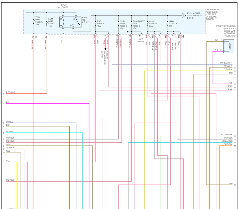

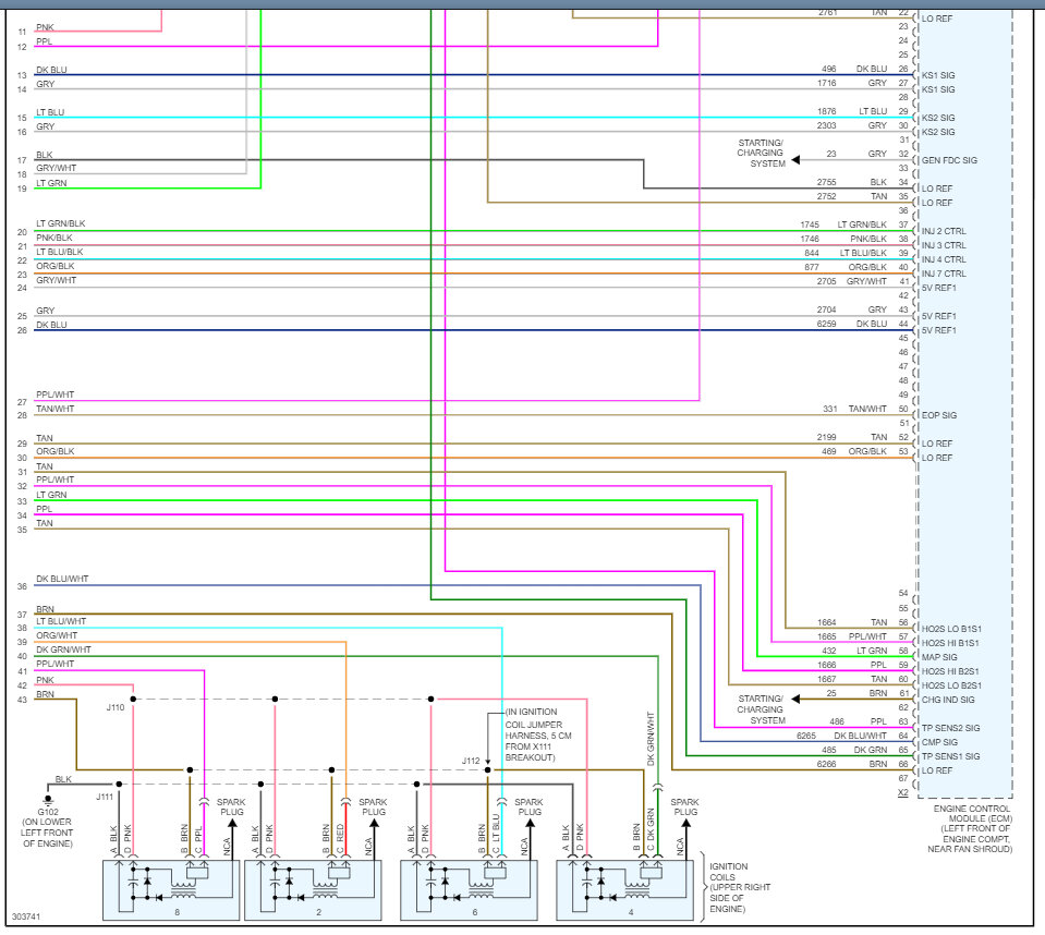

I need some expert advice. I have a #4-cylinder misfire. We have swapped the coil, spark plug, wire, and fuel injector with the opposite side of the block. The problem does not follow to the other cylinders still showing code P0304. I have had a mechanic do a compression test. It passed with all cylinders are around 120 PSI. They have pulled the valve cover and checked the rocker arm movement. They all checked well. We were told it could be a vacuum leak from the intake manifold. We removed and replaced the gaskets with new ones, but still have a misfire. We did notice after removing the intake the cylinder seemed dry. I really do not know where to go from here, any advice would be appreciated.

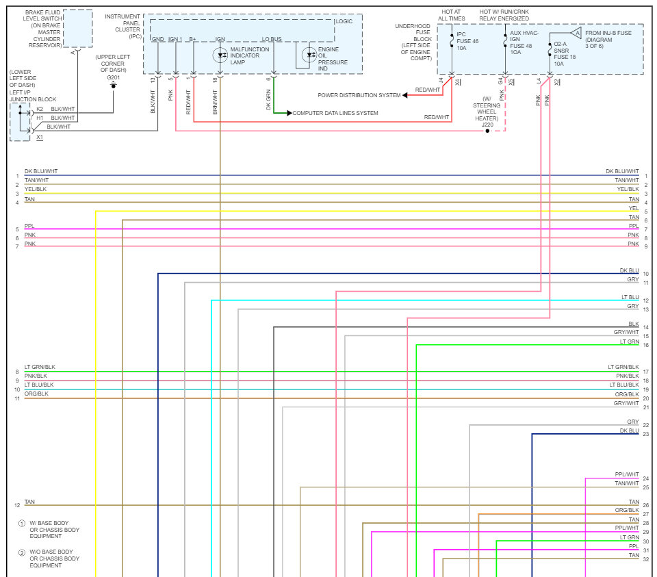

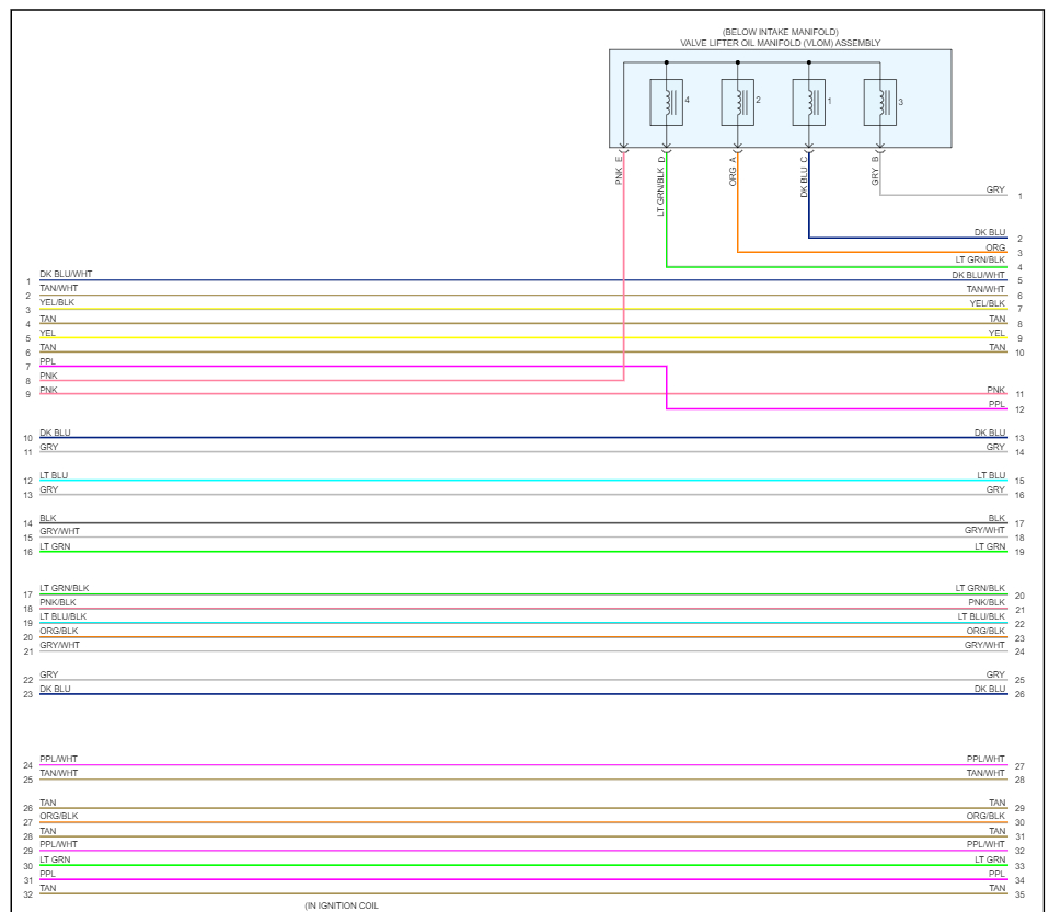

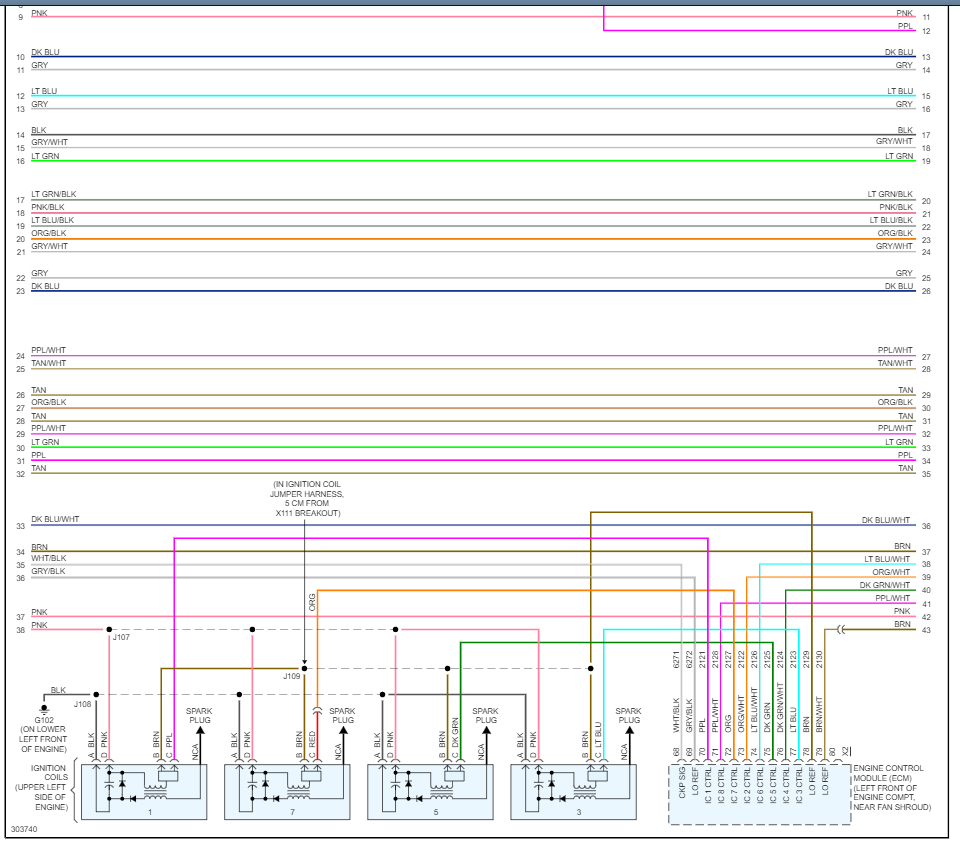

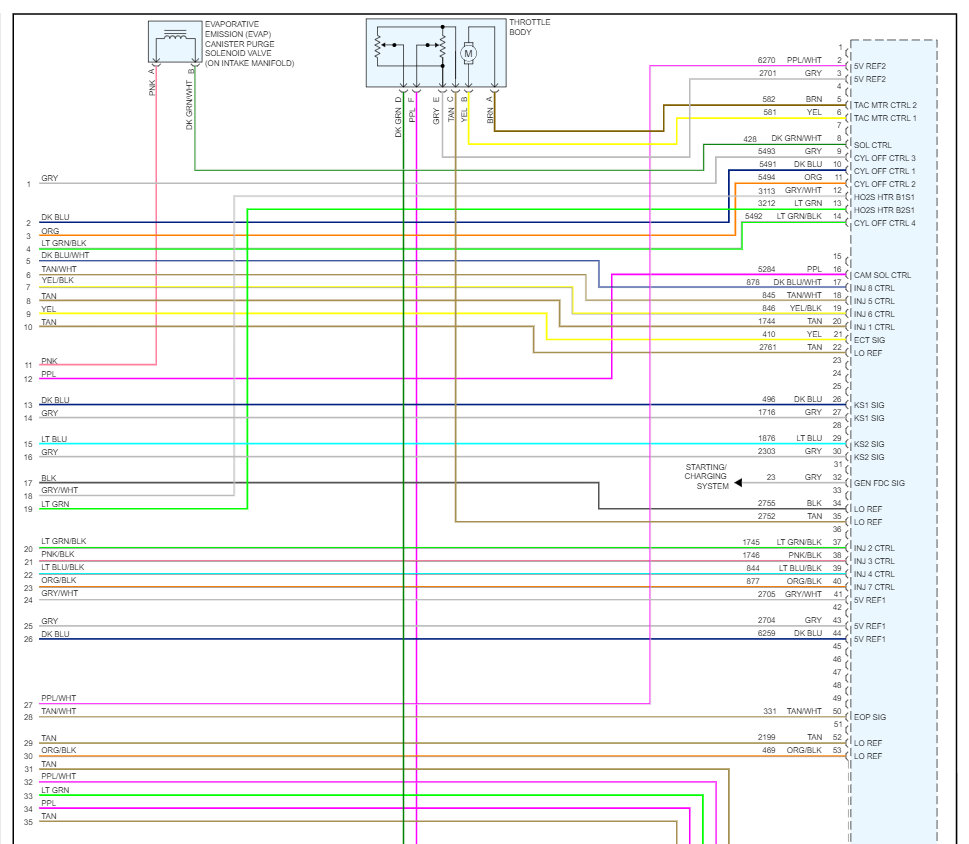

It sounds like it could be a wiring problem or a PCM injector or coil driver has gone out. Let's check to see if there is spark from the coil by following this video:
https://youtu.be/baq_aEWNQ0Y
If you have spark let's, check for injectors pulse which this guide will show you:
https://www.2carpros.com/articles/how-to-test-a-fuel-injector

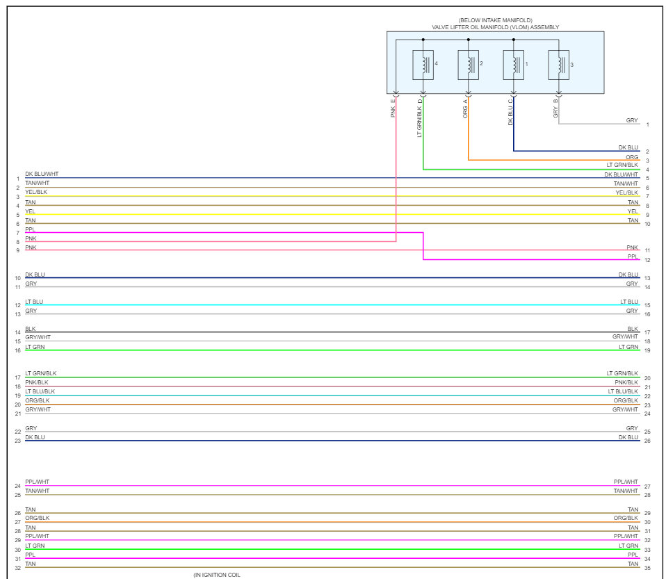

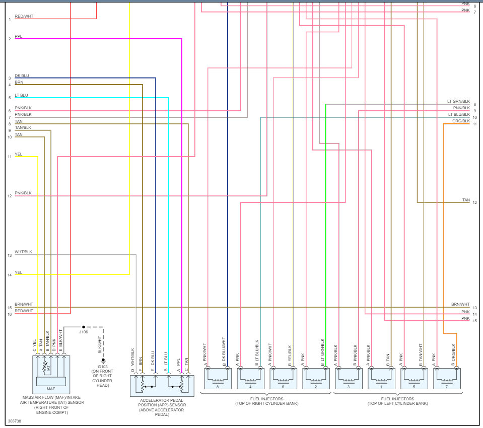

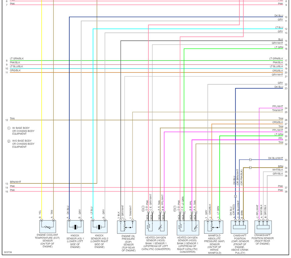

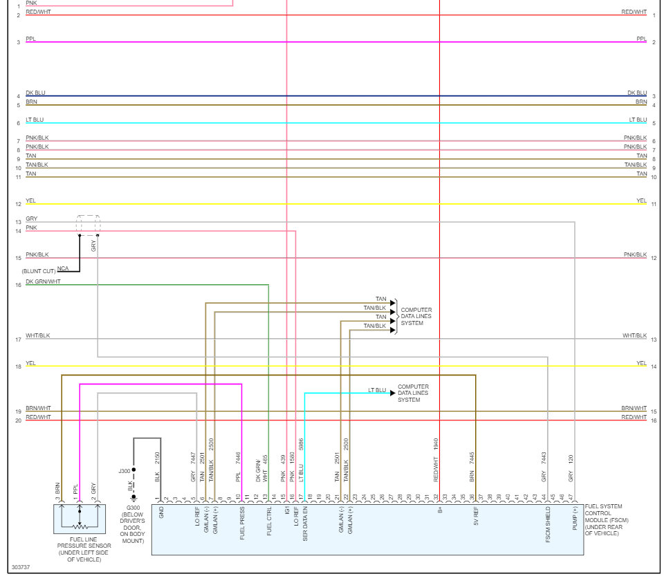

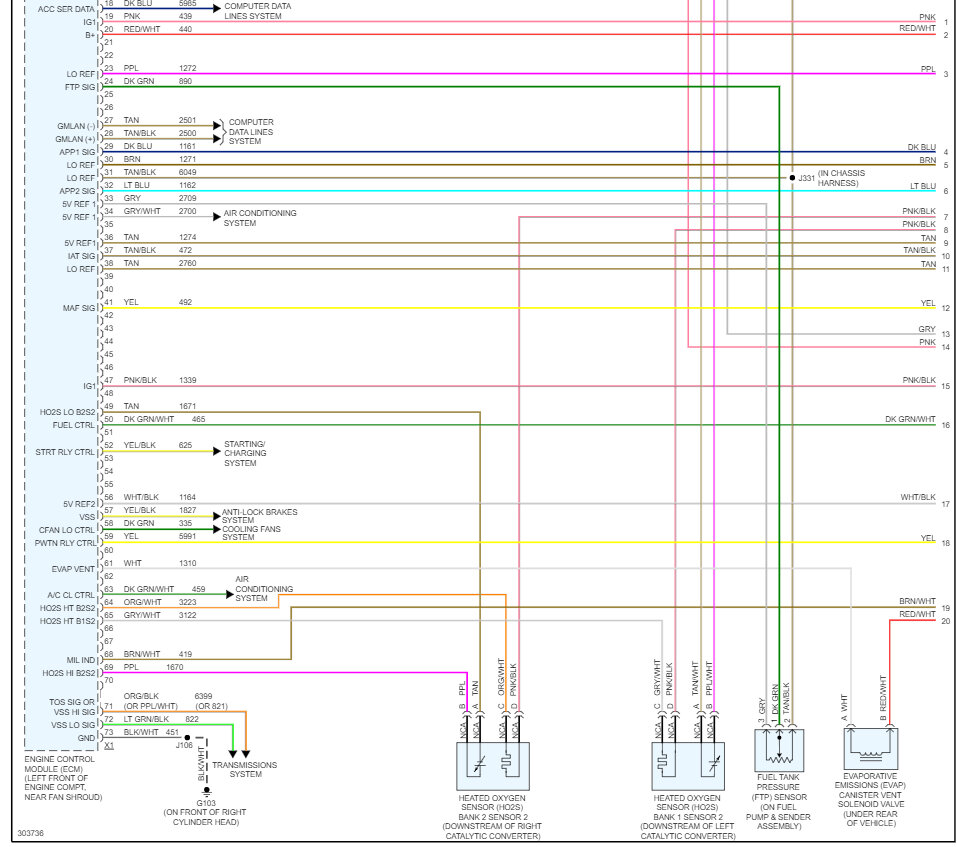

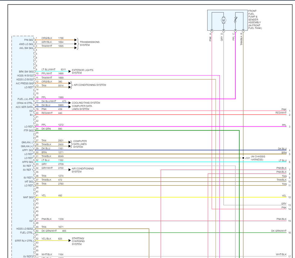

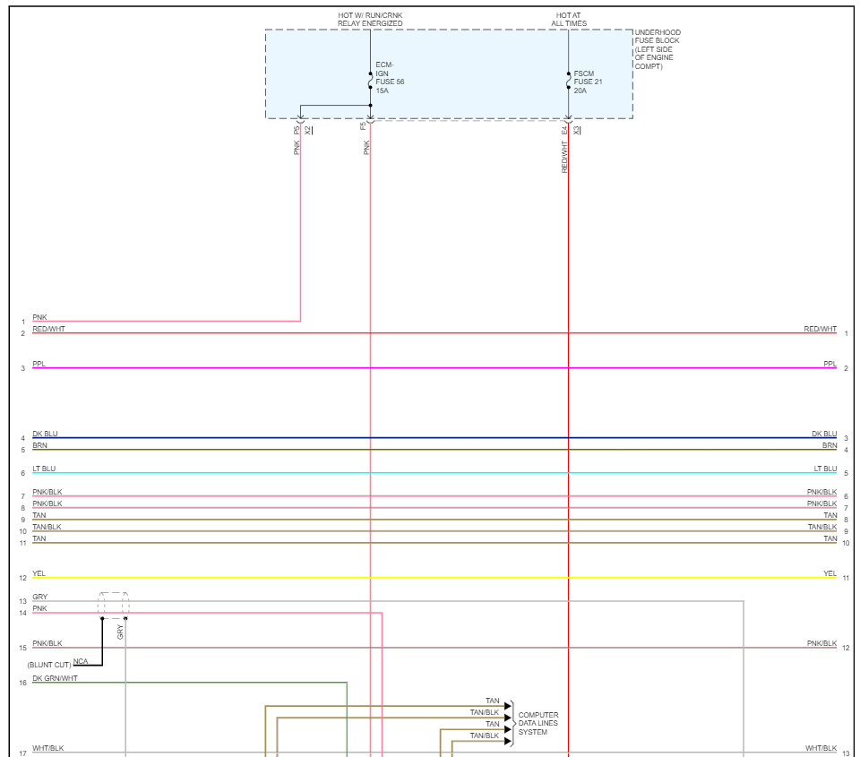

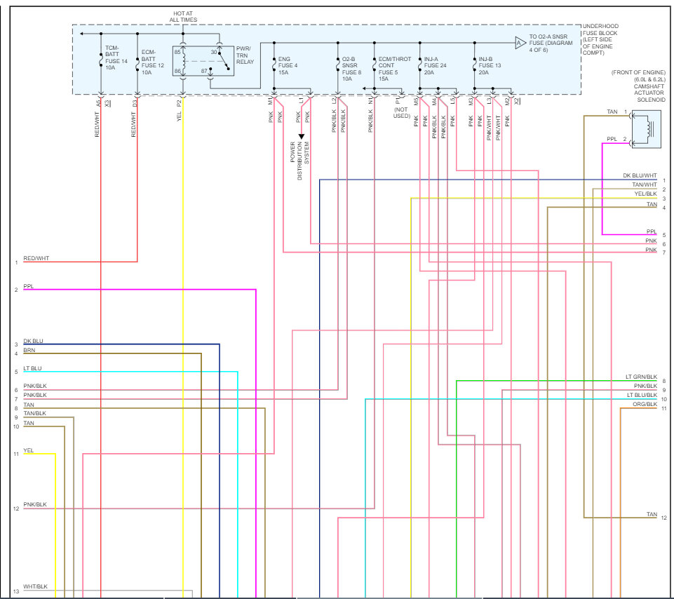

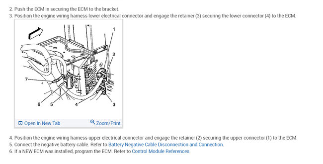

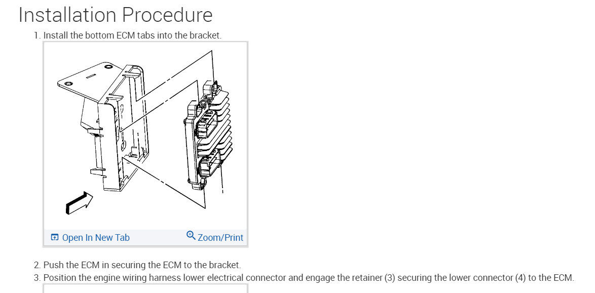

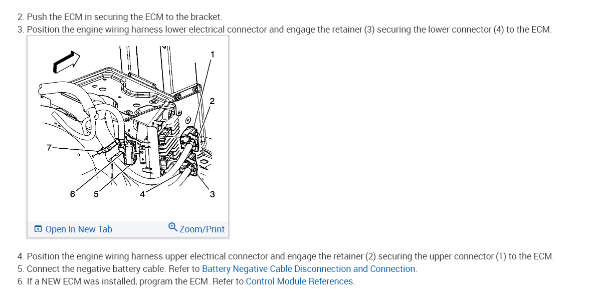

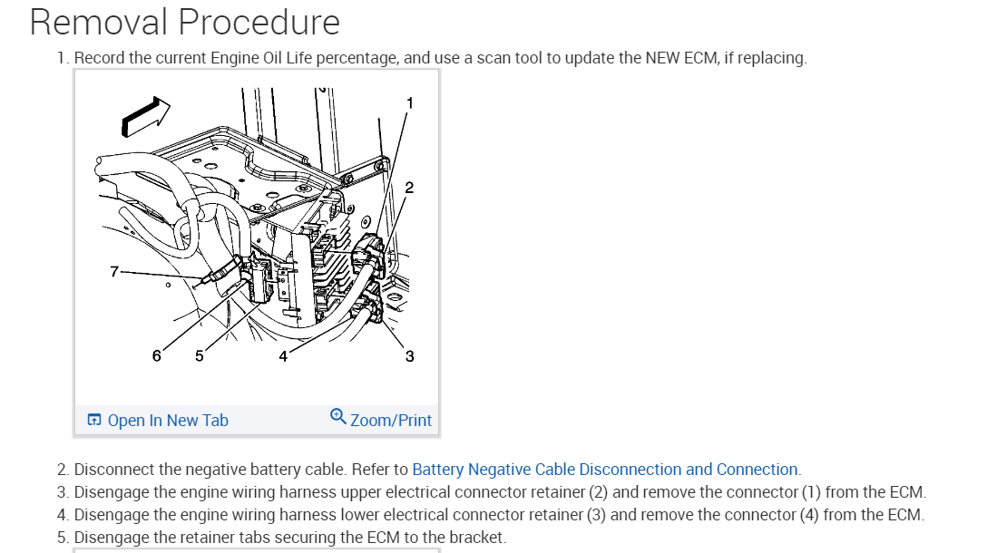

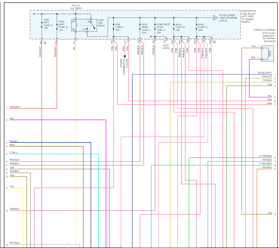

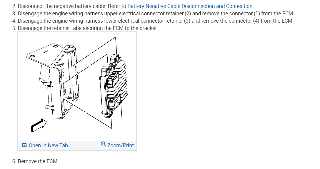

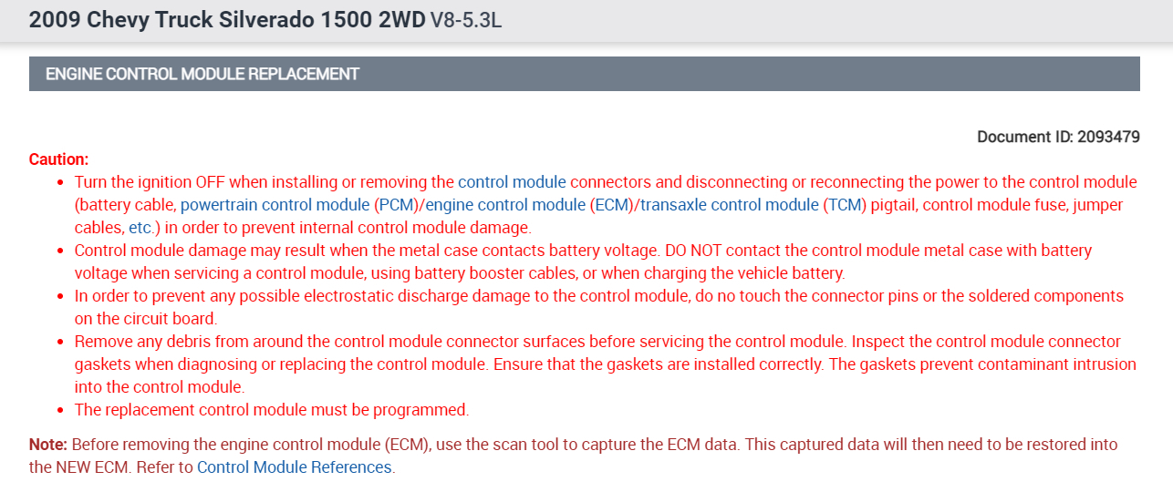

If you don't have pulse on either let's, check the connection to the PCM. This guide will help, and I have included the wiring diagrams below:
If the wiring is good and you still don't have spark or injector pulse the PCM is bad which you can find a rebuilt unit by searching google or eBay which will come preprogrammed. Check out the images (below). Let us know what happens and please upload pictures or videos of the problem so we can see what's going on.

Hello Ken,
Sorry it took a while for me to get back to you. We just put a Noid light on the connector going to the fuel injector. We have good flickering; we compared the light to the other good firing cylinders. They seem to have the same brightness and same rhythm. Wouldn’t this mean connection to the injector is good? Is the PCM good because it has a good signal going to connector? Do you think the lack of fuel going to the cylinder could be at the fuel rail? Just at the bottom where it goes into the injector? We didn’t have time to go over the wiring to the PCM yet but if you still recommend, I will get it done.
Apr 3, 2023 at 6:24 PM
  • 54,840 POSTS
If the Noid light is flashing it means the connection to the PCM and the PCM is good. The only other thing I can think of is you have a leaky intake valve in one of the cylinders that is affecting #4. I would replace the spark plug one more time, you may have gotten a bad plug and then clear the codes. How does it seem to run?
