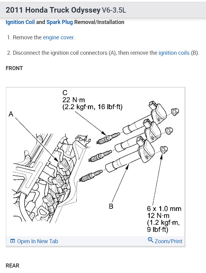

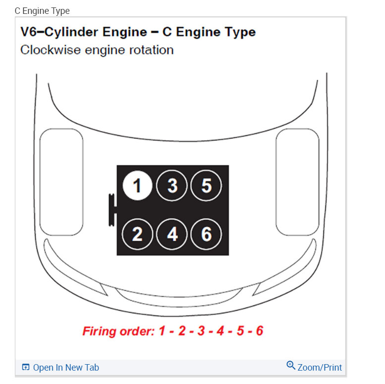

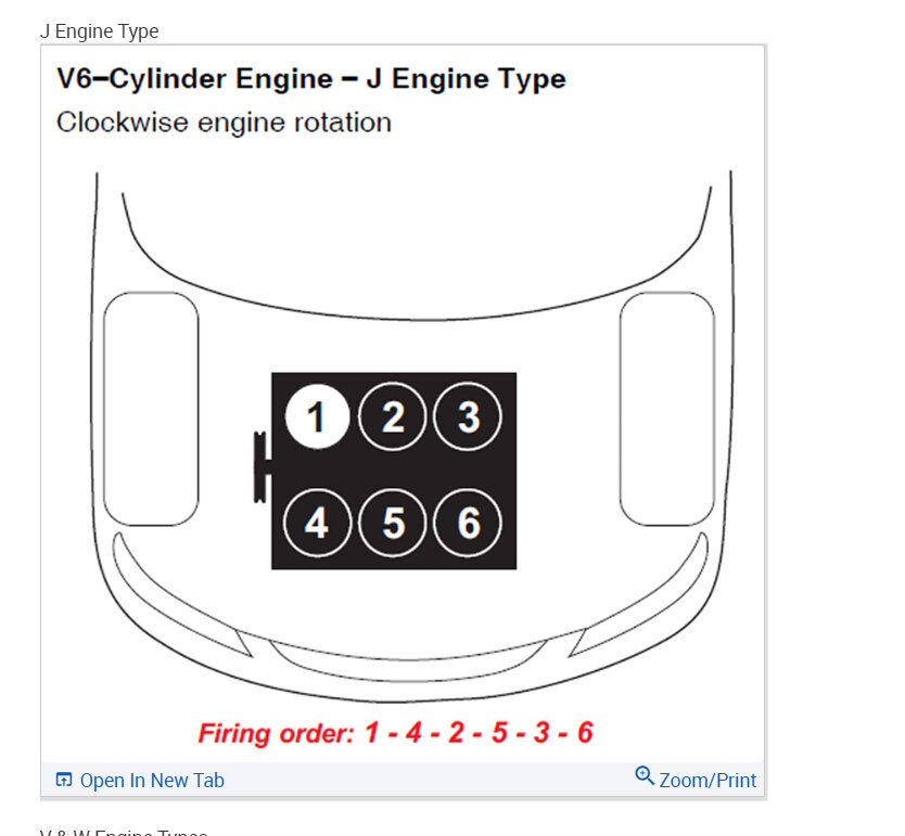

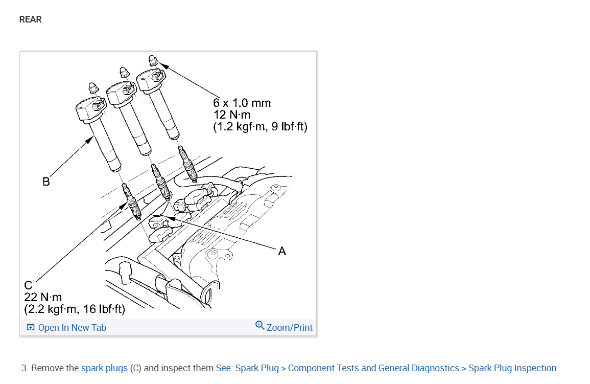

I would remove the #4 spark plug and check the porcelain housing for cracks, next I would replace the ignition coil which should fix the problem. here are the instructions so you can fix it yourself. Also, it should be known that a spark plug can be defective even though it looks okay. Here is the cylinder location as well.
This generic guide can help walk you through the steps:
https://www.2carpros.com/articles/how-to-change-spark-plugs
This guide can help as well:
