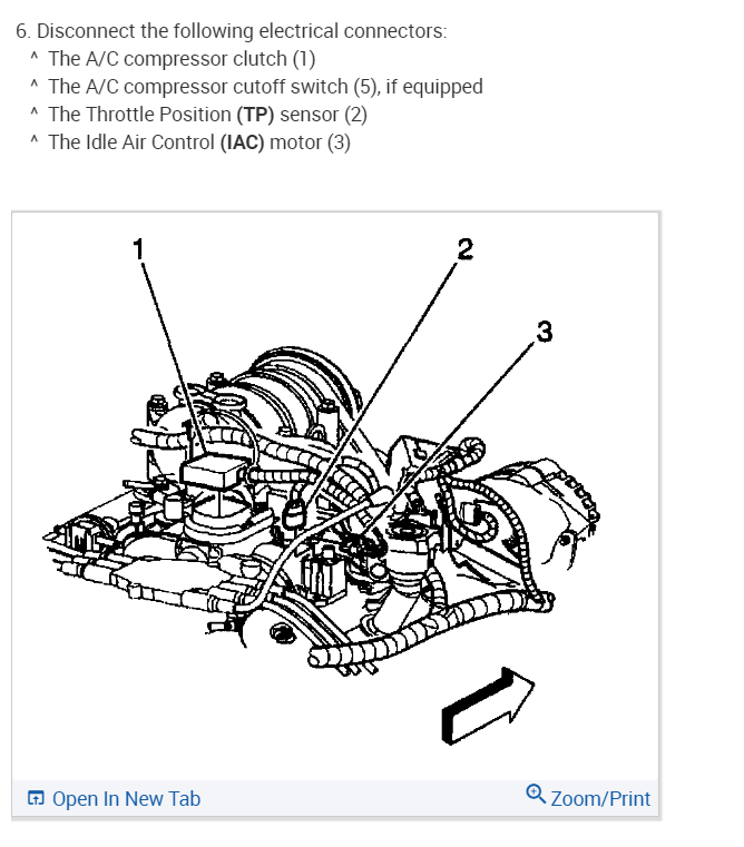

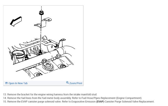

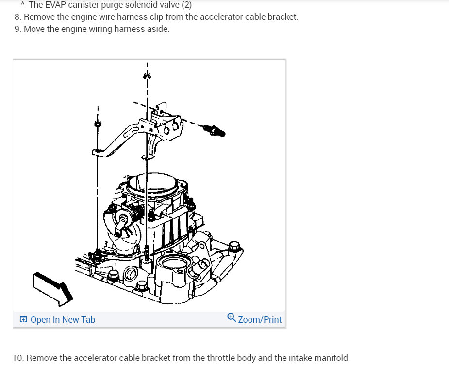

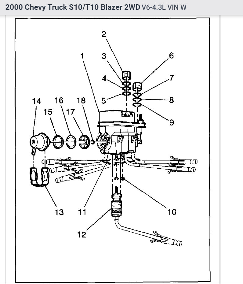

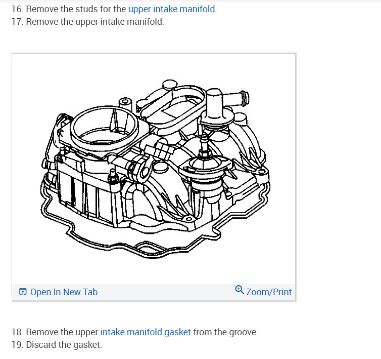

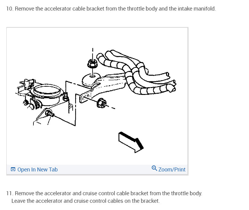

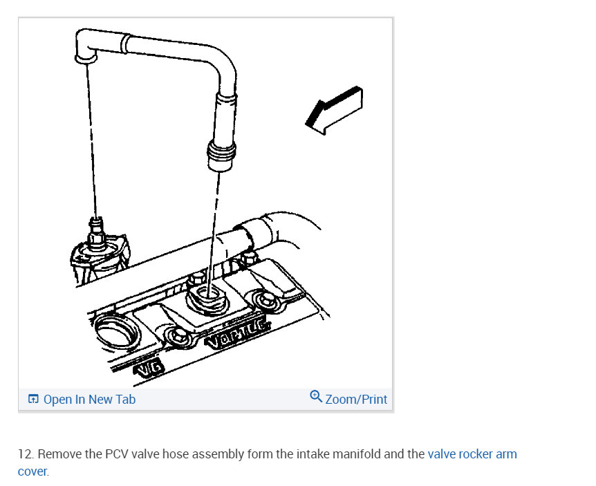

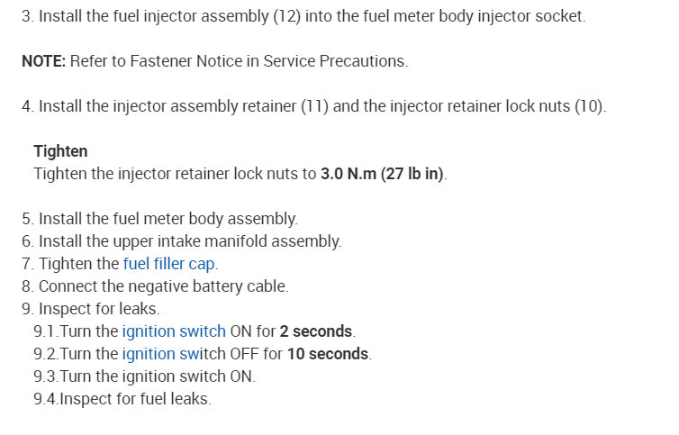

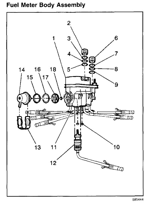

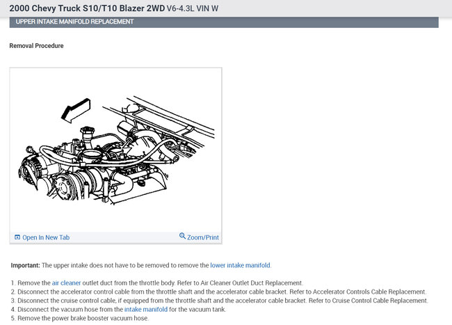

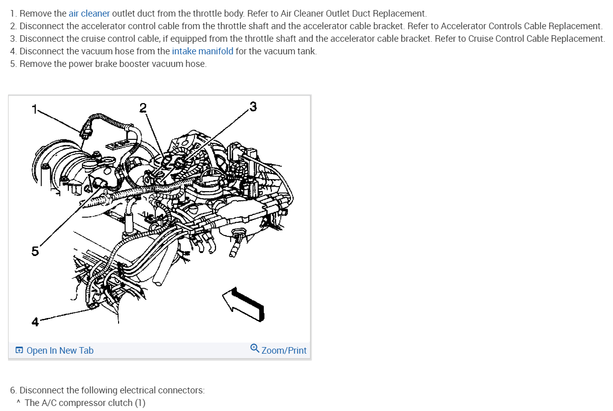

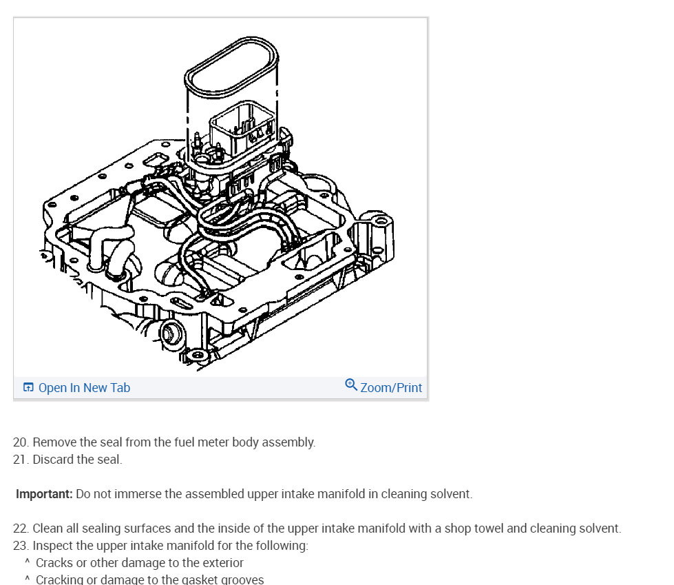

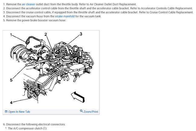

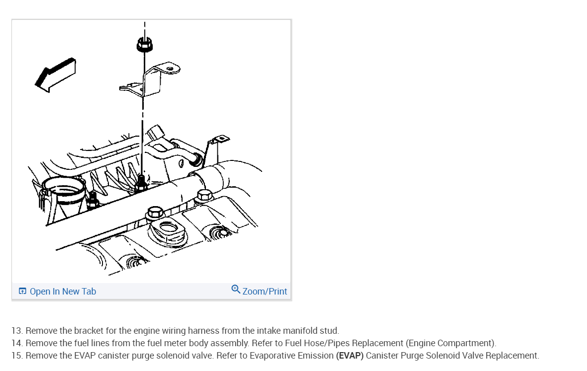

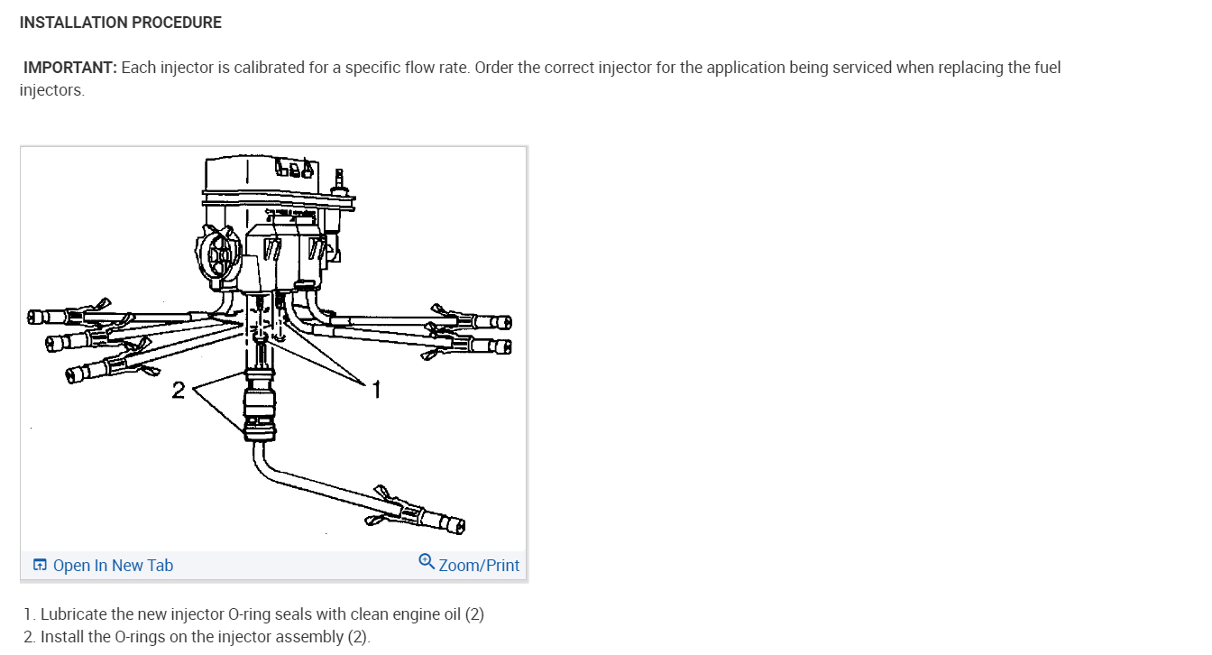

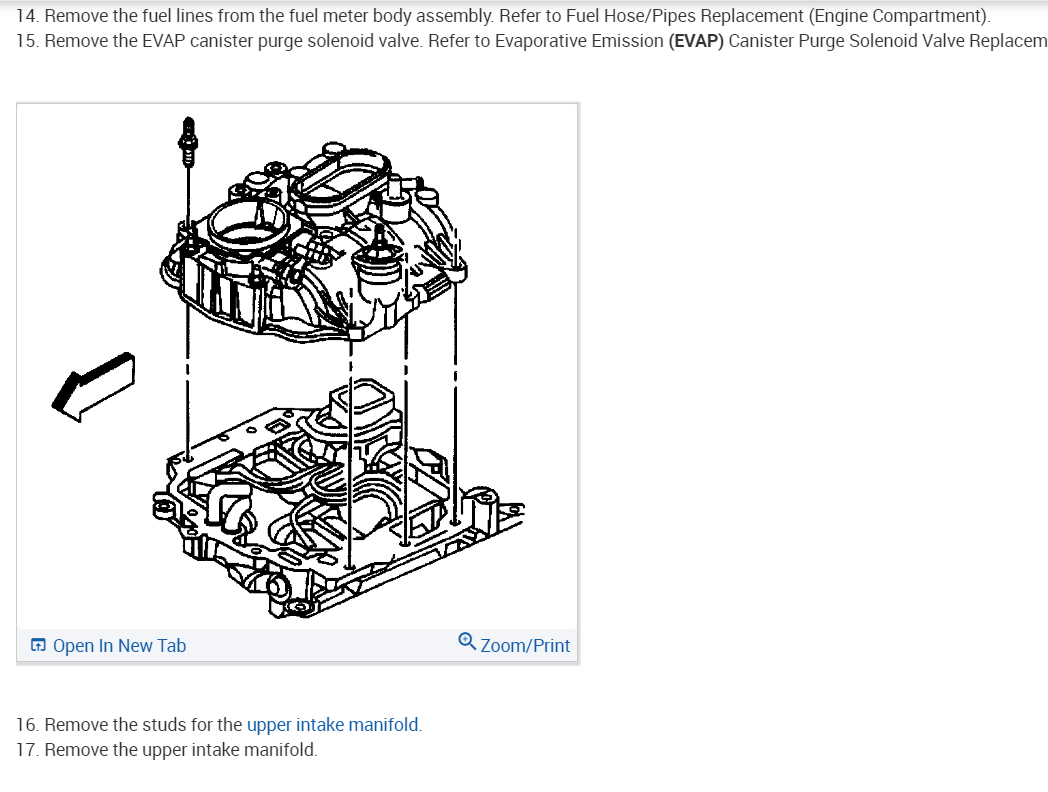

If the diaphragm inside the fuel pressure regulator is ruptured it can cause the p0300 code. Does the engine have low gas mileage? If so, this can be a sign the pressure regulator is bad. With this many miles i would do the spider injector as well because they had problems with them. Clear the codes once the repair is completed. Check out the images (below). Please let us know how it goes.
