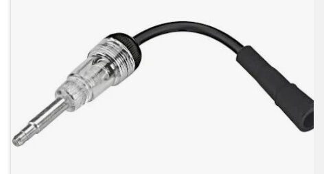

A random misfire is vague and sometimes difficult to resolve. You indicated running the engine at a high idle speed and it stalls. Does it start right back up or do you need to wait?
I ask because it could be a fuel or ignition issue. By any chance, do you have a test light for checking the ignition spark? (see pic below) If you do, connect it, and have a helper run the engine at high idle speed. Watch to see if the spark stops when the engine begins to stall.
Let me know. As far as the P0300, have you cleared it? If so, how long does it take to return?
It's odd that there are no misfires detected but you have this code. Is this the only code present?
